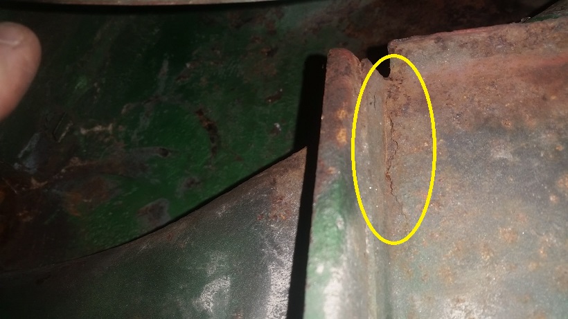

Needing more research :

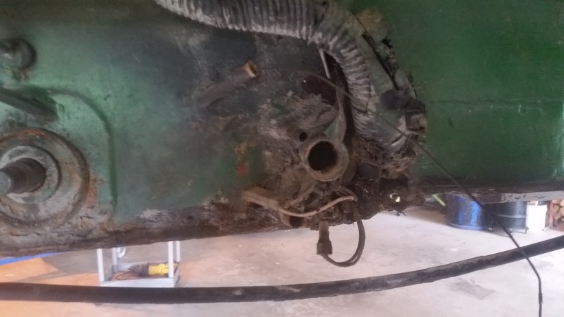

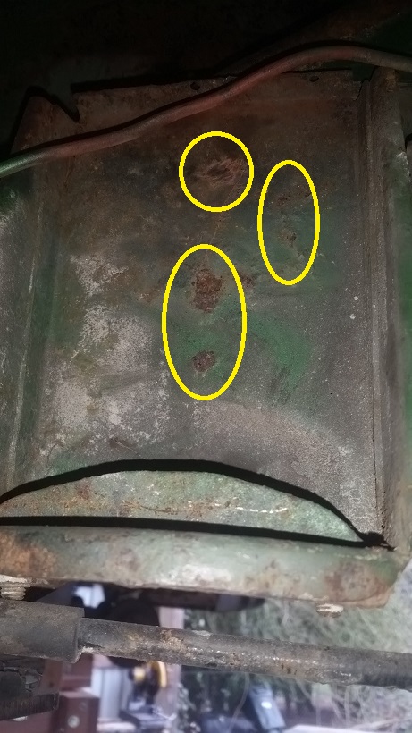

A few rust pits on the upper right outer wheelhouse long
But we also a have fairly good sized rust spot a little further up the upper long. Right next to the suspension console.
These are both in the double walled section of the upper long.

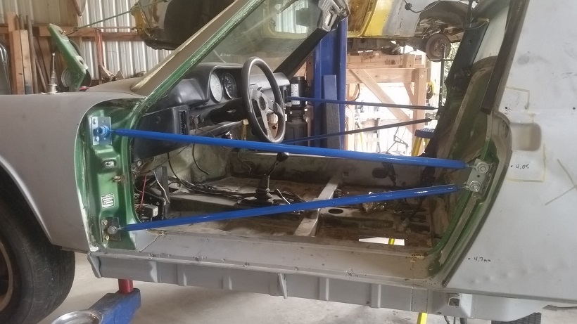

Started the day installing the door braces.

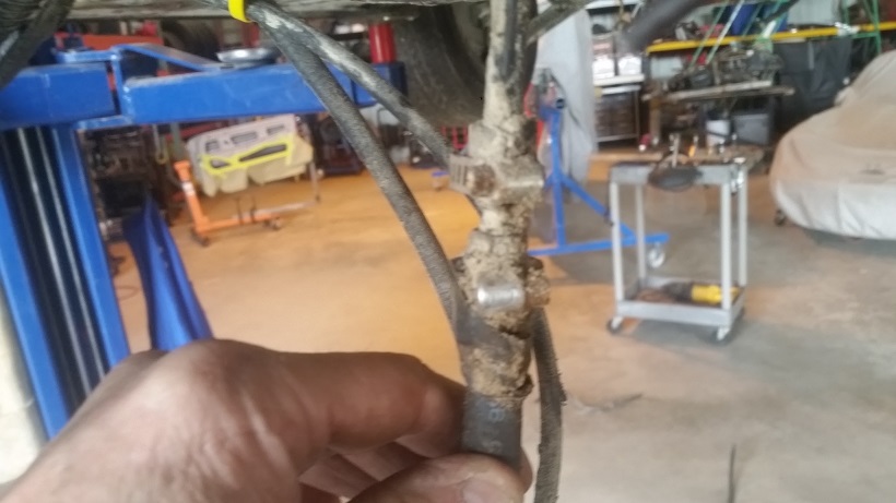

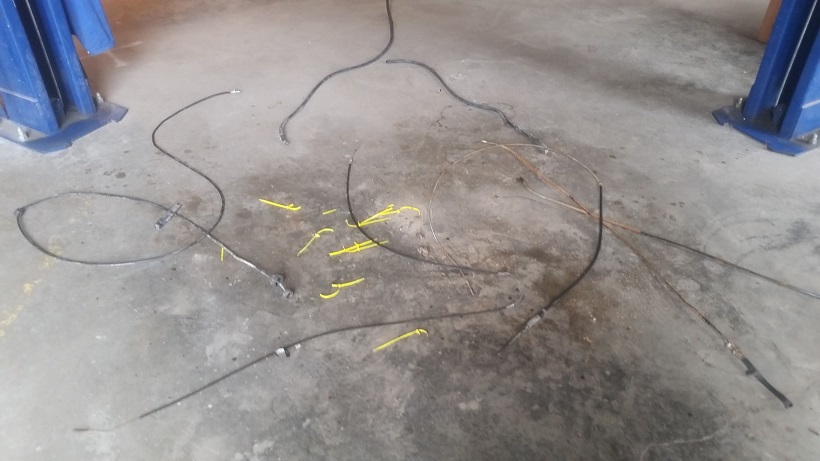

In order to give the firewall a good examination I need to remove the fuel lines and cables. So out came the fuel tank.
This is the scariest splice I've ever seen. This was inside the cockpit. (IMG:style_emoticons/default/sad.gif) This is why it had the hillbilly tared in mess.
After everything is cleared out of the way.
Aftermath ................

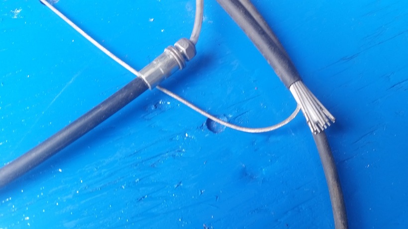

Speedometer cable looks good. Clutch cable looks good. Accelerator cable, not so much. Bowden tube separated.
