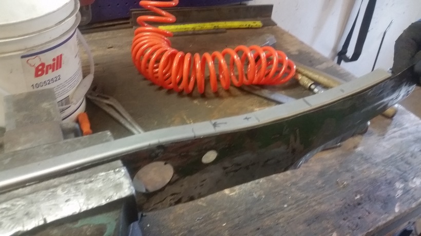

Here's Super In Law's work on the right engine shelf. He's created a new flange for the molding channel to be welded to.

cary   Here's Super In Law's work on the right en...   Mar 4 2016, 09:22 PM

cary   Super In Law finished up the engine shelf.   Mar 7 2016, 10:40 PM
