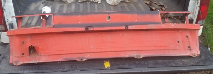

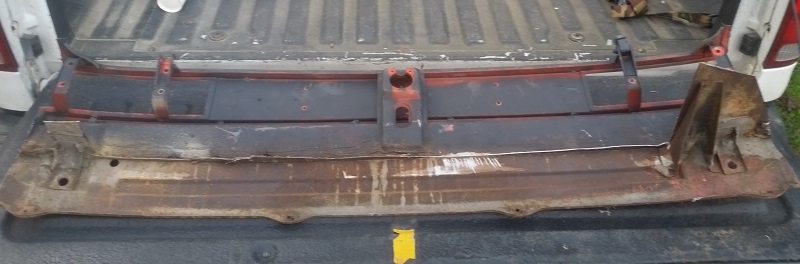

After lunch we went to Mike's (warpig) house to cut the rear panel out of his parts car.

cary   After lunch we went to Mike's (warpig) house t...   Mar 4 2016, 10:03 PM

cary   Mark's staying with the 75-76 bumpers. So we s...   Mar 5 2016, 04:51 PM
cary   Mark's staying with the 75-76 bumpers. So we ...   Mar 7 2016, 09:51 PM
