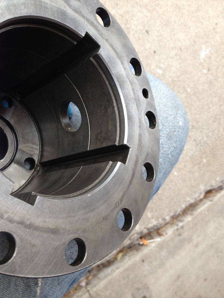

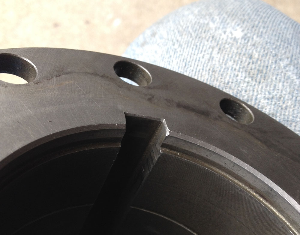

Where do these go wrong? Broken internals, severely wore parts and worn internal channels.
Here is a close up.

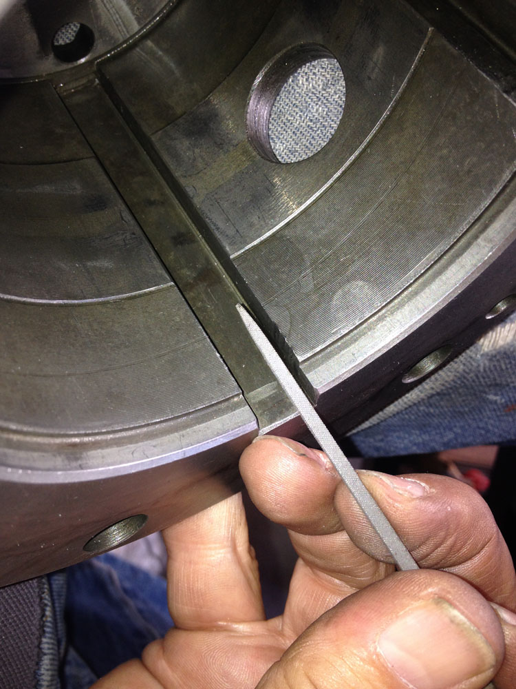

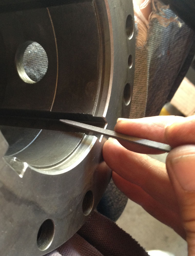

The ridges seen here need a bit of clean up with a small file
With no major problems time to proceed with figuring out a set up.
