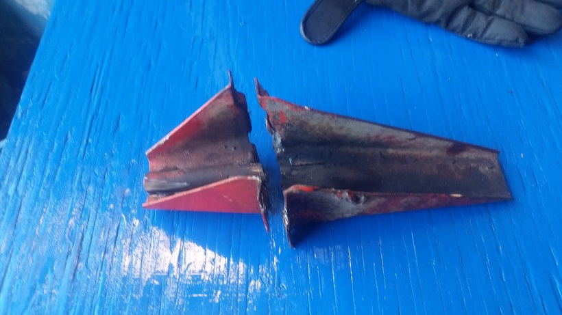

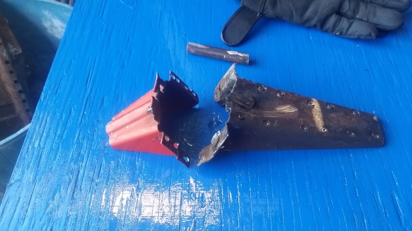

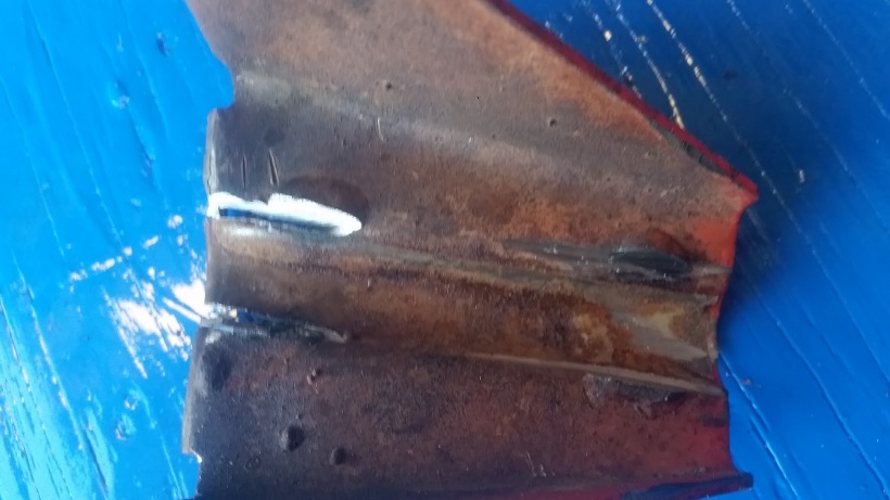

Ok. Tow hook is not meant to be removed and replaced. The tube had to be cut to get the tow hook off the pre 75 rear panel. You can't get the cutting wheel down into the locations were they welded in the tube. (IMG:style_emoticons/default/mad.gif)
If you can come up with a tube with 10mm threads you could put the two halves to good use. I can refurbish the two halves if your still interested. Fill in spot cutter holes. bead blast and prime.
