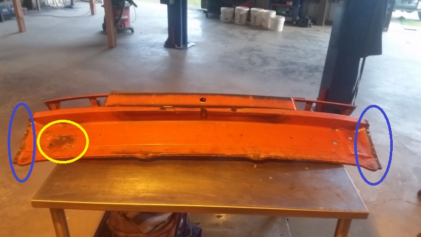

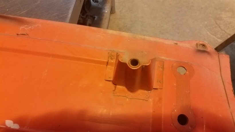

First ........... remove the tow hook. Not an easy task when trying not to damage the sheet metal underneath.
See post above for removed pieces

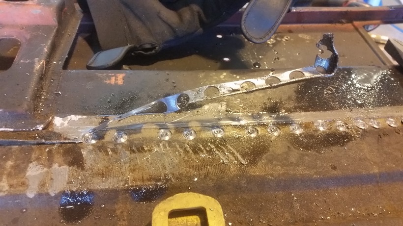

Next remove the spot welded flange of the rear trunk floor pan. Probably 50 spot welds.

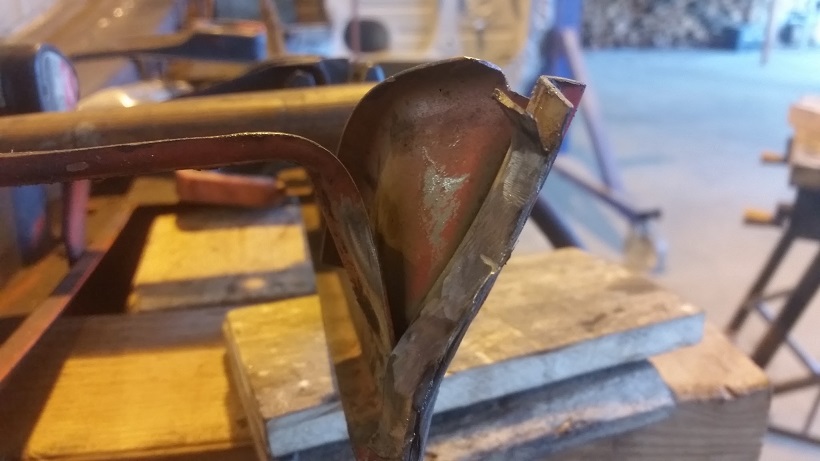

Next peel back the flange of the qtr. panel where it ties to the rear panel. Delicate work.
Used the Rick's method. Ground it down with die grinder them peeled it back with the small wood chisel.
Tow hook removed (yellow) and qtr. panel (blue) that came with the cut out removed.
Braces will still need to be removed.
And these braces will need to be transferred from the old rear panel.
