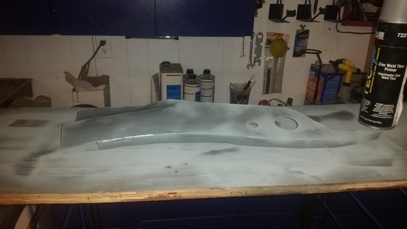

Super In Law finished up the engine shelf.

cary   Start the day with primering the refurbished piece...   Mar 3 2016, 11:54 PM

cary   Super In Law finished up the engine shelf.   Mar 7 2016, 10:40 PM
