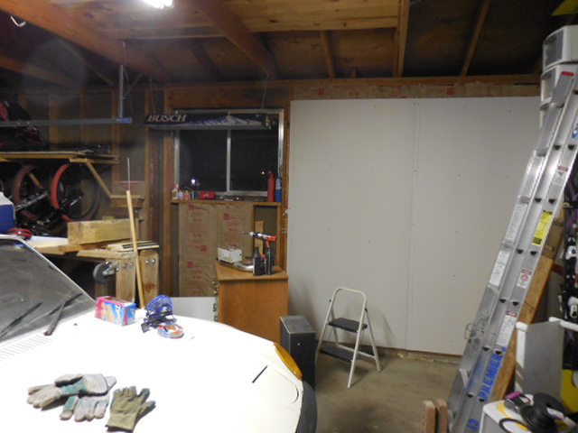

Last, i saw a real garage for the first time in my life. Sad to say but it has taken 31 years to appreciate a well laid out and finely tuned man workshop. I wont go into specifics on this one, but suffice to say my dad was more into the outdoors than in, so I hadn't spent much time in a garage until I was blessed with a 914.
Thanks to user "grantjd" (IMG:style_emoticons/default/beerchug.gif) who motivated me to spend some time on my workshop to make it more comfortable while I'm out there. So, put up insulation on Sunday and started in on drywall tonight. Really looking good and am excited to get this cave finally in order.
Alright not much progress has been made on the Porsche but figured i would give a shop update.
