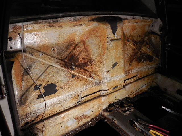

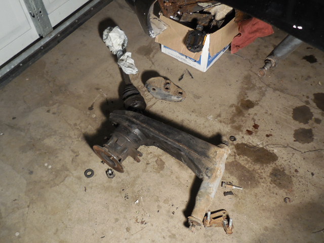

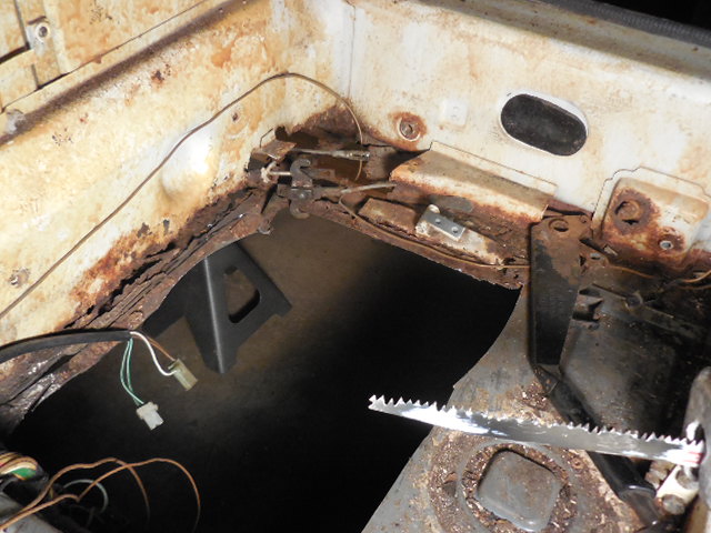

Step 1 (Complete) was to remove the engine and assess the frame rust situation. Never having removed an engine from a car, this was an extremely daunting task. The steps listed in Pelican Parts tutorial - 914 Engine Removal Made Easy is by far the most difficult thing I have done to a vehicle thus far. Hell I don't even know the difference between a camshaft and a carburetor much less a CV joint or a clutch cable. But after staring at it for about 2 weeks, I decided to just start unhooking shit and labeling. Made a ton of progress and finally got the engine about 95% unhooked. Had a friend come over to help me out and we actually got it out. WOOHOO!!!
Step 2 (Complete) is to strip out all the interior. I ordered chassis braces and other misc items from Tangerine racing and am still in the process of identifying all the rust areas that need repair.

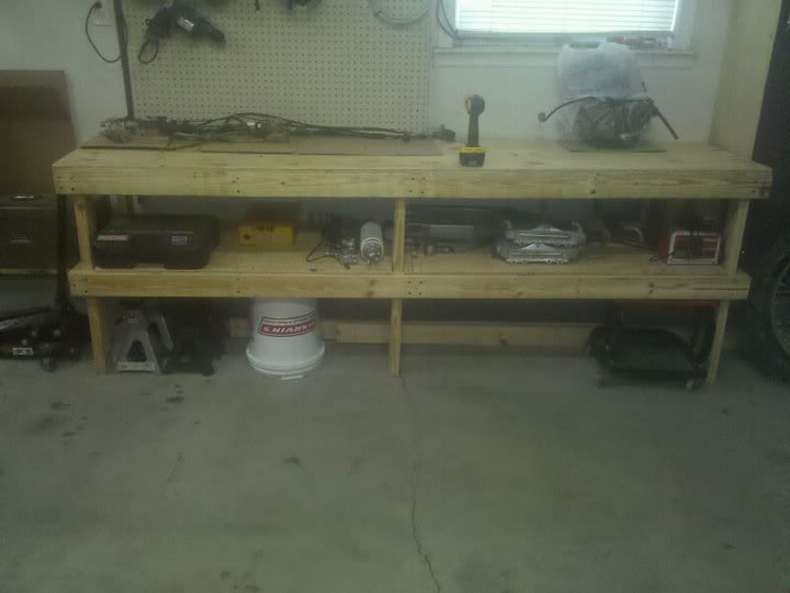

Tonight RNellums swung by and helped me identify some next steps. I took a break from cleaning and fixing up the garage to remove the rear right trailing arm and also got the original back pad off. Fortunately everything looked pretty decent on the trailing arm and the back metal, except by the e-brake. But that was to be expected.
Back at the garage this week and hoping to make a workbench like this one.
My plan is to use reclaimed 2x4's from the previous owners workbench. You cant see too much of it but it is in the left corner.
The previous homeowner was one hell of a woodworker so i would have expected a little more, but maybe he took the other workbench with him.
