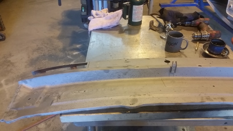

Start the day with a break in the rain so I make an attempt to bead blast the rear panel.
Only got the outside completed before the rain came and stayed all day. (IMG:style_emoticons/default/sad.gif)

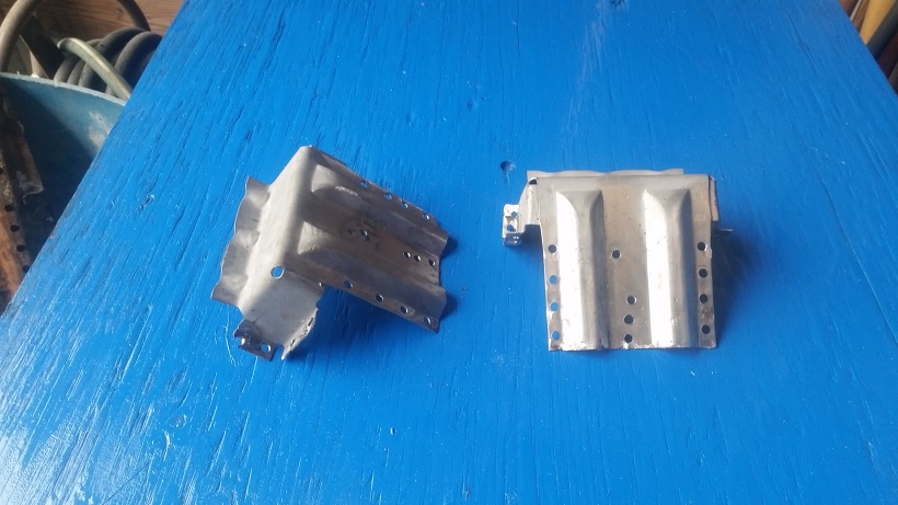

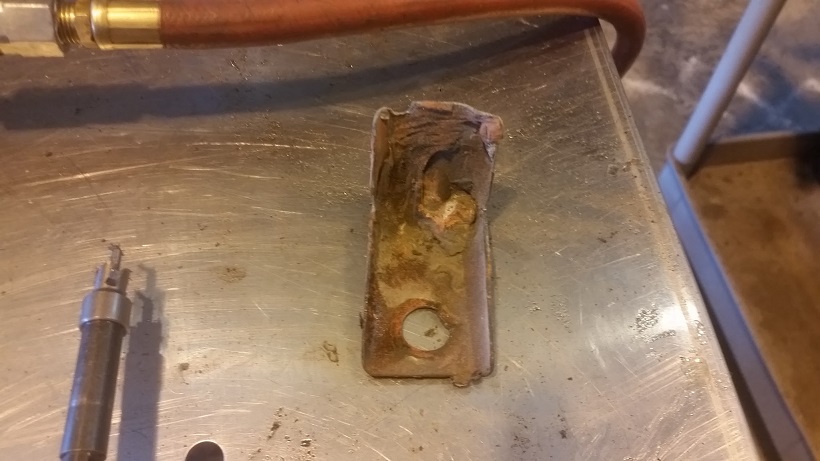

Get my six shooters ready for spot weld drilling ..............
Off comes the braces.

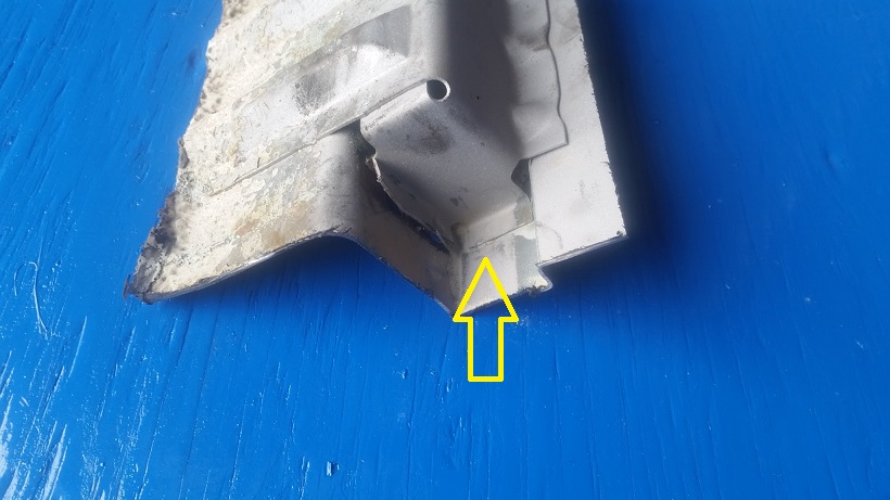

Then I cut the larger braces off the old 75-76 rear panel.

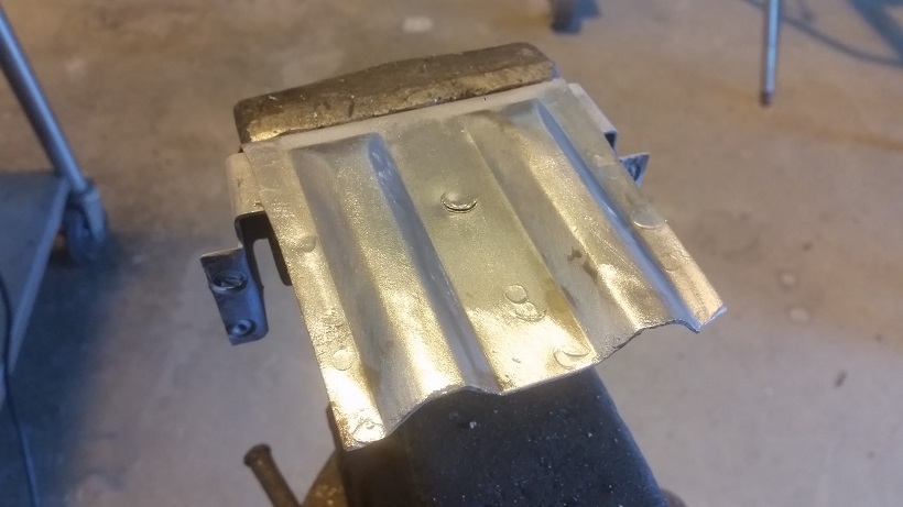

They have to be cut out because you can't get a pry tool into the area called out with the yellow arrow.
Now you can get at all the flanges when it's in the vice.
Now all prepped with rosette holes and ready for installation. But it will get a spray down with OSPHO and dry over night.
