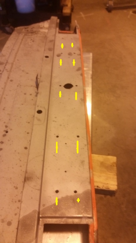

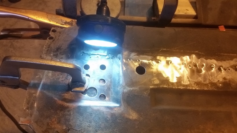

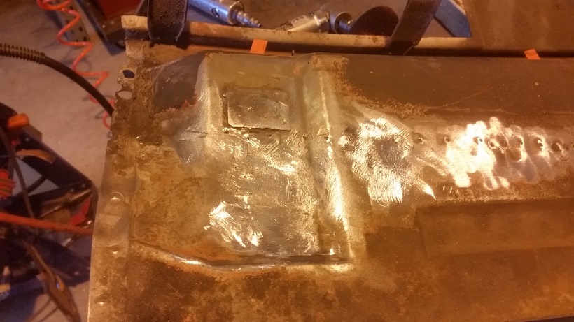

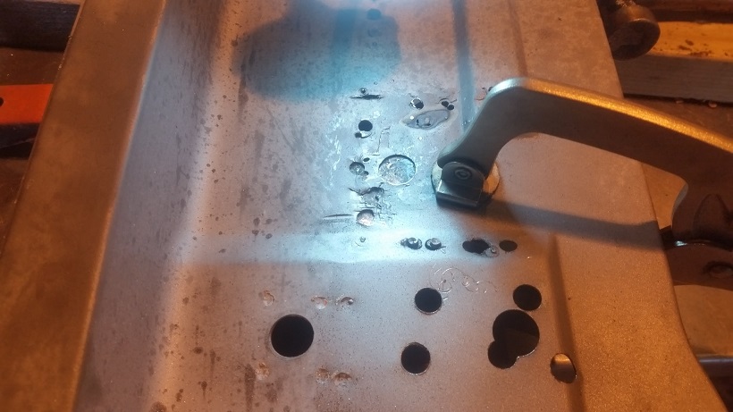

Now on to filling the holes on the early rear panel we're converting to a 75-76 rear panel.
Dog bone and brace holes filled and ground down.
After bead blasting I find that this rear panel has had a rear PORSCHE refelector at one time. It had quite a bit of filler.

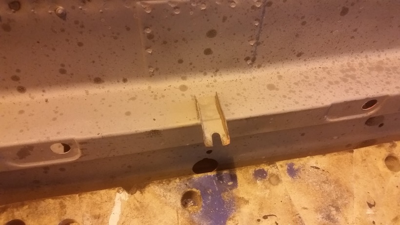

Early bumper hanger has to be removed.
On to filling the left side. Dog bone, brace and toe hook.
