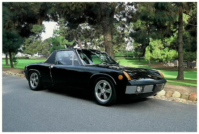

Senior Member ![]() ![]() ![]() Group: Members Posts: 829 Joined: 5-August 04 Member No.: 2,461 |
I like the PPG Delstar, doesn't need a clear coat. Color sands and buffs out real nice. Also, real easy to touch up the paint chips you get from all the uncovered dirt trucks running on the freeways.
I use a 2 part epoxy primer, then shot a tack coat of PPG, then a couple of full coats, or until I run out of paint. Once you add the hardener, gotta shoot it. When I did my 6, I did one panel at a time, took 3 1/2 months, but then black is a bitch to shoot, panels have to be perfect. Attached image(s)
