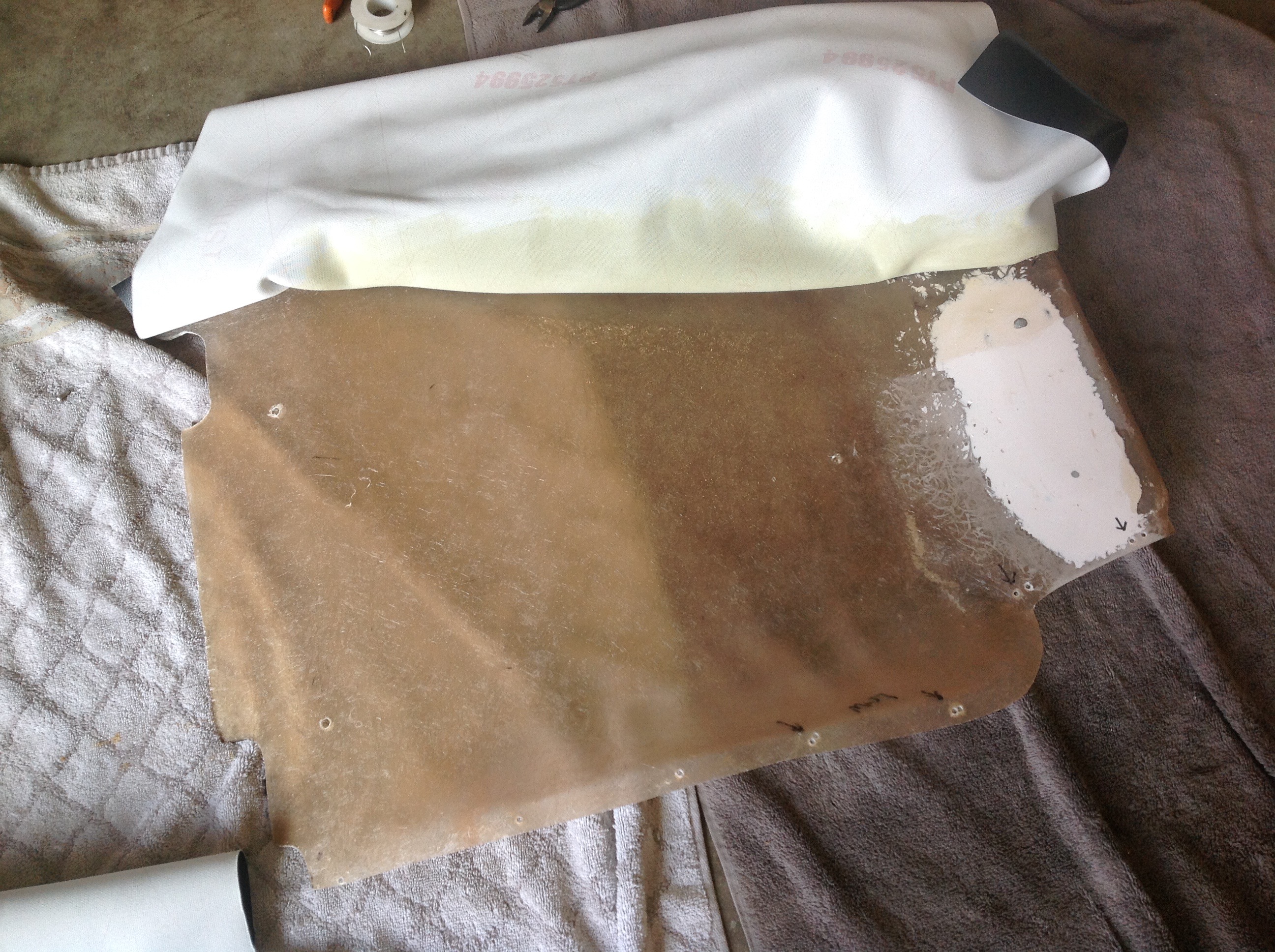

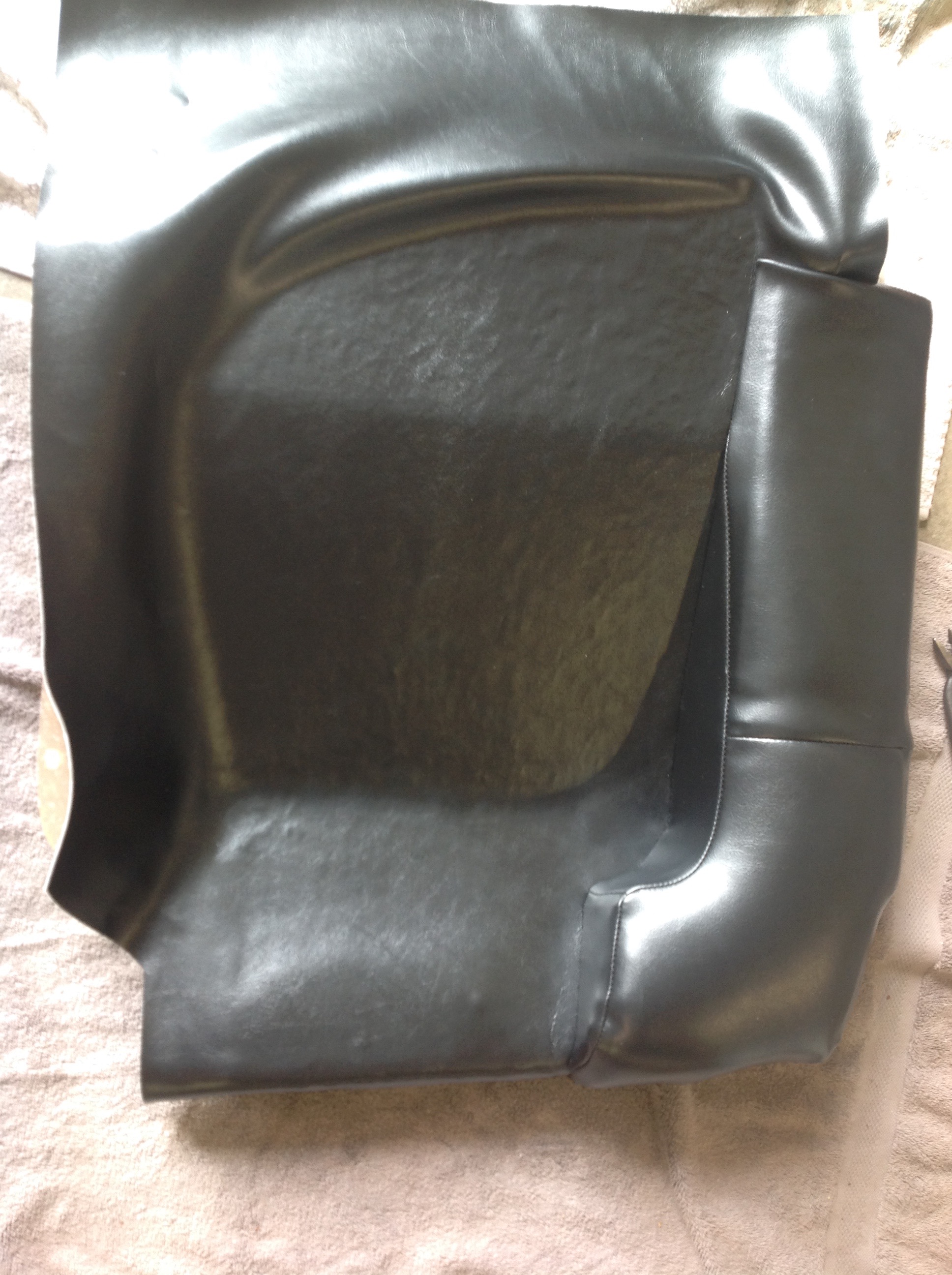

And then (said in an Asian voice from "Dude, where's my car"):
We move on to gluing down the field. Note the texture of the fiberglass that translates to the vinyl back pad behind the seats. This was an unknown when I started the project. The smooth side of the fiberglass support pieces is on the back, not the front. While this probably provides more adhesion for the vinyl, some may not like the aesthetic of the blown in fiberglass. Of course, next time I could spend another few hours with a DA sander smoothing everything out.... Attached thumbnail(s) |
