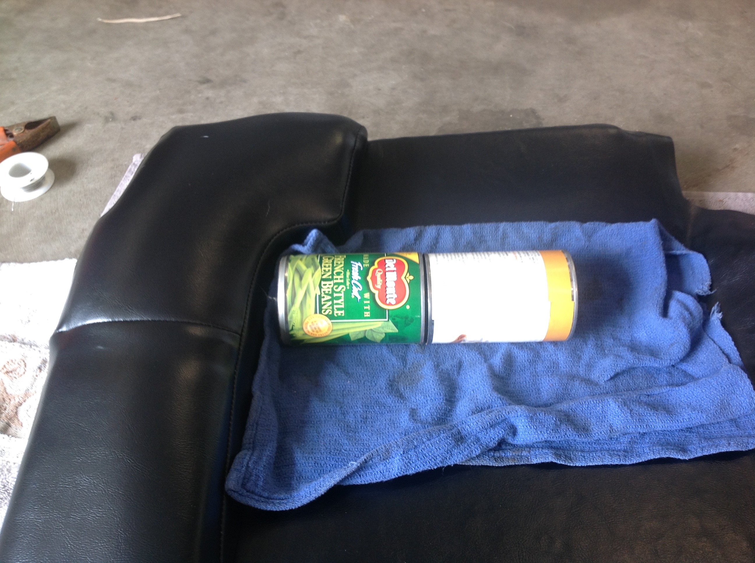

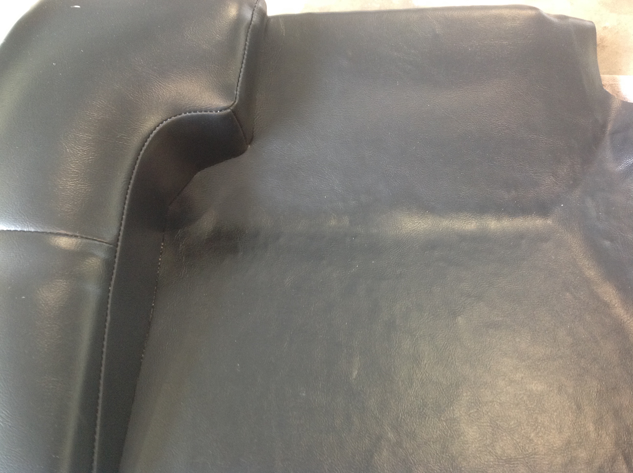

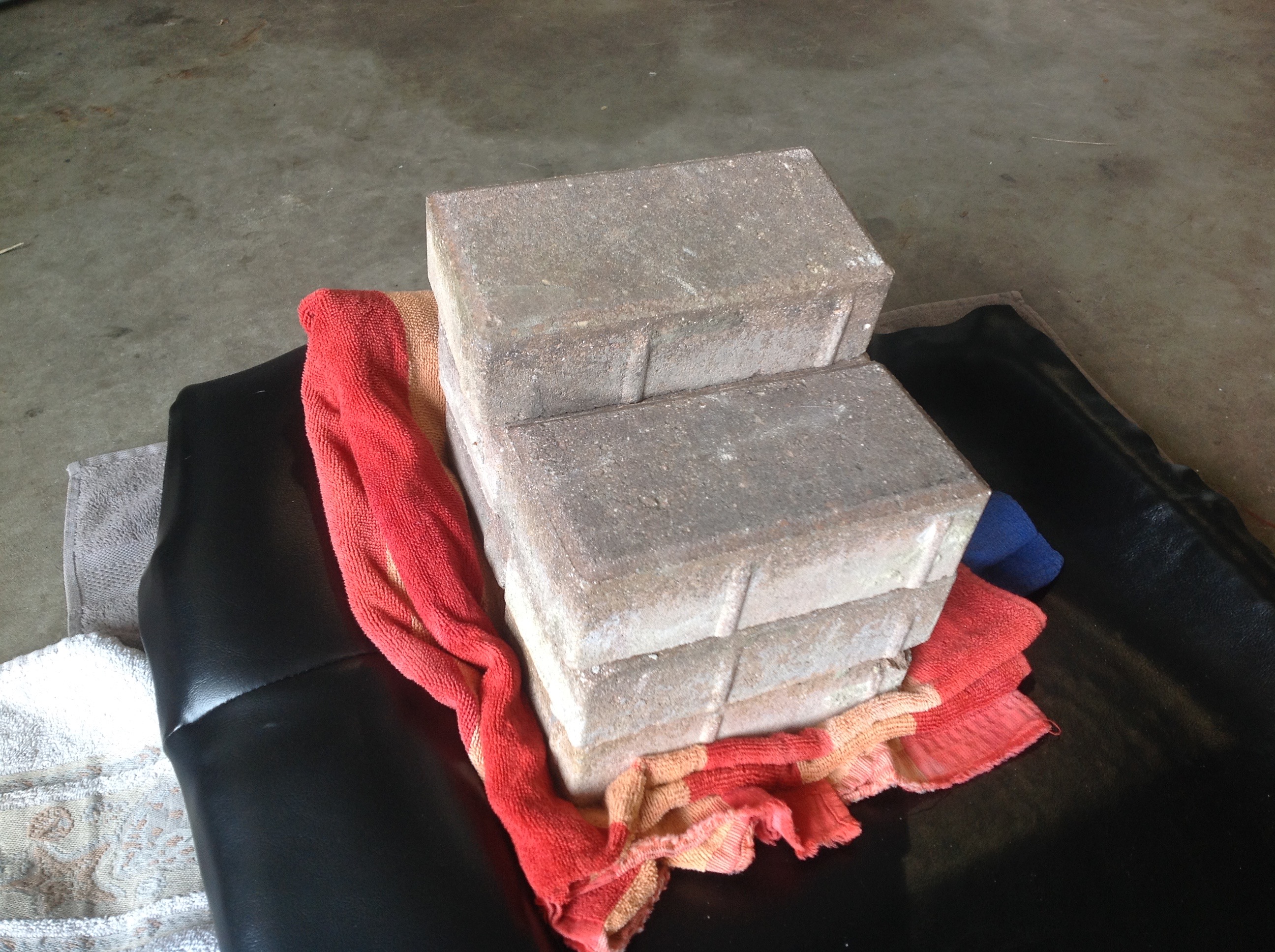

Remember (again) when we talked about contact cement and adhesion?
Here are pictures of the field on the passenger backer.
The vinyl has to be pushed into the backer and that causes tension. Well, it didn't want to stay, so, leave for 24hrs...
