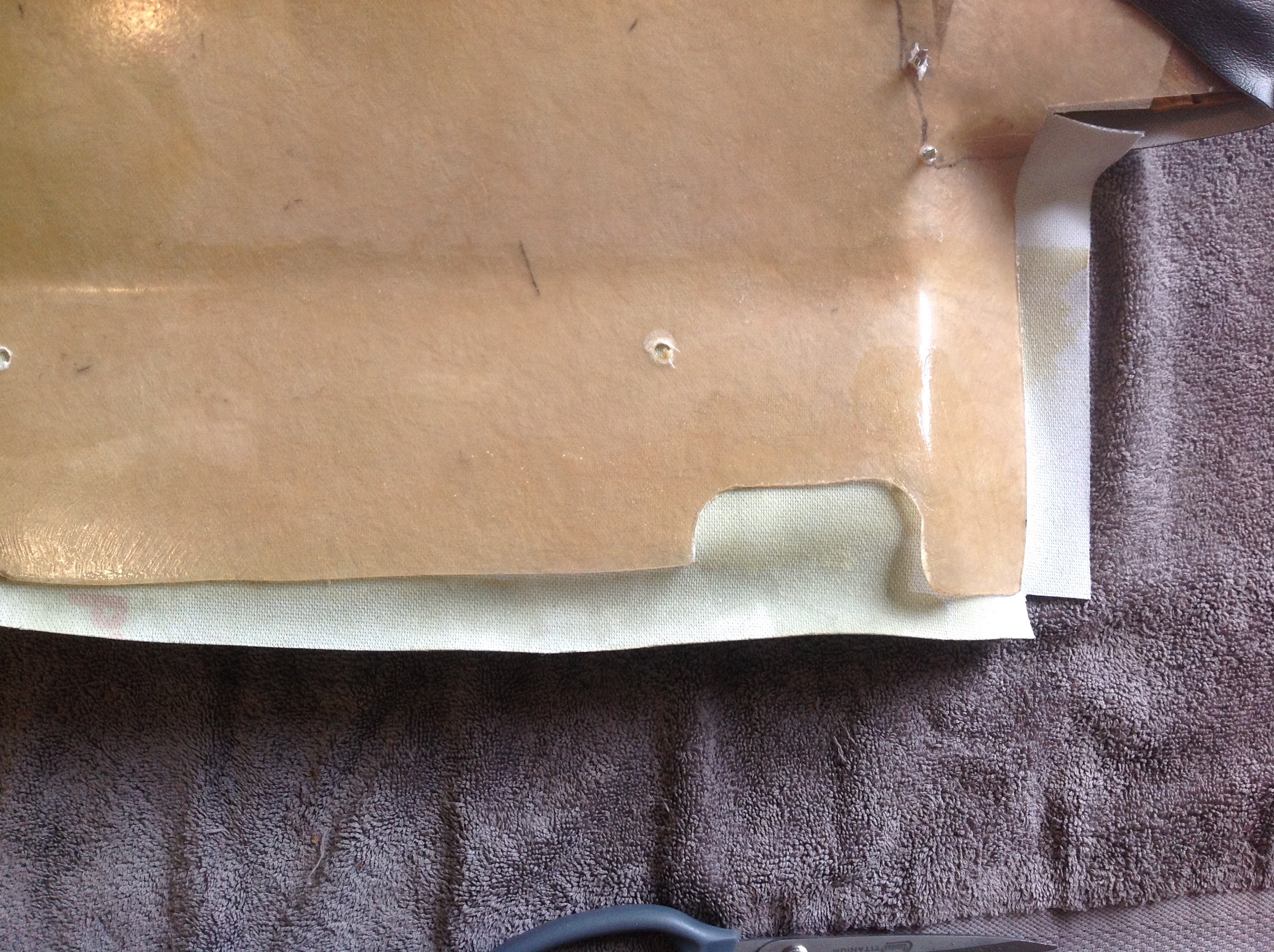

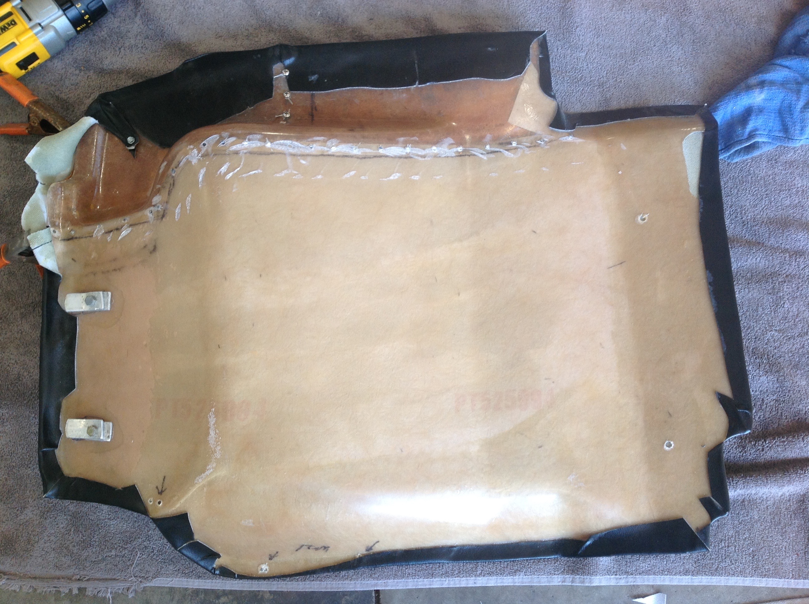

The next four finish up the passenger side.
Note the cut-out for the parking brake on the passenger side does not apply and the screws for the tension strip have been cut off.
Be very carful when cutting the screw remnants. They are very hot and will go right through vinyl, if you let one get away to the front side.
