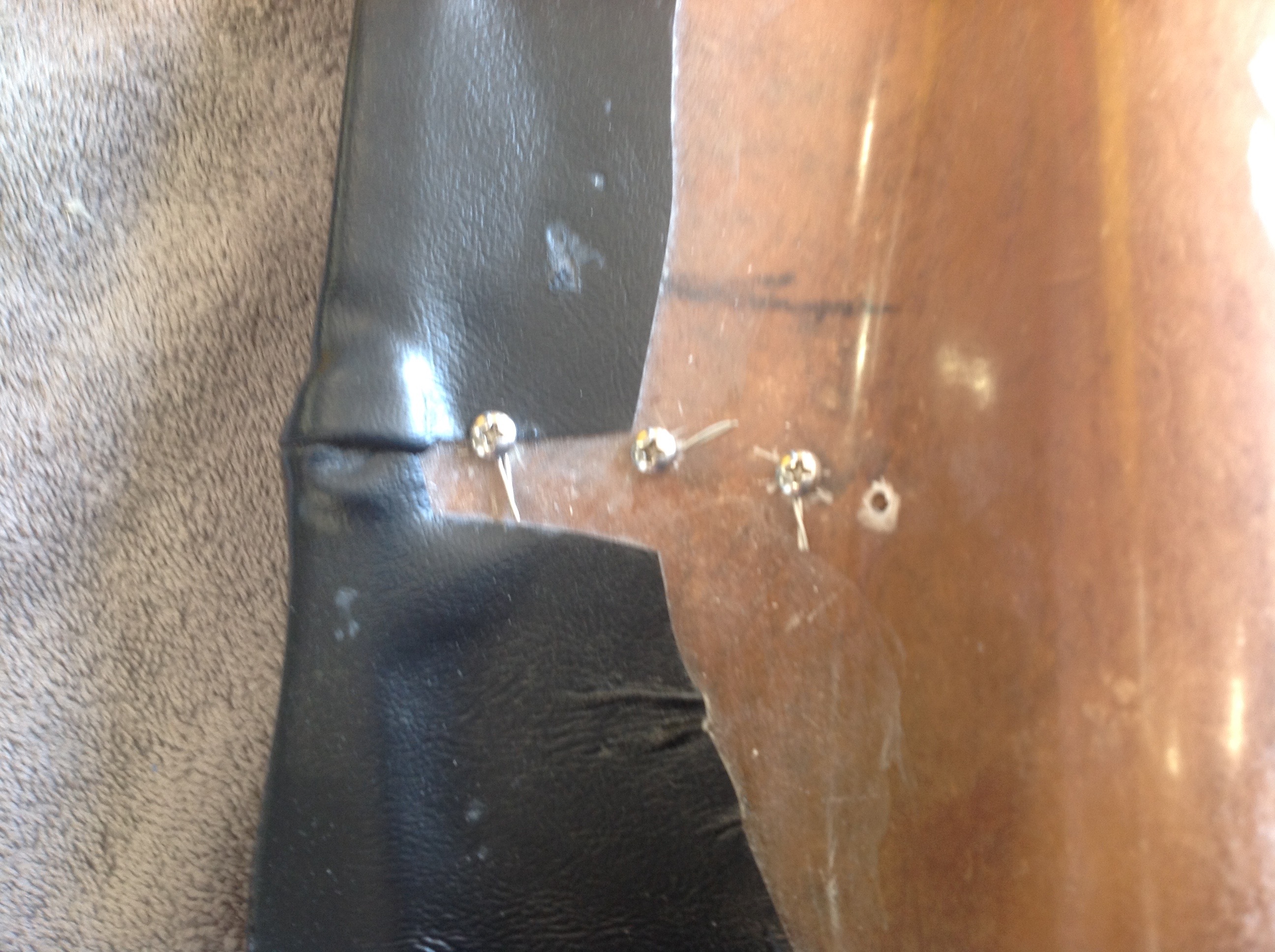

Remember the pulls on the median seam on the outside bolsters?
I finished it like this. Those pulls only require a VERY SMALL AMOUNT OF TENSION.
Pull lightly and bend the safety wire over. It'll hold there. Then, I found some screws to put in the holes that will hold the wire (again, under very light tension).

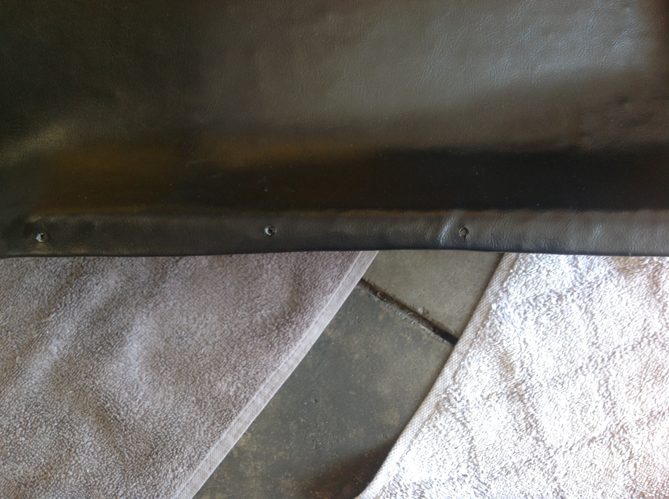

Then, get out the soldering iron (or similar) again and punch the holes where this part will screw to the mid section. Be very careful! A slip up at this point will cause a phone call to Oregon!
