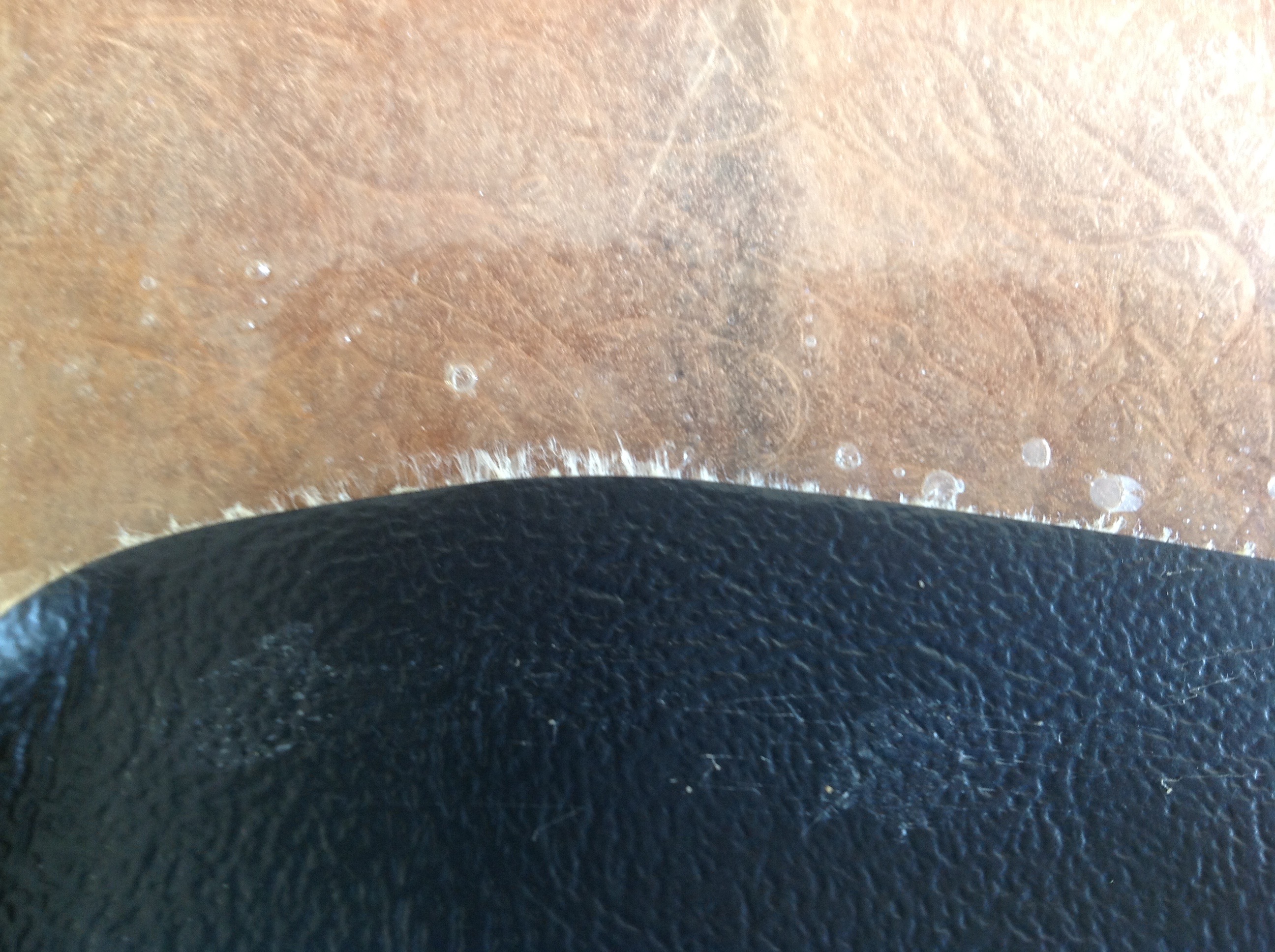

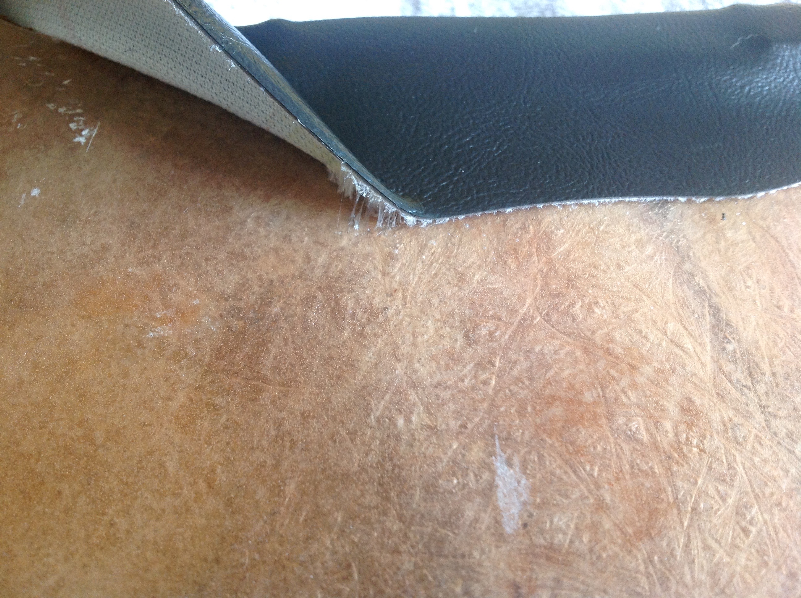

Questions about adhesion?
Pull is obvious and even shear has limits:
