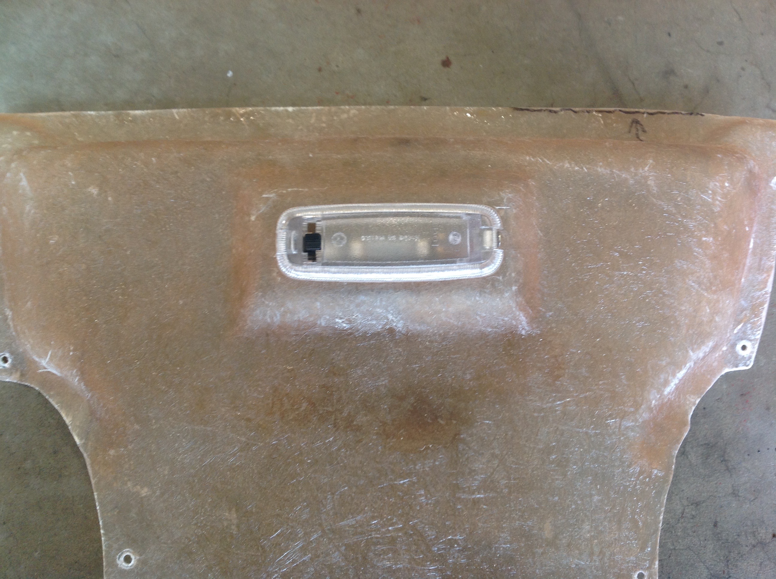

On to the center section.
It's obvious where the interior light should be located, but it's not that simple.
You have to cut out the obvious hole, and then:
In the original arrangement, the light was secured by two thin tabs. Those tabs do not exist on this assembly. Because this "stack-up" is too thick for the original light to simply snap in, I attempted to bevel the fiberglass.
My attempt worked before the vinyl was overlaid.
