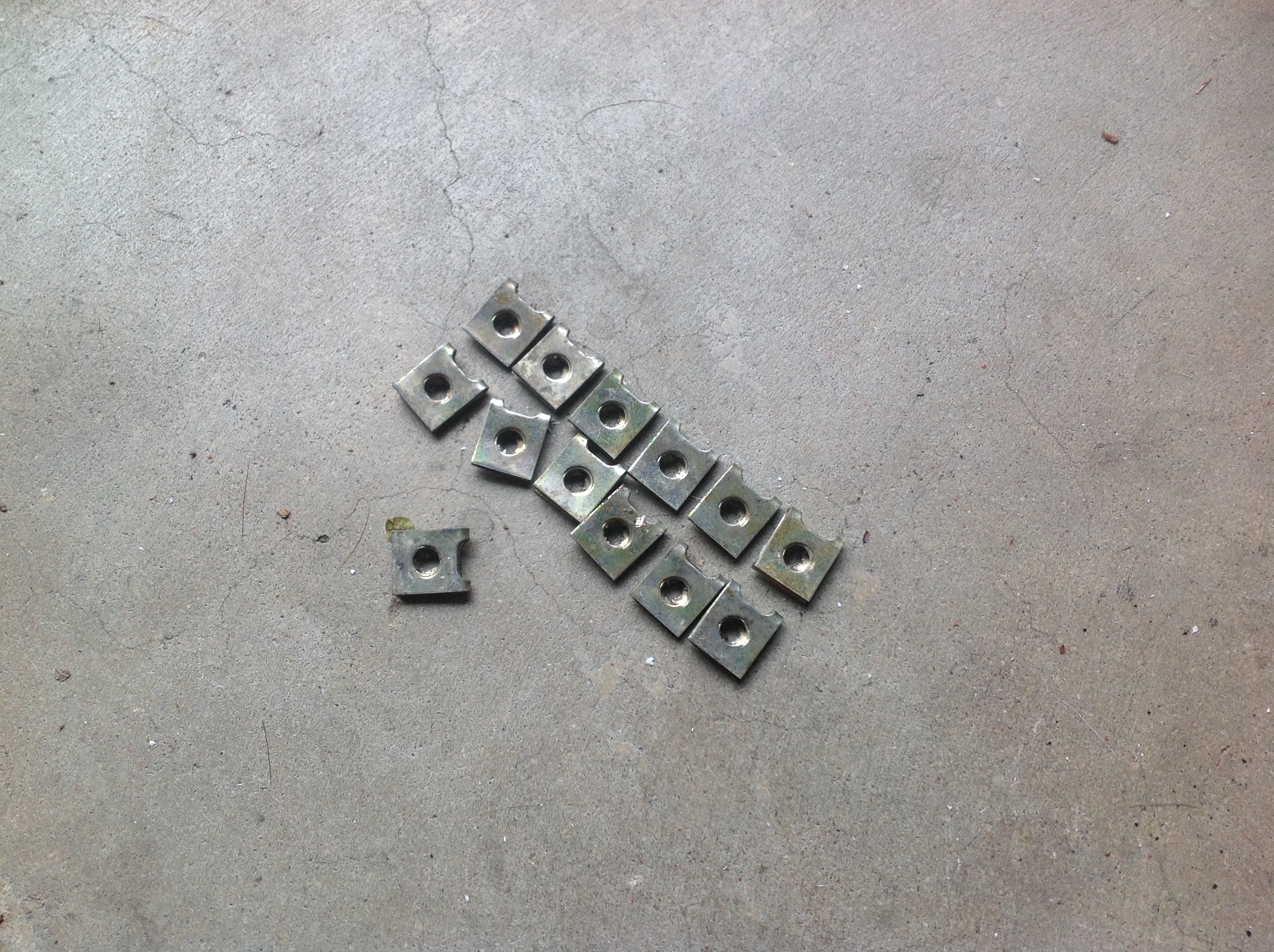

Buy/find some Tinnerman nuts and ad them to the center section.

Series9   Next: You will need these Z tabs. If you have a ...   Mar 9 2016, 04:47 PM
Series9   More of the tabs:   Mar 9 2016, 04:49 PM

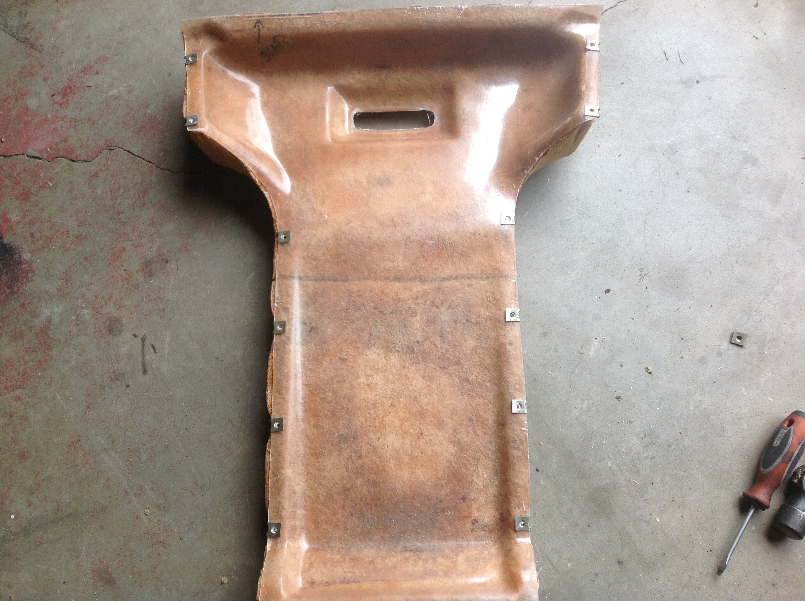

Series9   At this point, you should immediately realize that...   Mar 9 2016, 04:54 PM
Series9   Bondo:   Mar 9 2016, 04:55 PM
Series9   Test fit. I put some shiny new screws in the corr...   Mar 9 2016, 04:59 PM
Series9   Do the same on both sides and mount them to the ca...   Mar 9 2016, 05:06 PM
