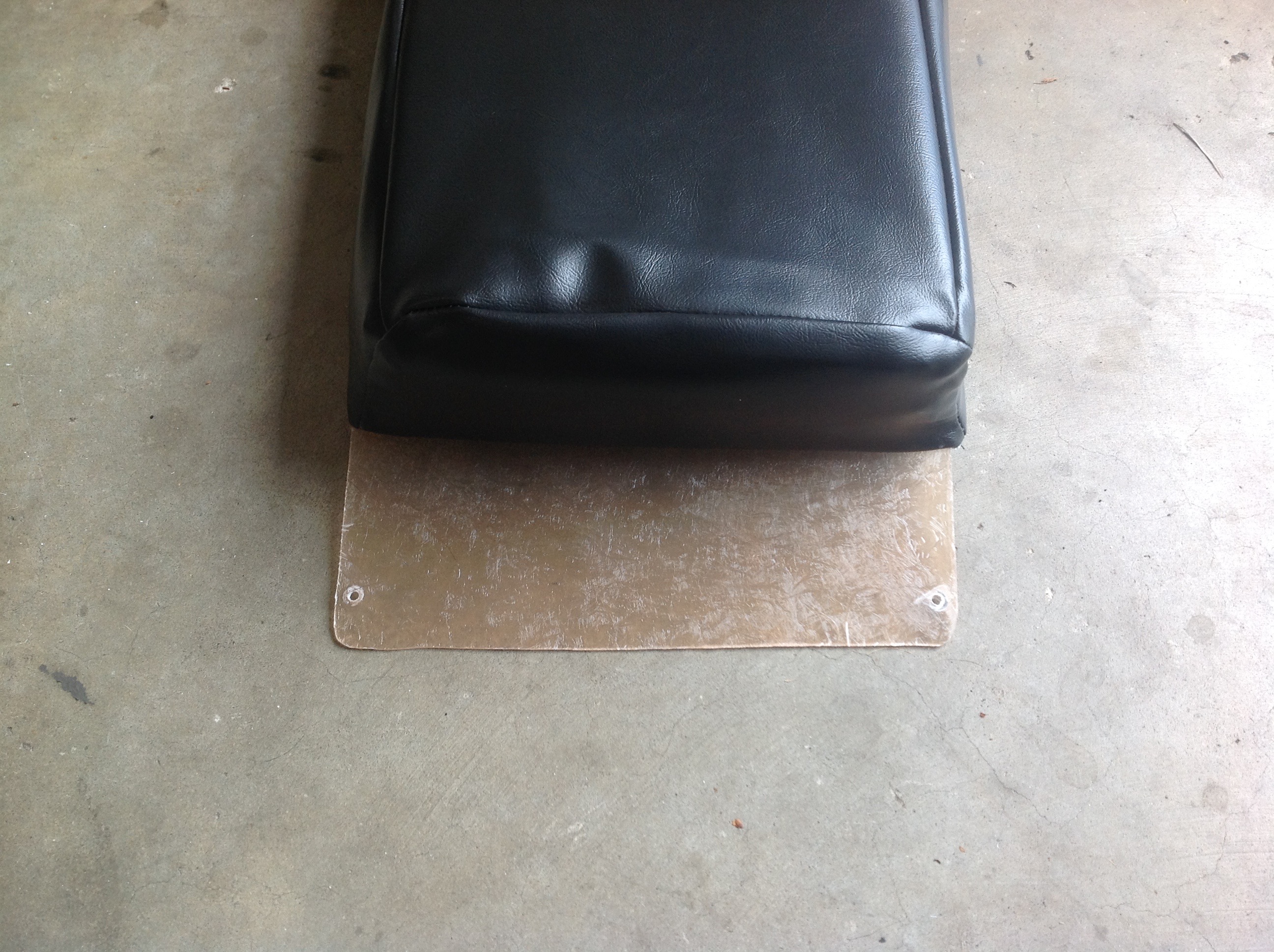

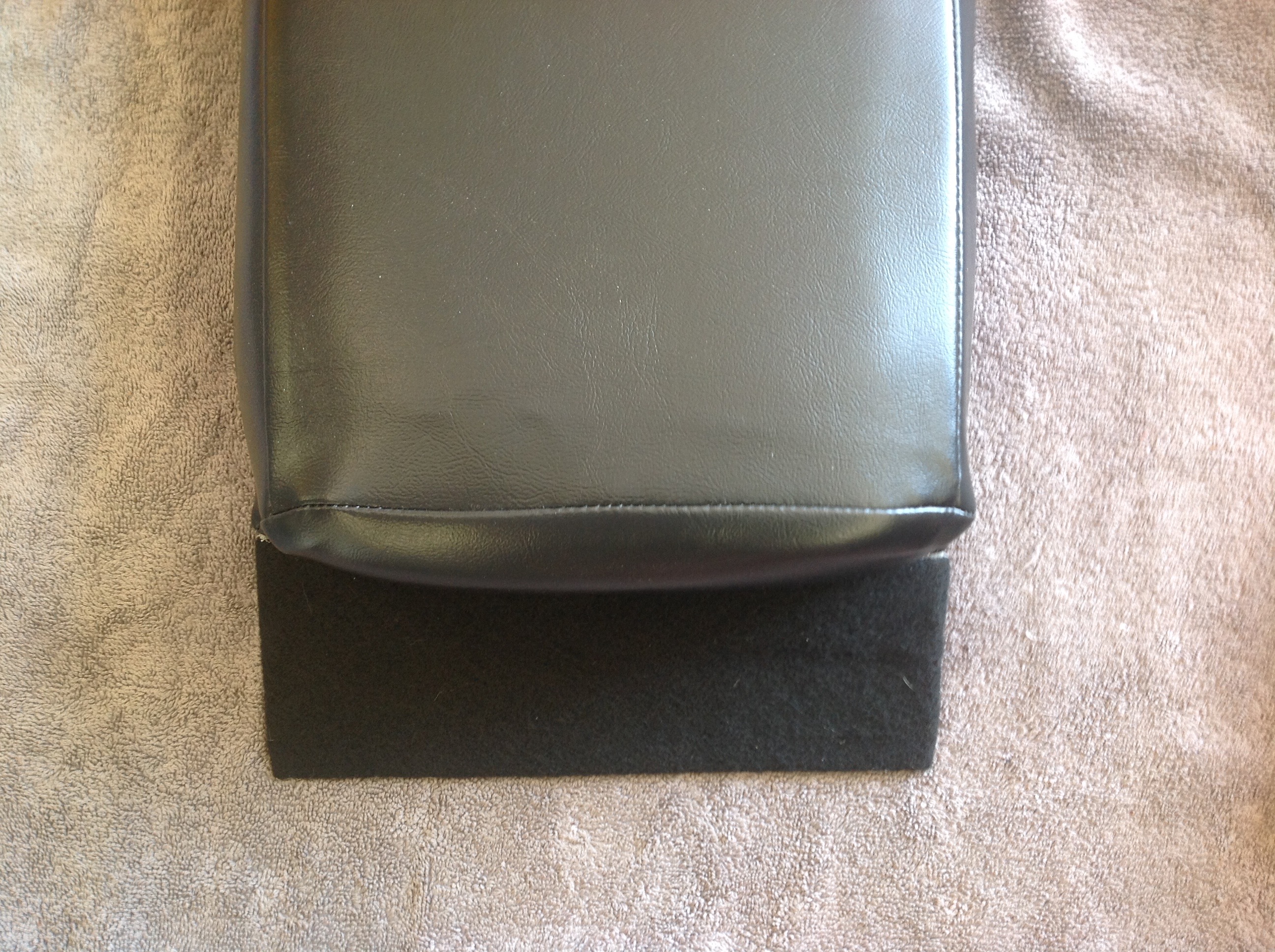

Two bits of funkiness on the center vinyl.
The vinyl simply terminates at the bottom of the foam.
There is no flap for either attachment to the fiberglass or to cover the bottom.
I just covered the bottom with felt, but the vinyl is not actually attached across the front.
