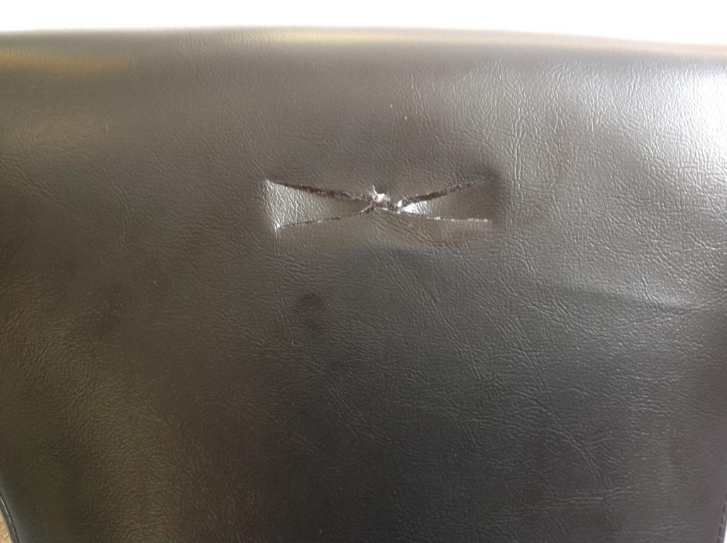

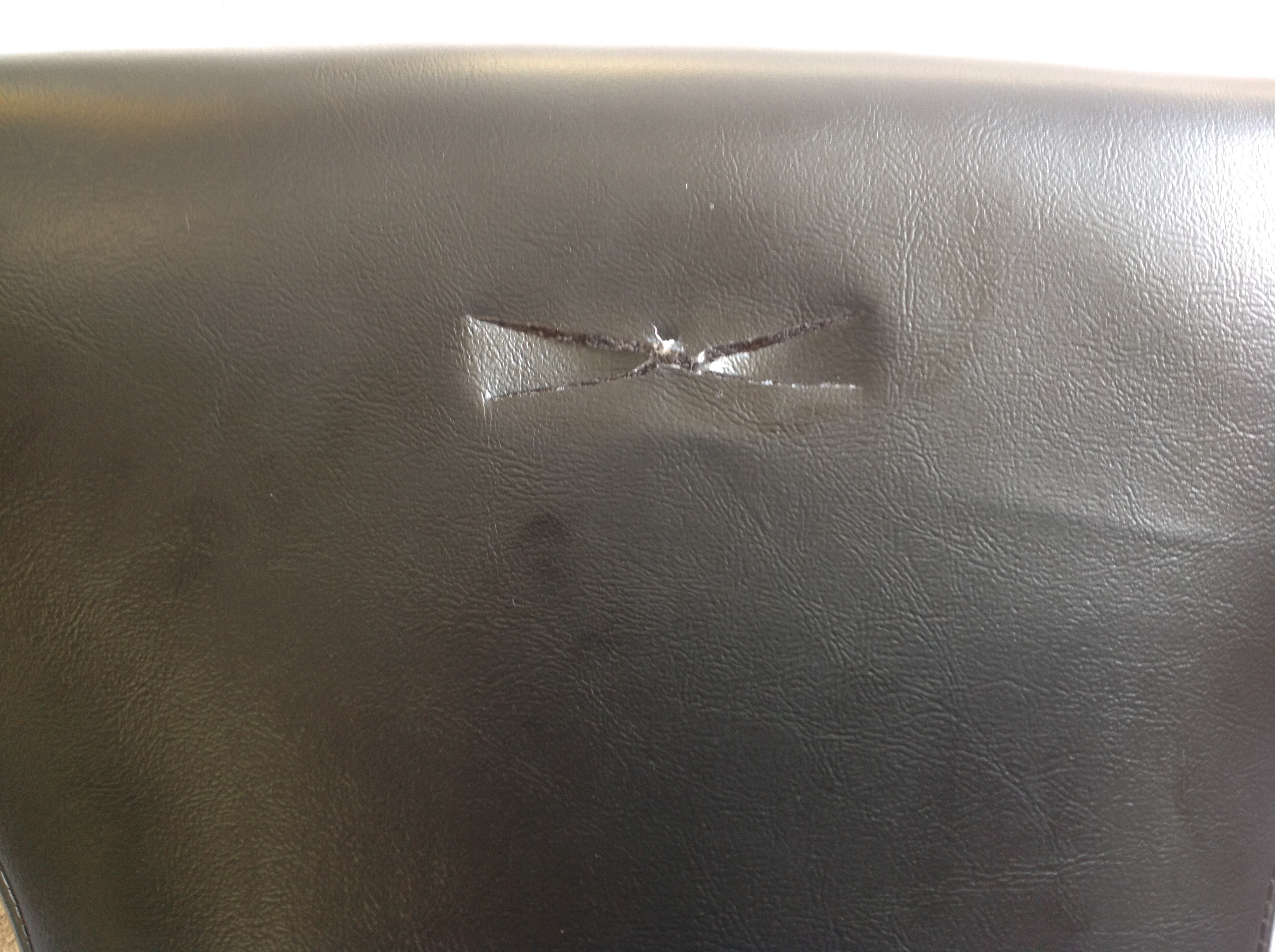

This is a scary cut. Be very careful. Attached thumbnail(s) |
