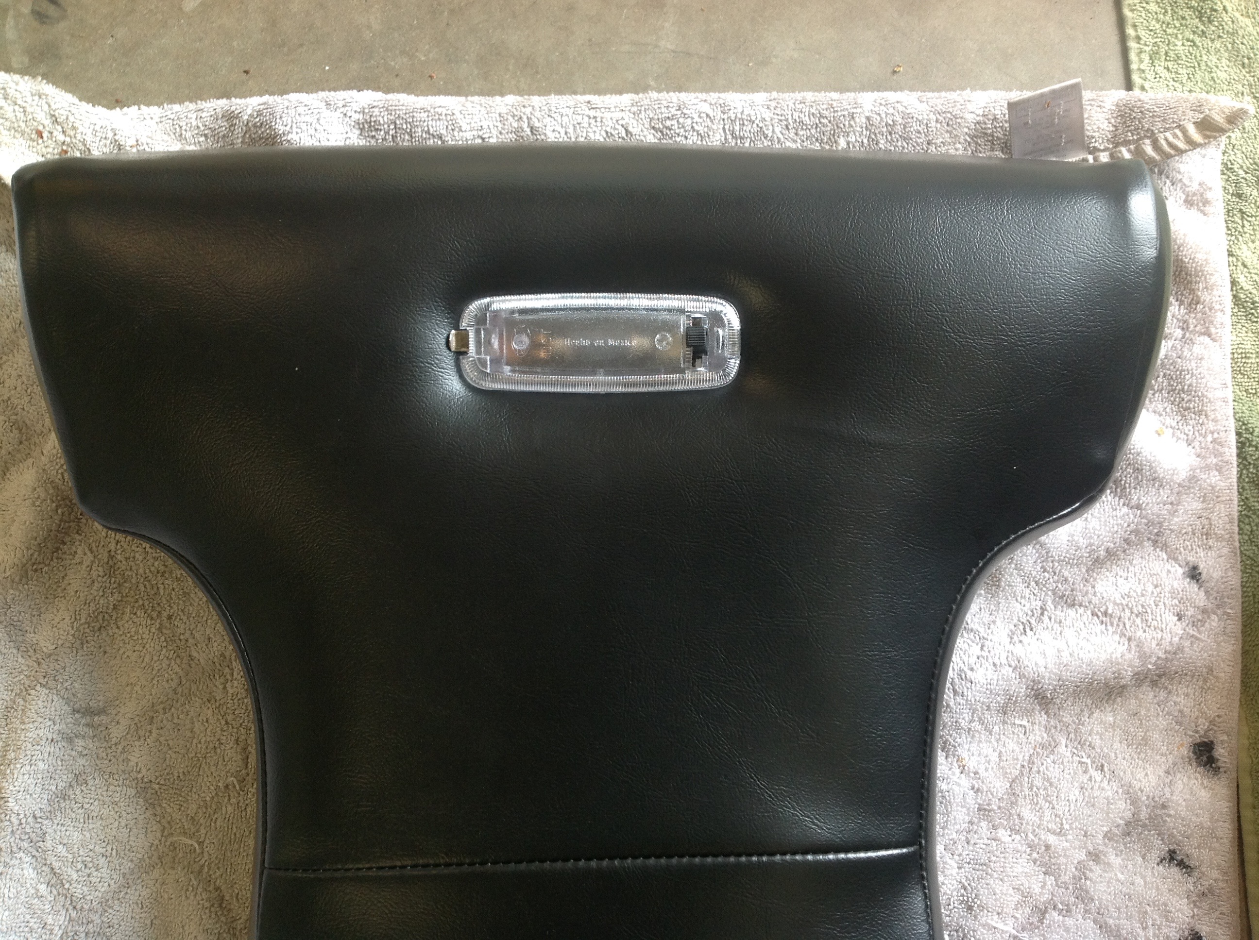

There is no way, that I can see to use anything but contact cement here.
The light is basically friction fit. It won't snap in due to the thickness.

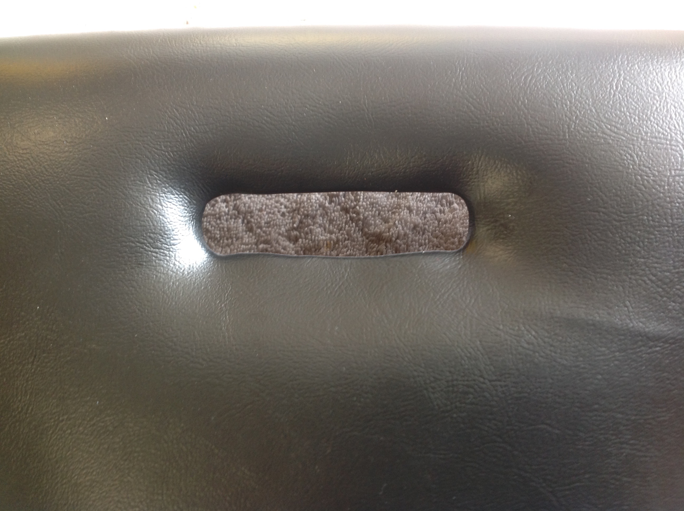

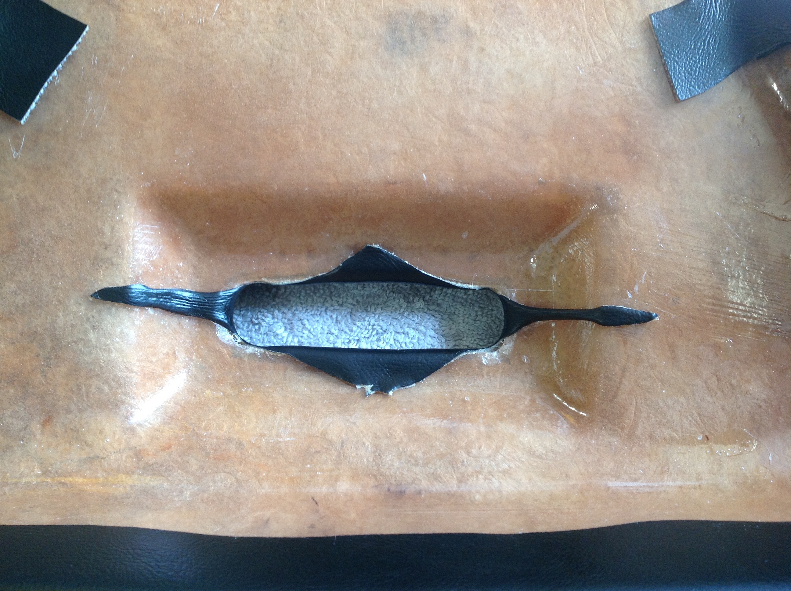

Series9   Two bits of funkiness on the center vinyl. The vi...   Mar 10 2016, 08:25 AM
Series9   This is a scary cut. Be very careful.   Mar 10 2016, 08:35 AM
Series9   There is no way, that I can see to use anything bu...   Mar 10 2016, 08:38 AM
Series9   The center section could be mostly attached with c...   Mar 10 2016, 08:44 AM
