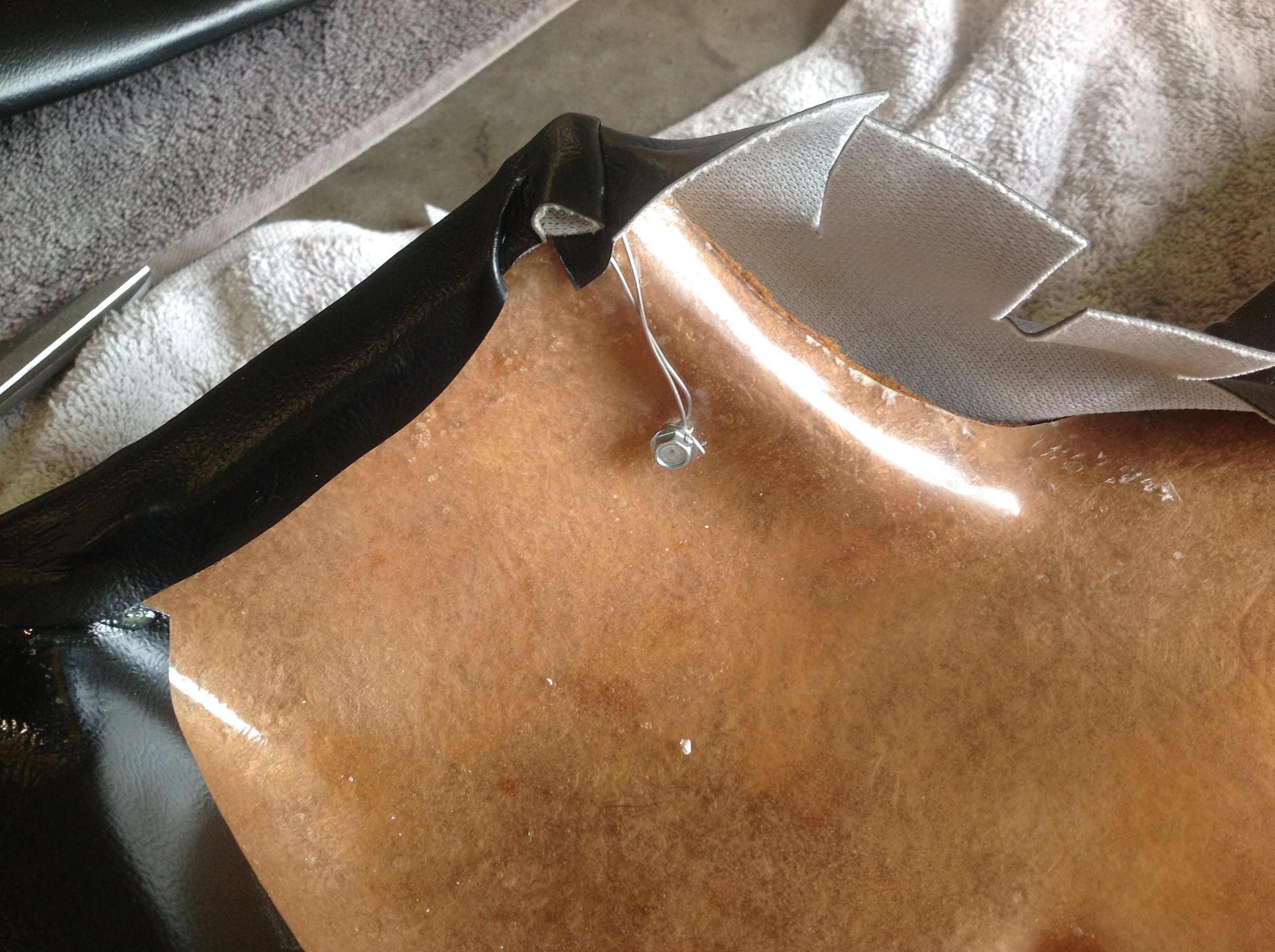

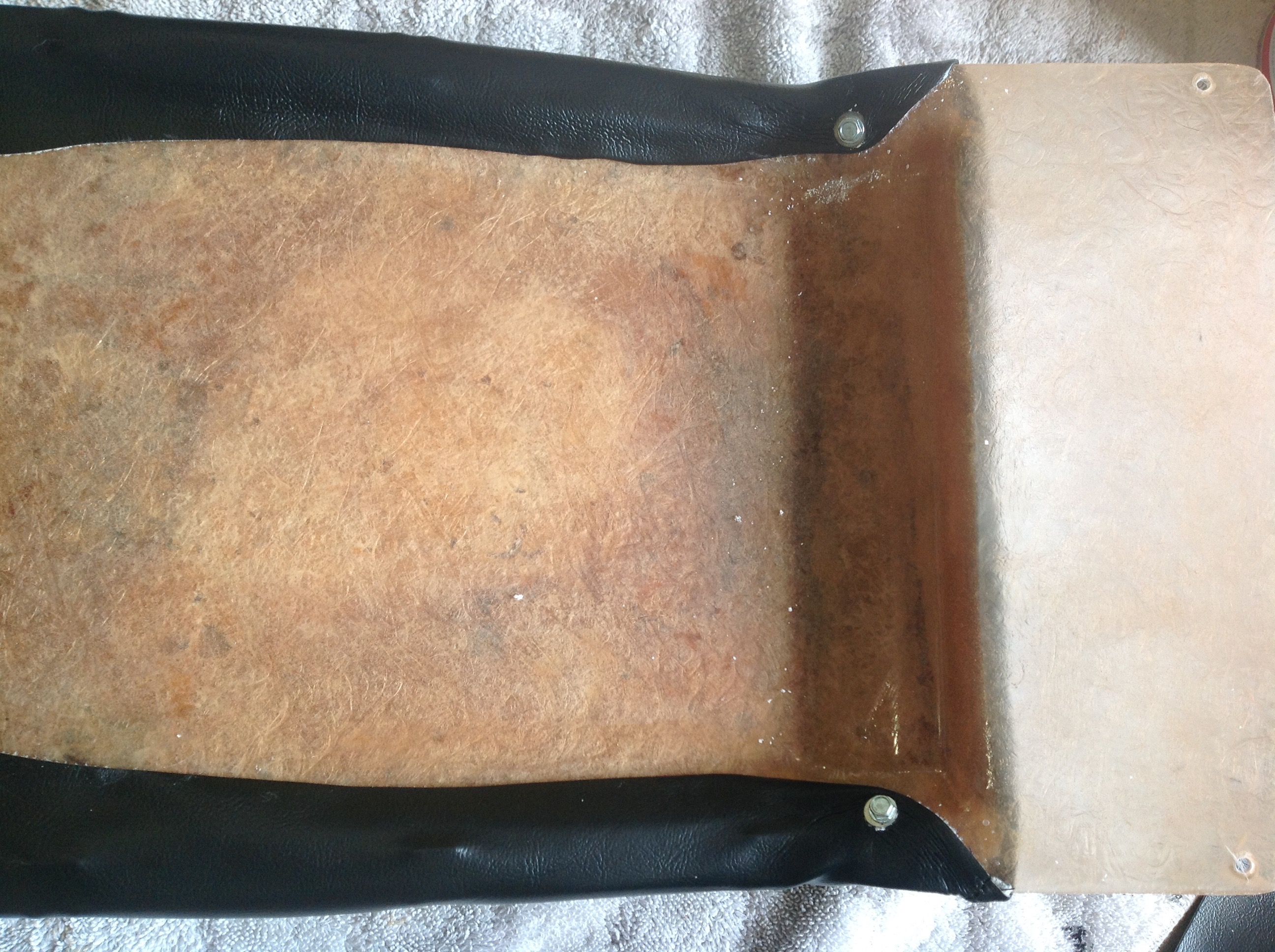

The center section could be mostly attached with contact cement, but I decided 4 points needed more:

Series9   Buy/find some Tinnerman nuts and ad them to the ce...   Mar 10 2016, 08:18 AM
Series9   Get out the 3M Super 90 and attach the foam. The...   Mar 10 2016, 08:20 AM
Series9   Two bits of funkiness on the center vinyl. The vi...   Mar 10 2016, 08:25 AM
Series9   This is a scary cut. Be very careful.   Mar 10 2016, 08:35 AM
Series9   There is no way, that I can see to use anything bu...   Mar 10 2016, 08:38 AM
Series9   The center section could be mostly attached with c...   Mar 10 2016, 08:44 AM
Series9   Get out the hot knife again and poke the holes for...   Mar 10 2016, 08:48 AM
Series9   Get some screws that are just long enough. You do...   Mar 10 2016, 08:51 AM
Series9   That's it! Repeat the steps for the drive...   Mar 10 2016, 08:53 AM
