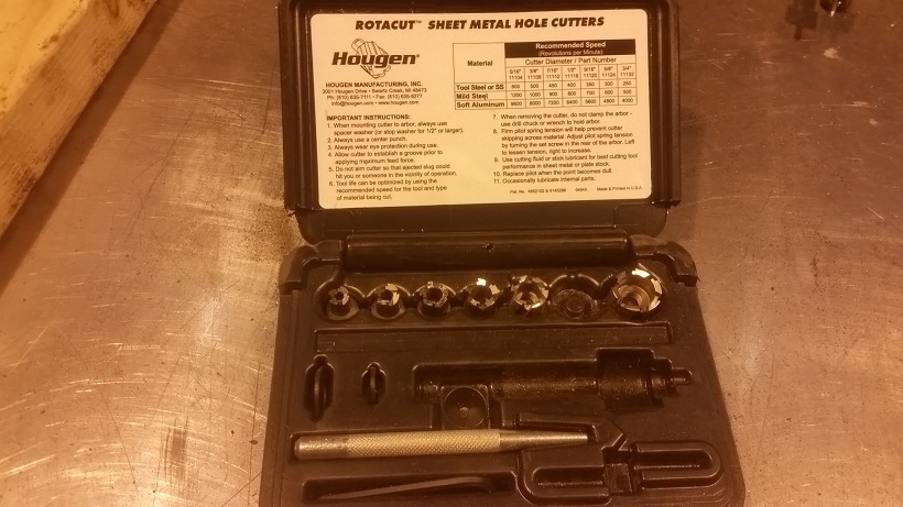

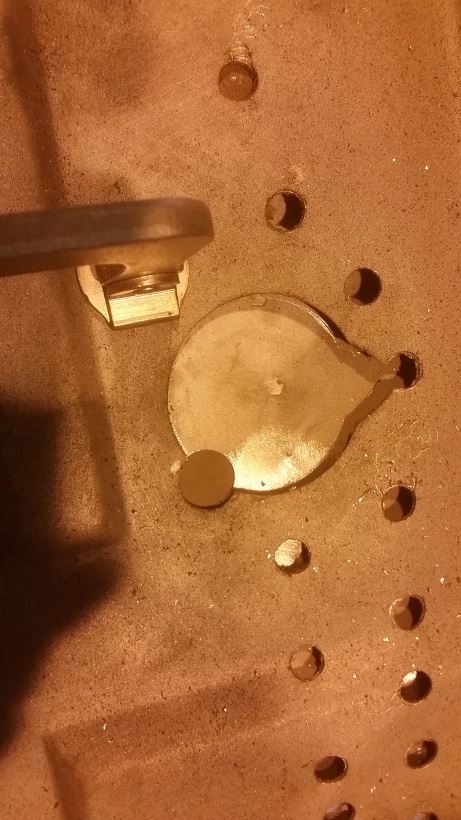

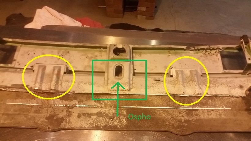

Work continues on the rear panel. Cut up the old to use as patterns for the 75-76 brace hole and rosette holes. They'll be saved for future use. Continued working on the left side of the rear panel. A little tougher work with all those extra holes. I still might cut it out and put in a patch. The metal gets kind of goofy with all those different welds.
This is no charge research time.
Used the larger hole cutter in the Rotacut kit to make the smaller hole.
More on Mark's comment. I'm going to fill that cavity with OSPHO and let it do it's thing.
