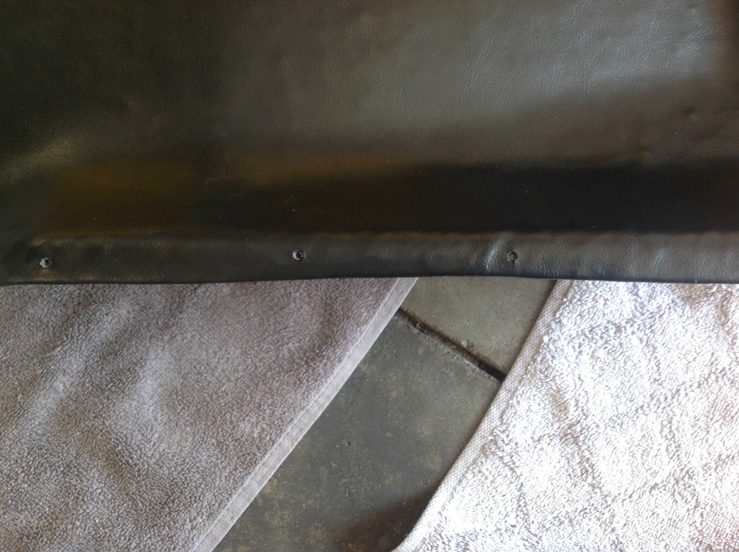

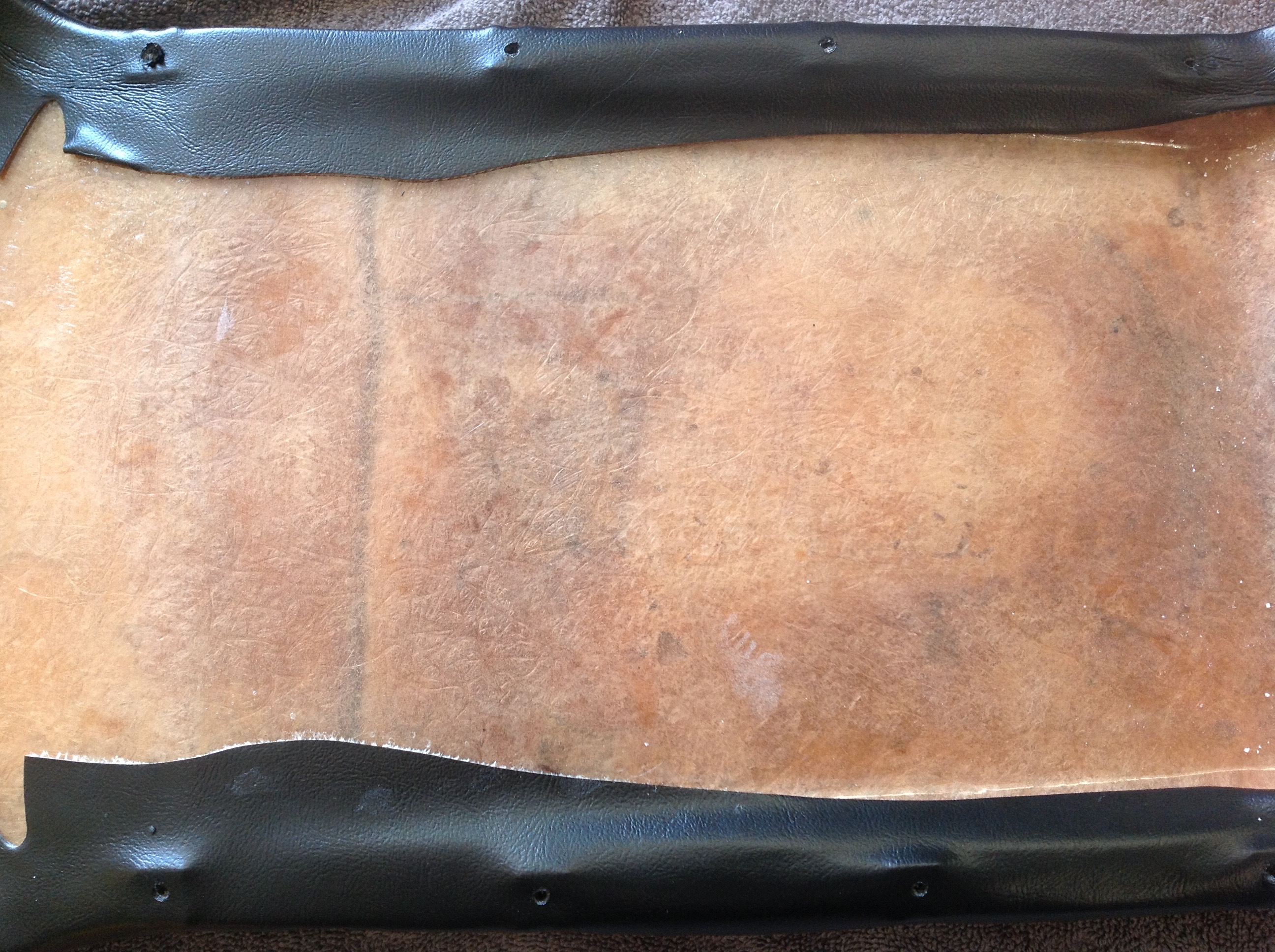

Get out the hot knife again and poke the holes for the Tinnerman nuts:

Series9   Get out the hot knife again and poke the holes for...   Mar 10 2016, 08:48 AM
Series9   Get some screws that are just long enough. You do...   Mar 10 2016, 08:51 AM
