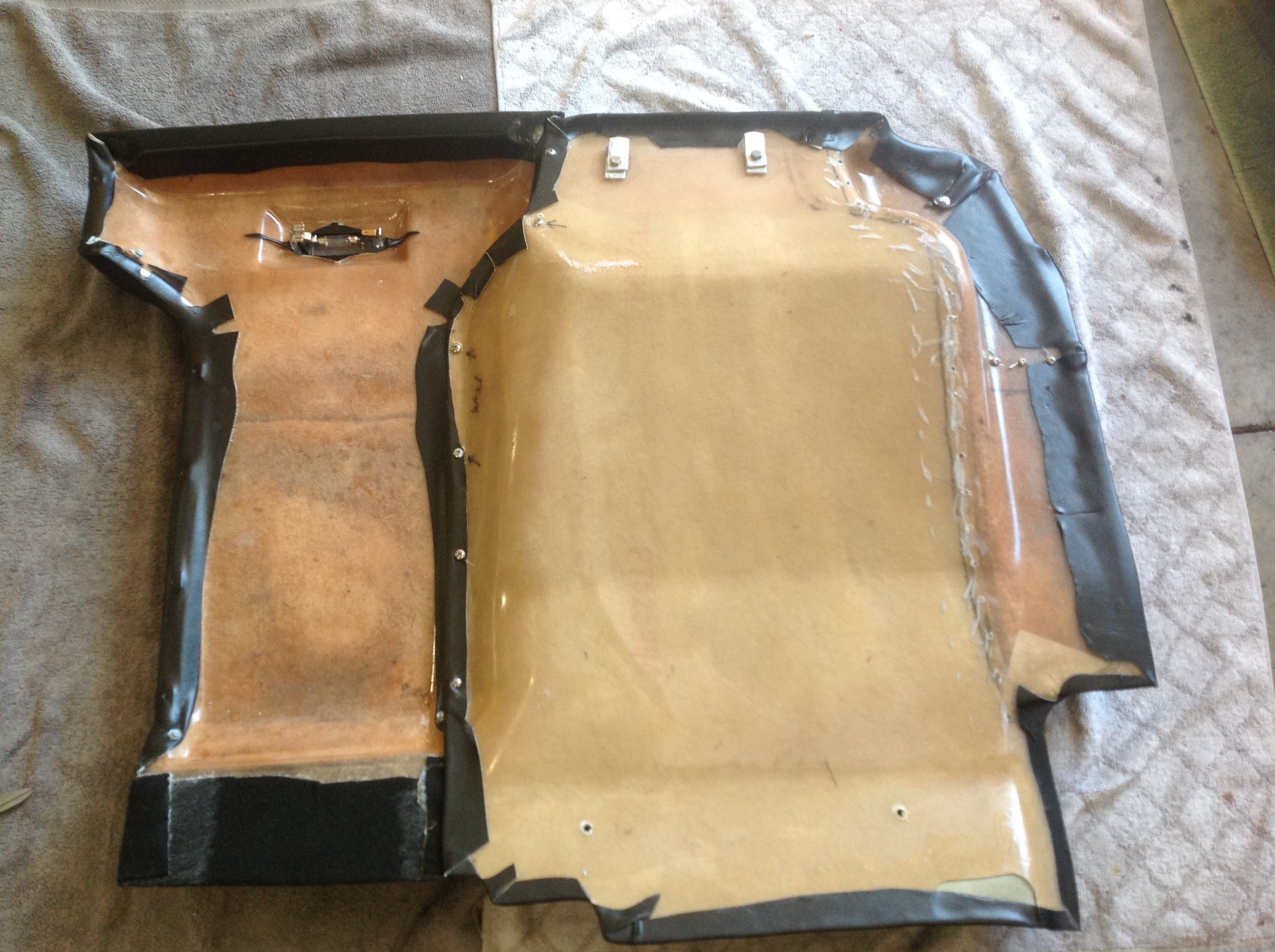

Get some screws that are just long enough. You don't want to flip this over and have a screw poking out of the center vinyl.

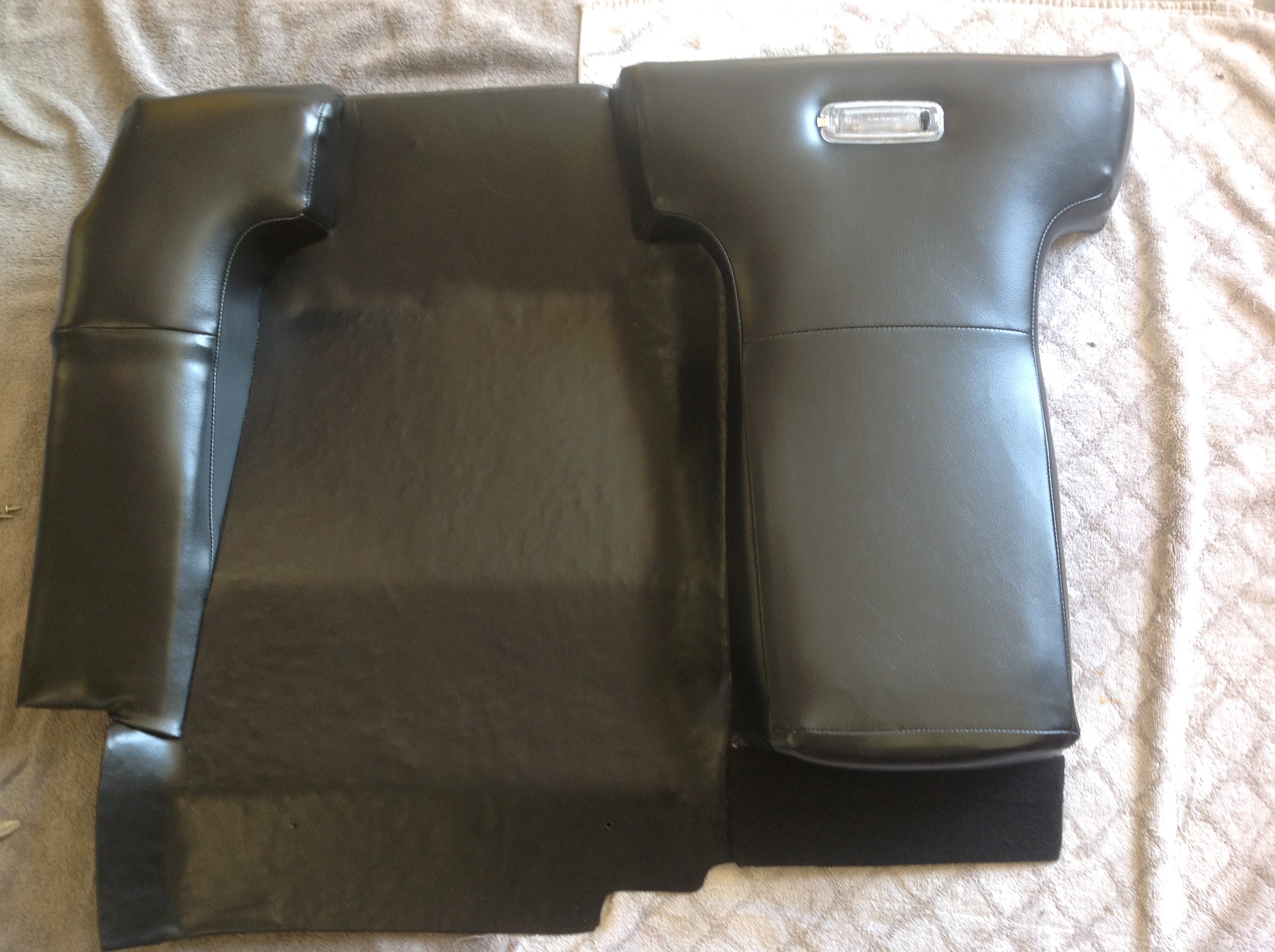

Series9   Here's the back and the front after a test ten...   Mar 9 2016, 06:04 PM
Series9   Then, tension the vinyl around the pad. I chose ...   Mar 9 2016, 06:10 PM
Series9   And then (said in an Asian voice from "Dude, ...   Mar 9 2016, 06:20 PM
Series9   Remember (again) when we talked about contact ceme...   Mar 9 2016, 06:31 PM
Series9   The next four finish up the passenger side. Note ...   Mar 9 2016, 06:38 PM
Series9   Remember the pulls on the median seam on the outsi...   Mar 9 2016, 06:43 PM
Series9   Questions about adhesion? Pull is obvious and eve...   Mar 9 2016, 06:50 PM
Series9   On to the center section. It's obvious where ...   Mar 9 2016, 08:11 PM
Series9   Buy/find some Tinnerman nuts and ad them to the ce...   Mar 10 2016, 08:18 AM
Series9   Get out the 3M Super 90 and attach the foam. The...   Mar 10 2016, 08:20 AM
Series9   Two bits of funkiness on the center vinyl. The vi...   Mar 10 2016, 08:25 AM
Series9   This is a scary cut. Be very careful.   Mar 10 2016, 08:35 AM
Series9   There is no way, that I can see to use anything bu...   Mar 10 2016, 08:38 AM
Series9   The center section could be mostly attached with c...   Mar 10 2016, 08:44 AM
Series9   Get out the hot knife again and poke the holes for...   Mar 10 2016, 08:48 AM
Series9   Get some screws that are just long enough. You do...   Mar 10 2016, 08:51 AM
Series9   That's it! Repeat the steps for the drive...   Mar 10 2016, 08:53 AM
