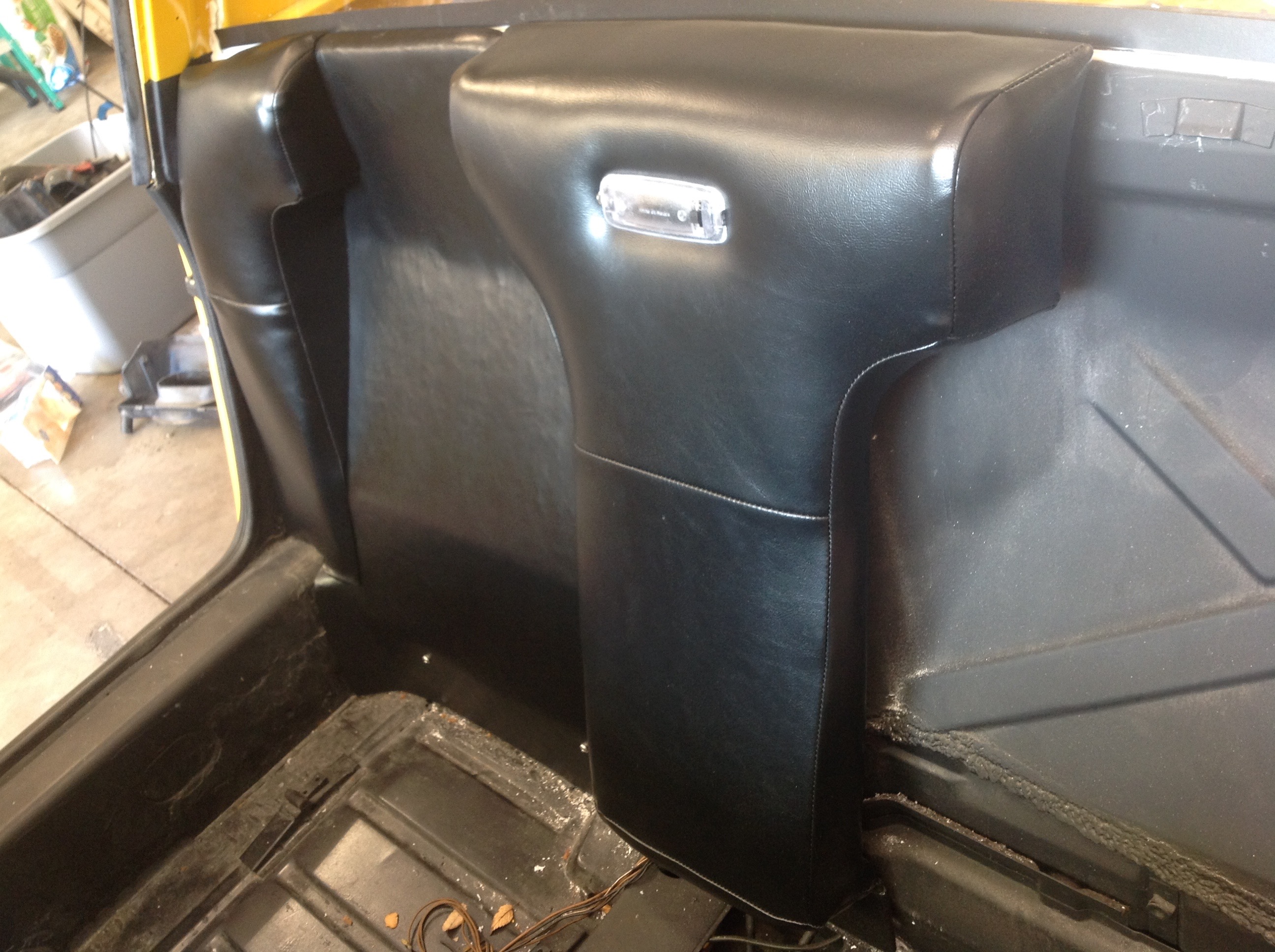

That's it!
Repeat the steps for the driver's side and you're done.
Whew!
