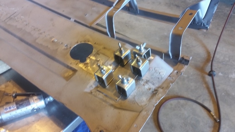

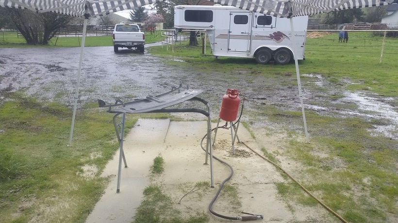

Started the day with more liquid sunshine. (IMG:style_emoticons/default/mad.gif)
So I needed to set up the pop up to shoot some more glass beads. I still needed to get the back side blasted.

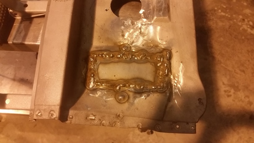

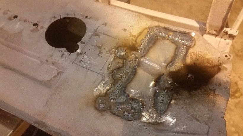

Then I decided to cut out the left side holes I filled. Too many holes, waste of time. It would have taken to much All Metal to get smoothed out.
Sorry, a little blurry.
Front side and back side.
The smoky spot is me hitting seam sealer.
