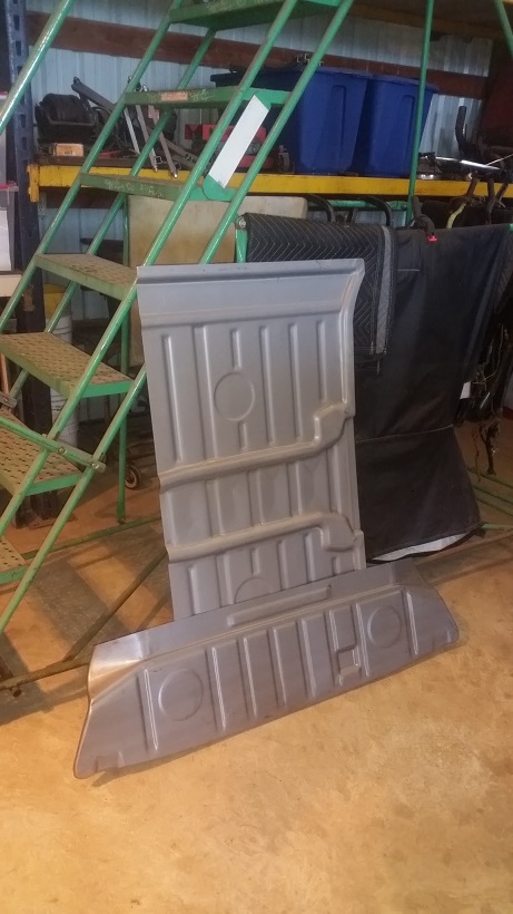

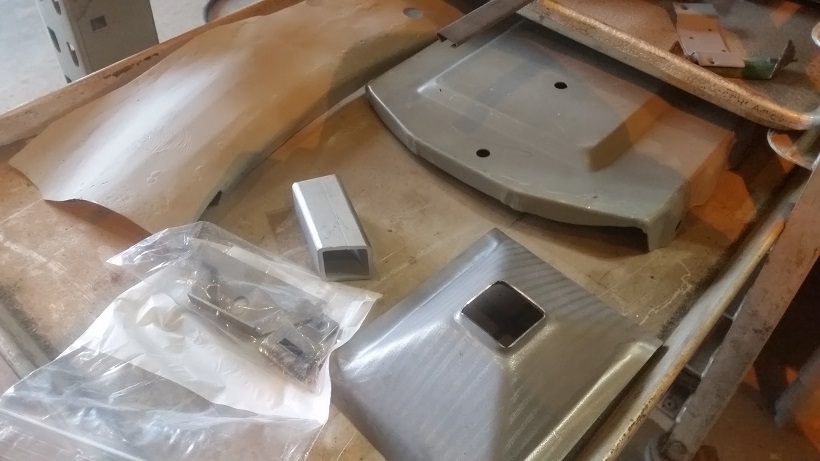

The RD stuff ...............
I love new metal ....................
I'll add in a left over door sill left over from the long I bought from Perry. And a battery tray support that I have that I over ordered.
Looks like we'll need an e-brake pivot too. I'll look at the one on my parts car tomorrow. But I have my doubts its any better than one I already have.
