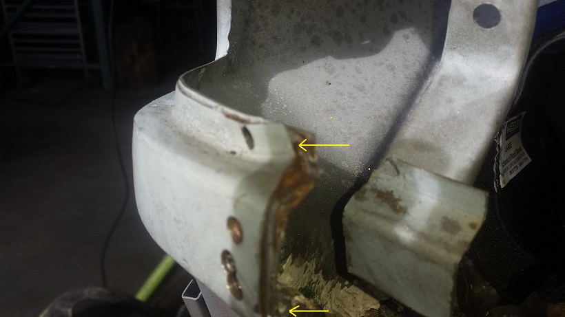

A few rust pits on the upper right outer wheelhouse long
But we also a have fairly good sized rust spot a little further up the upper long. Right next to the suspension console.
These are both in the double walled section of the upper long.

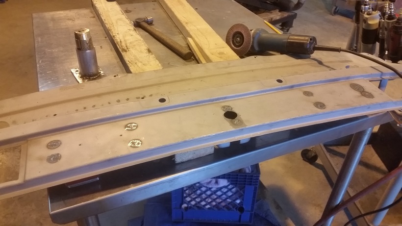

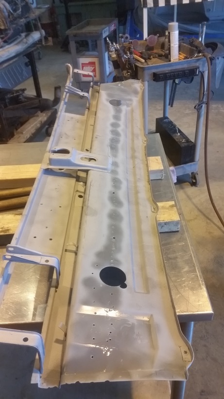

Finally finished up creating the 75-76 rear panel this morning. I'll finish up the final hammer and dolly work after its attached.
Filled in the old PORSCHE reflector holes.
Now in lies the $1,000,000 question. How does one get that bitch in without cutting off the flanges? Hmmmm.
With the quarter panels firmly welded in there isn't any slack to slide the rear panel flanges into the quarter panel sandwich.
