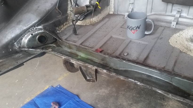

I've been asked by Mark to do some sheet metal/body work on his 75 2.0 Liter project car. The car arrived last Monday. But I needed to finish up a couple things on my project car and in my shop first. But I dove in this afternoon.
First task is to tidy things up after the paint stripping. Which included dropping the engine in order remove any residual media in the nooks and crannies. I was concerned with the rust prevention product that Dustless Blaster mixes with the glass media being left on and in the electrical connections. I'm a firm believer of an ounce of prevention is worth a pound of cure. I dribbled some OSPHO on a couple connectors in my white car. Not good. It ate the crap out the plating.
Here's Super In Law working on loosening up the media in order to blow it off. It will need to be steam cleaned.

Observations :
Suspension Consoles look great and seem to be virgin.
Same with the motor mounts
Battery tray was changed at some time in its life
Back engine tray is bent to hell .............pushed up
Hell hole is filled with caked in blast media. Stopping at Sears on the way home for a new filter for my vacuum. I'll look closely for prior repairs.
Both the lower longs look great at first glance

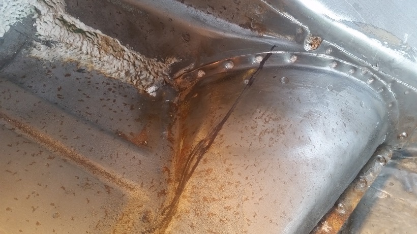

Needing more research :
A few rust pits on the upper right outer wheelhouse long
But we also a have fairly good sized rust spot a little further up the upper long. Right next to the suspension console.
These are both in the double walled section of the upper long.

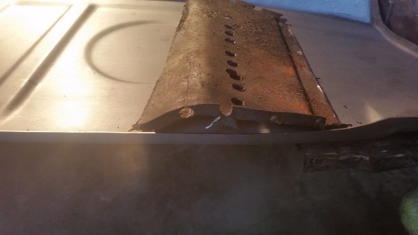

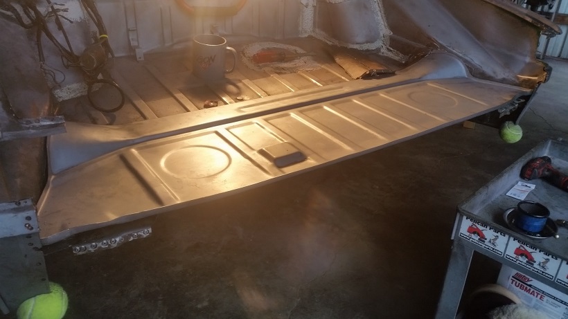

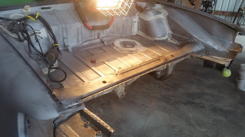

Now that I have some new replacement panels we'll start with cutting out the remainder of the trunk.
New part laid in for tracing it out.
The replacement piece only goes a portion of the way up the rounded support portion.

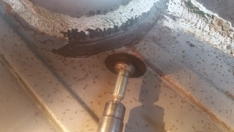

It is a pretty tight cut up against the trunk side panel. So I always keep a few stubby discs for just this occasion.
Whoa-law ................. Presently surprised that there was little to no rust inside the transmission support. Just a smidgen of surface rust on the right side.

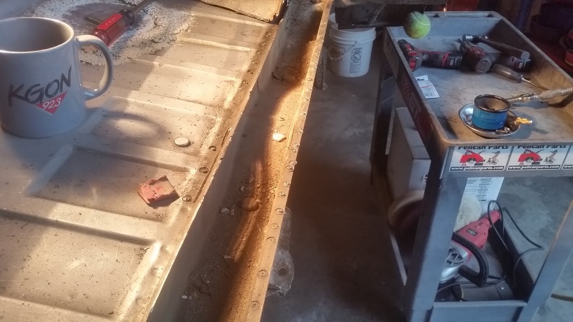

Not feeling the love on the 75-76 modification to the floor pan, looks to be pretty different. Won't really won't know until it lines up with the rear panel. The sides and the bumper mount pans look Ok. But will the spot weld holes line up?
All cleaned out and ready for it's overnight application of OSPHO. The inside will get an application of POR15. I have 4 cans that I haven't been using, but this is great spot for it.

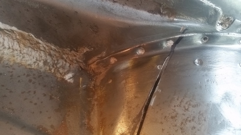

cary   While welding I find another problem. The right si...   Mar 17 2016, 09:32 PM
