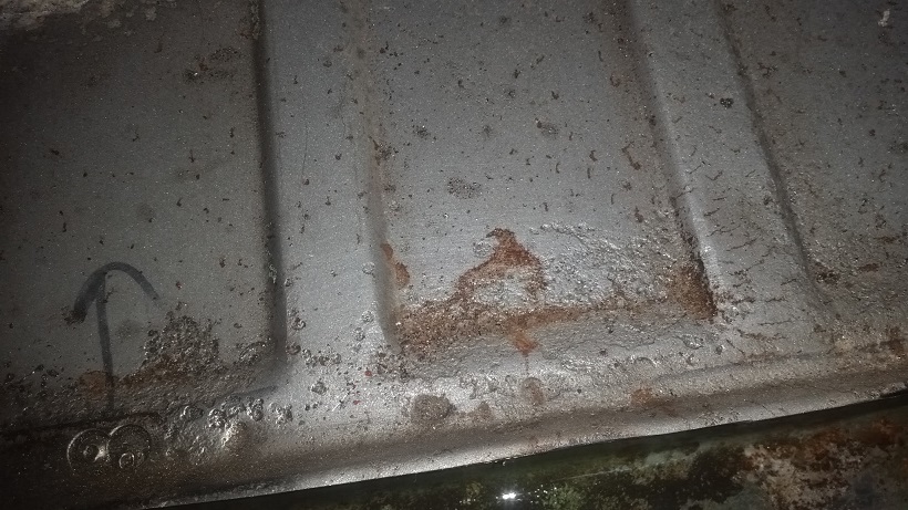

Needing more research :
A few rust pits on the upper right outer wheelhouse long
But we also a have fairly good sized rust spot a little further up the upper long. Right next to the suspension console.
These are both in the double walled section of the upper long.

I wish the replacement panel was just a bit longer so I could have replaced this too.
I'll see if I can do some grinding and wire cup work make it look more presentable and last another 40 years.
