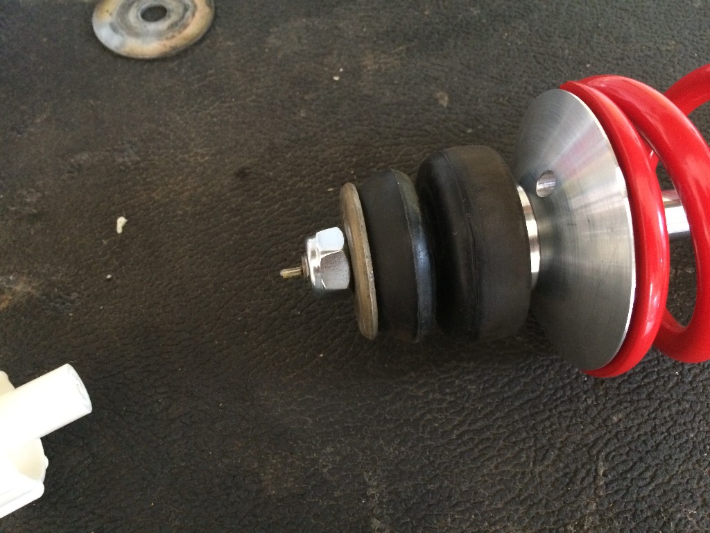

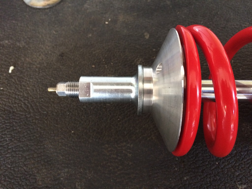

This is where the stupid question comes in: Are there different threaded collars (bushings) for Bilstein and Koni? Look at these pictures: First one is the threaded collar, screwed all the way down on the Bilstein as it's supposed to - and the rubber bushing goes over it. The second one is as far as the collar will go...which is not at all because the thread pitch on the Koni is different!! Do I need a special threaded collar for Konis? Did they not send me something I should have? Suspension is something I've honestly never messed with...

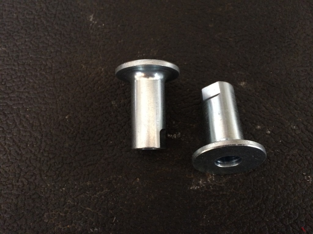

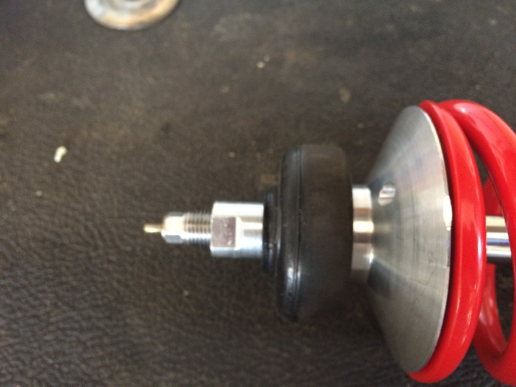

So here are the CORRECT collars:
they screw on nicely: (you don't use the big washer that's used with the stock spring hats)

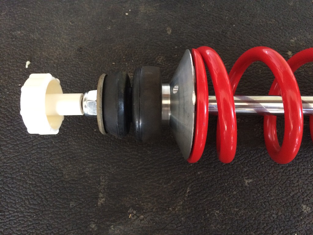

Then with the bushings on. For those that don't know...you slide the first one over the collar (first picture), then put the top of the shock up through the hole in the chassis, then put the other bushing, washer and nut on.
This is how it looks fully assembled, though the shock tower body would be between the two bushings.
