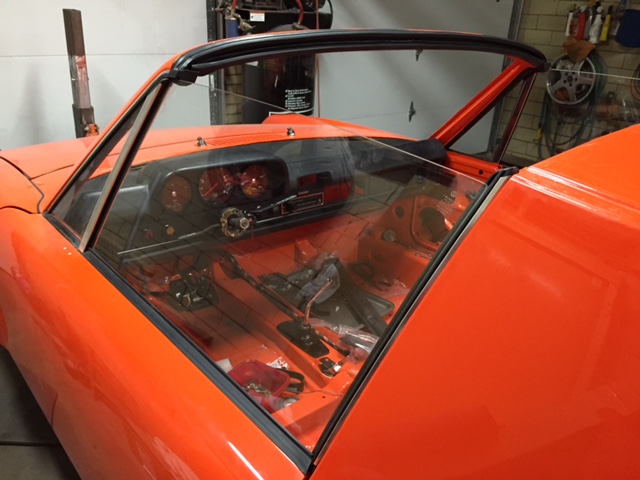

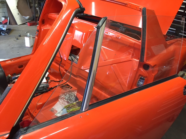

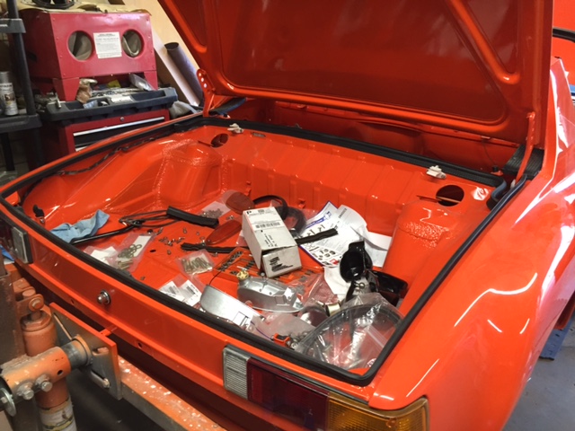

This month I have had a lot of help from Mark at 914Rubber both technical and financial with the discount. The discount has really helps since I have replaced almost every piece of rubber on the car. The most helpful tip when trimming the rubber strips to the correct length was to put soapy water on the knife blade. It cuts like butter with soap water but without the soap water it grabs and gives ragged edges.

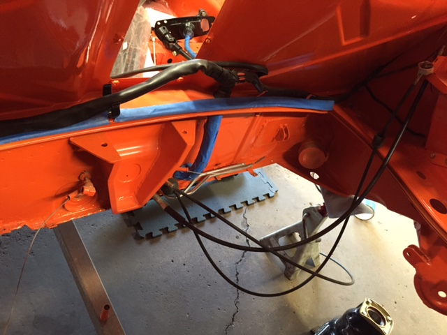

I got the new stainless fuel lines installed this weekend along with the clutch cable and speedometer cable.

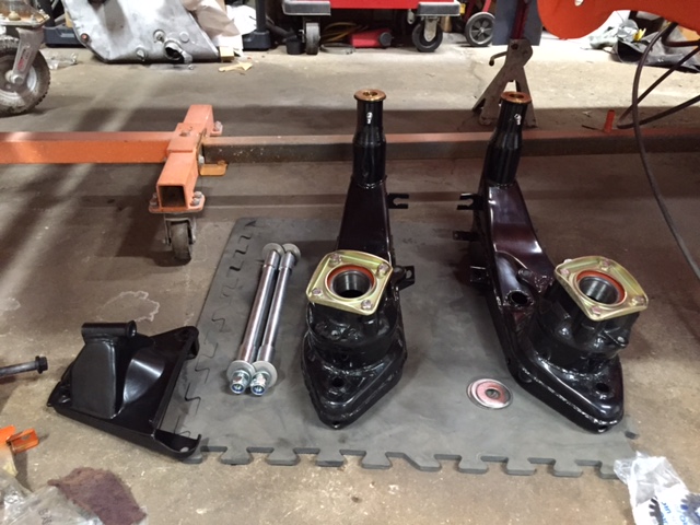

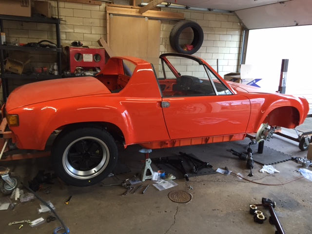

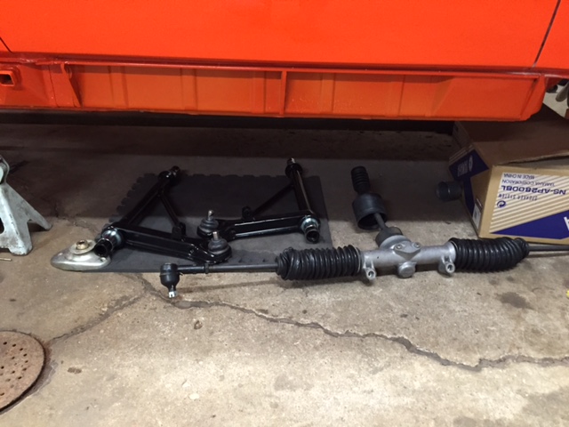

I assembled some of the suspension components last week.

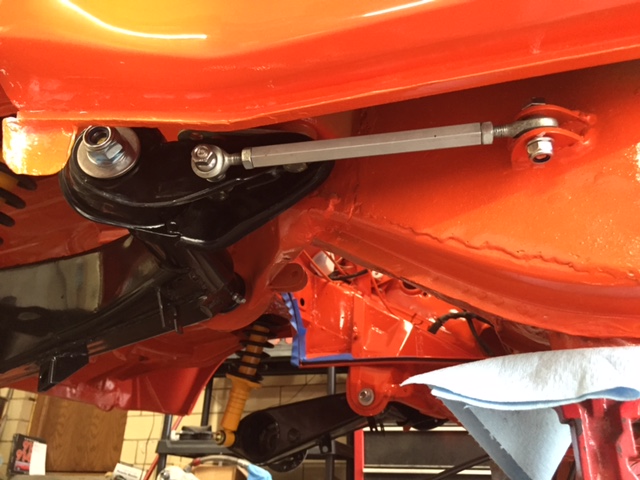

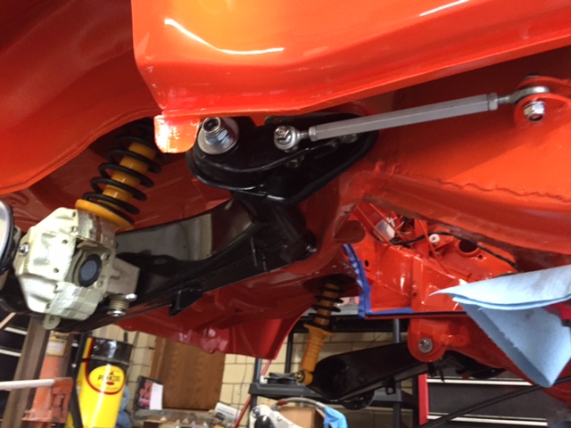

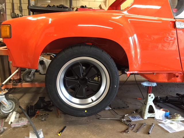

I have started to install the suspension this week along with the brakes that PMB upgraded so that I can run the wider vented rear rotor.
I also mounted my adjusting links to make tuning the suspension settings easier.
I was even able to test fit a wheel on the back of the car.
I still have a lot of work to go but I am making some progress thanks to a milder than usual winter!
