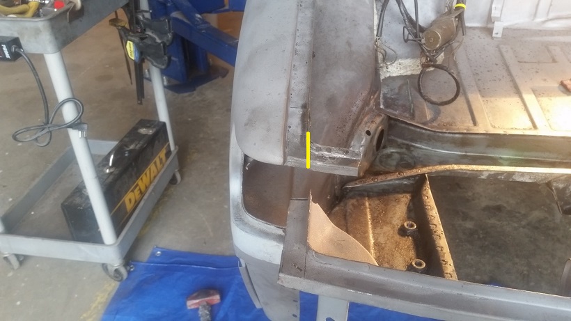

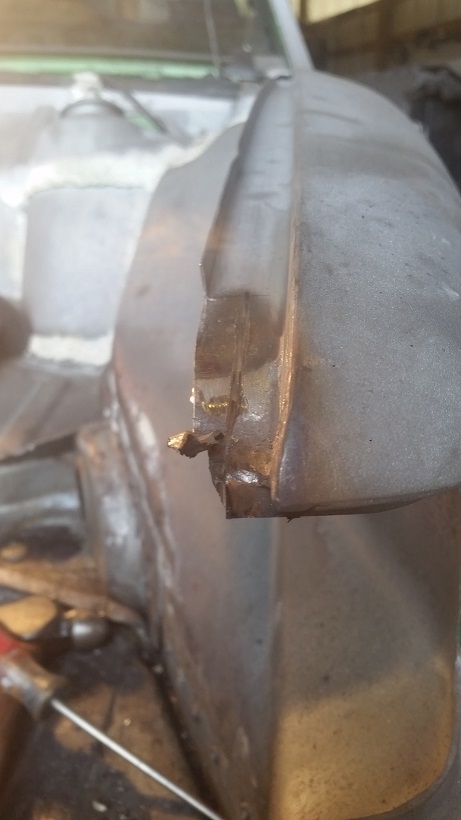

So we start with trimming both the qtr. panels and the refurbished taillight panel. I've kind of been dreading this. The bottom and the middle are easy. The top channel is pretty small and thin. I've determined that I'll split the double layer inside the trunk channel for my welding points. Top layer is the qtr. panel. Bottom is the tub.
Cut#1 is removing the tail left on the taillight panel
Cut#2 - Removing the channel flange

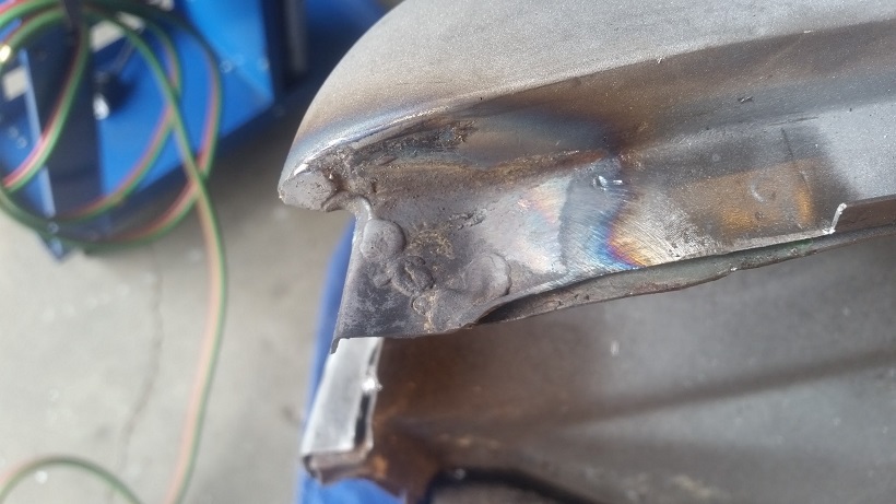

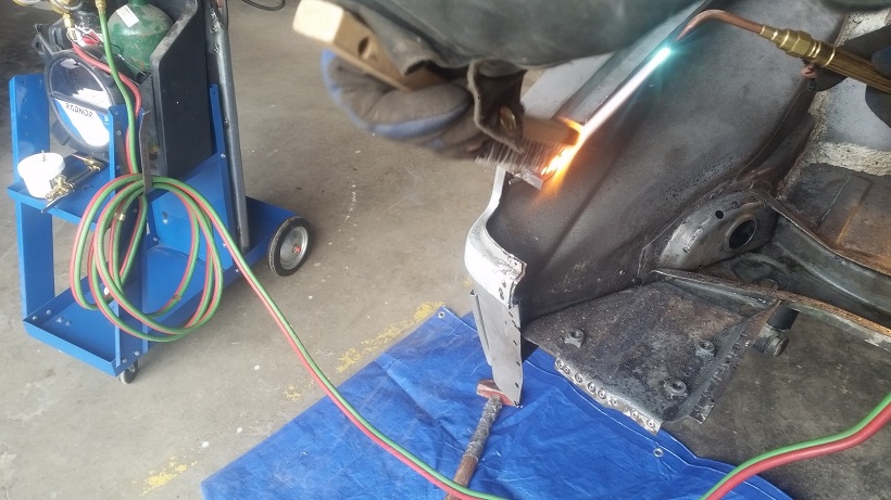

Next task is To Get The Lead Out ............
Super In Law handles it .......... Old School torch it and pull it out with a wire brush.

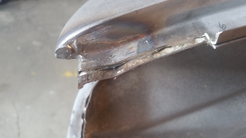

This what you see under the pretty lead finish. I'm thinking I'll get the new fake lead kit from Eastwood and try to replicate it. Leaving it would create a low spot for water to collect under the seal.
Then I went about cleaning (the best I could) the insides of the panel sandwich with the air saw. Pulled out lots of seam sealer. I didn't get it all, had some come thru on my welding and contaminant the weld (pin holes).

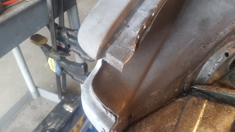

With both qtr. panels trimmed up I could now lay the taillight panel into it's new home and take measurements for the cut out of the channel. Prior to the test fit I had cut the channel portion in half with the cut off wheel.
The pencil line is were the factory spliced them together under the lead. So they would have torch welded in the diagonal cut, then spot welded in the support corner. If they had been a little more precise with the spot welder, removing the support corner would have been a better route. But because these were hand built cars, they on occasion lay one spot weld on top of another. Which makes a big frikking ass mess trying to drill out the spot welds. Leaving you with just about nothing when your done.
Here's a couple shots of the channel cut out. Just lightly make the cut on the scribed line. Then peel if back with the wood chisel or small screw driver.
