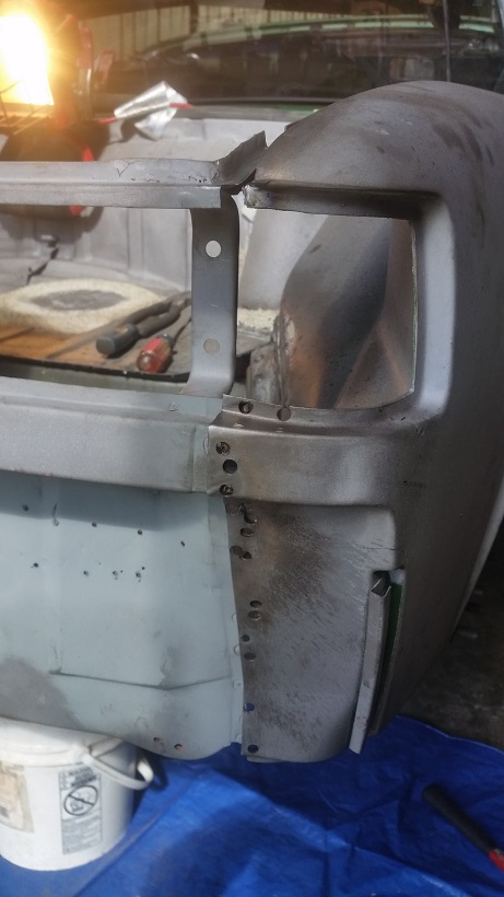

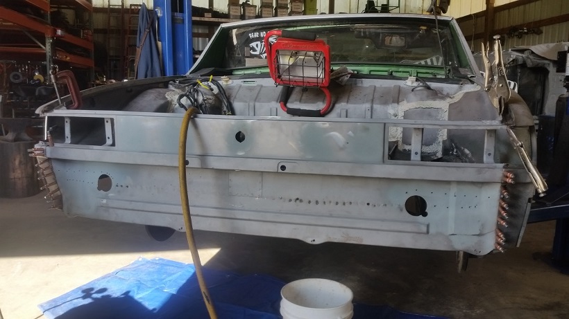

Now we move to positioning the rear panel .............

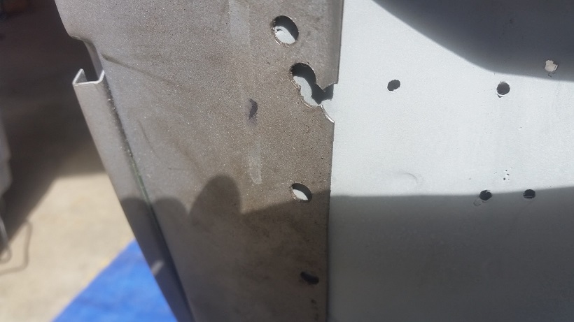

1st., I opt to spread open the middle channel on the left side. No particular reason.
After a test fit I decide I'll need to trim a bit off the right side.
I proceed to slide the left side in as much as I could.
I did need to trim a bit of the excess off the tub flange under the trunk seal channel. This allowed me additional movement to the left.
There she is. A little persuasion with a wood block against the latch support and she slid into place. (IMG:style_emoticons/default/cheer.gif) (IMG:style_emoticons/default/cheer.gif)

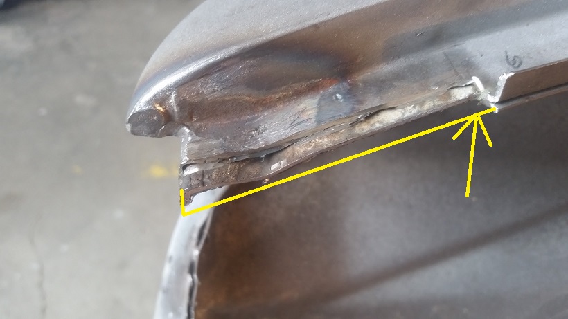

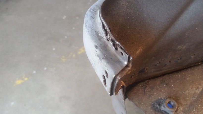

Here's a shot of the right side channel. Looks like I cut on the wrong side of the line. (IMG:style_emoticons/default/sad.gif)
All Clecoed in and ready to start welding.
