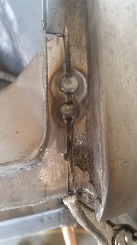

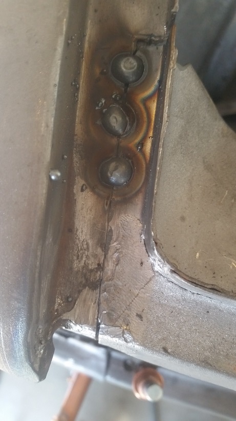

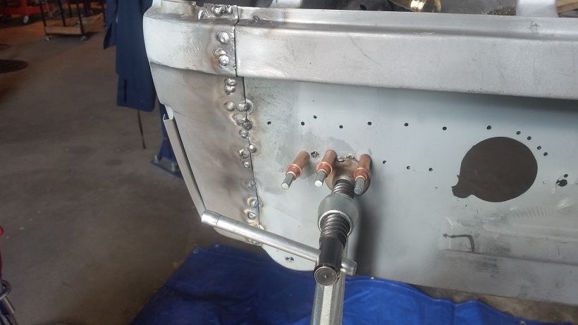

Now its time to fire up the electric glue gun ................
Right and Left side trunk channel tack in welds.
We did have to fire up the torch to remove that lead still on the tail light panel.

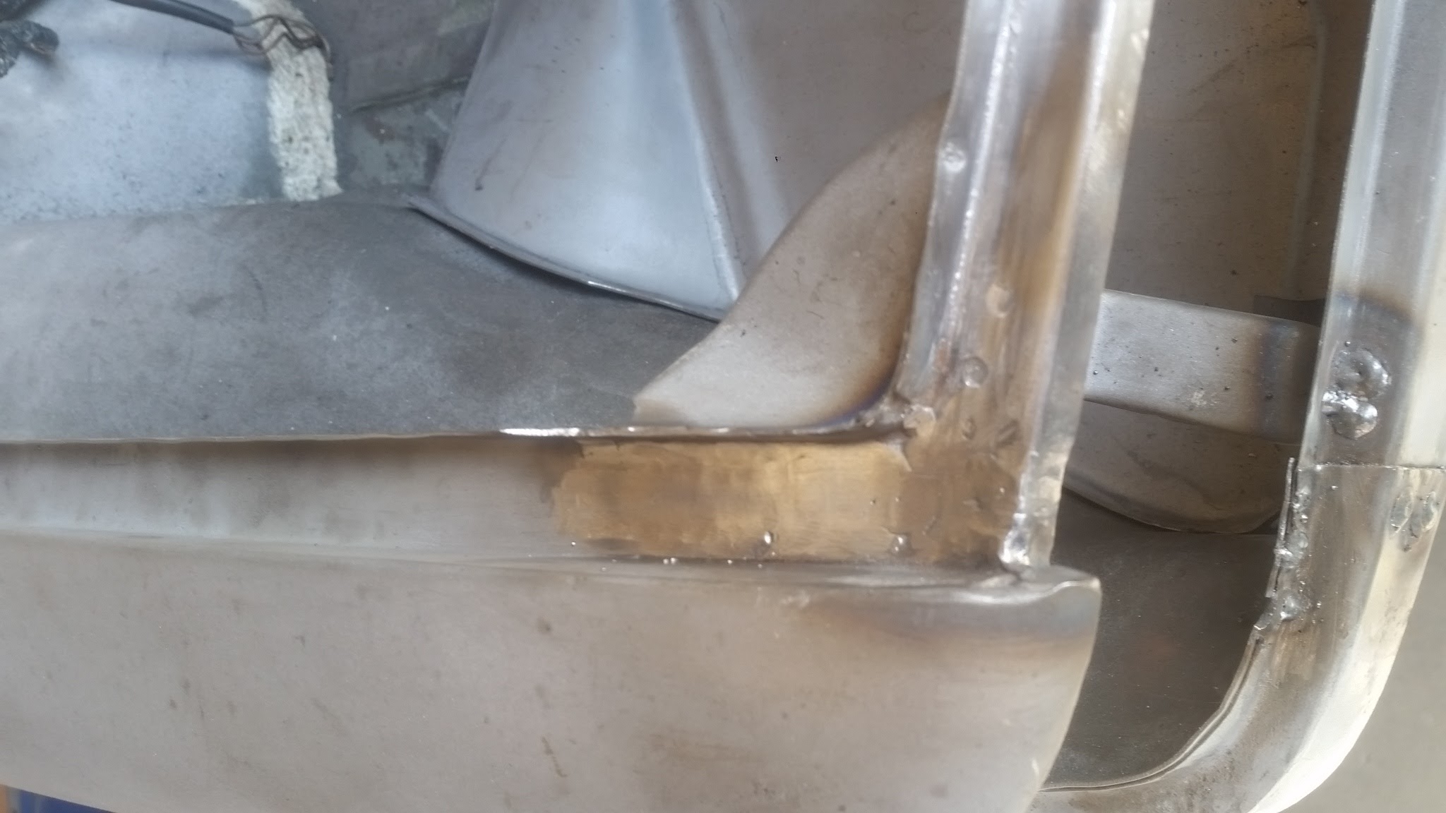

Blip, blip, blip ..........

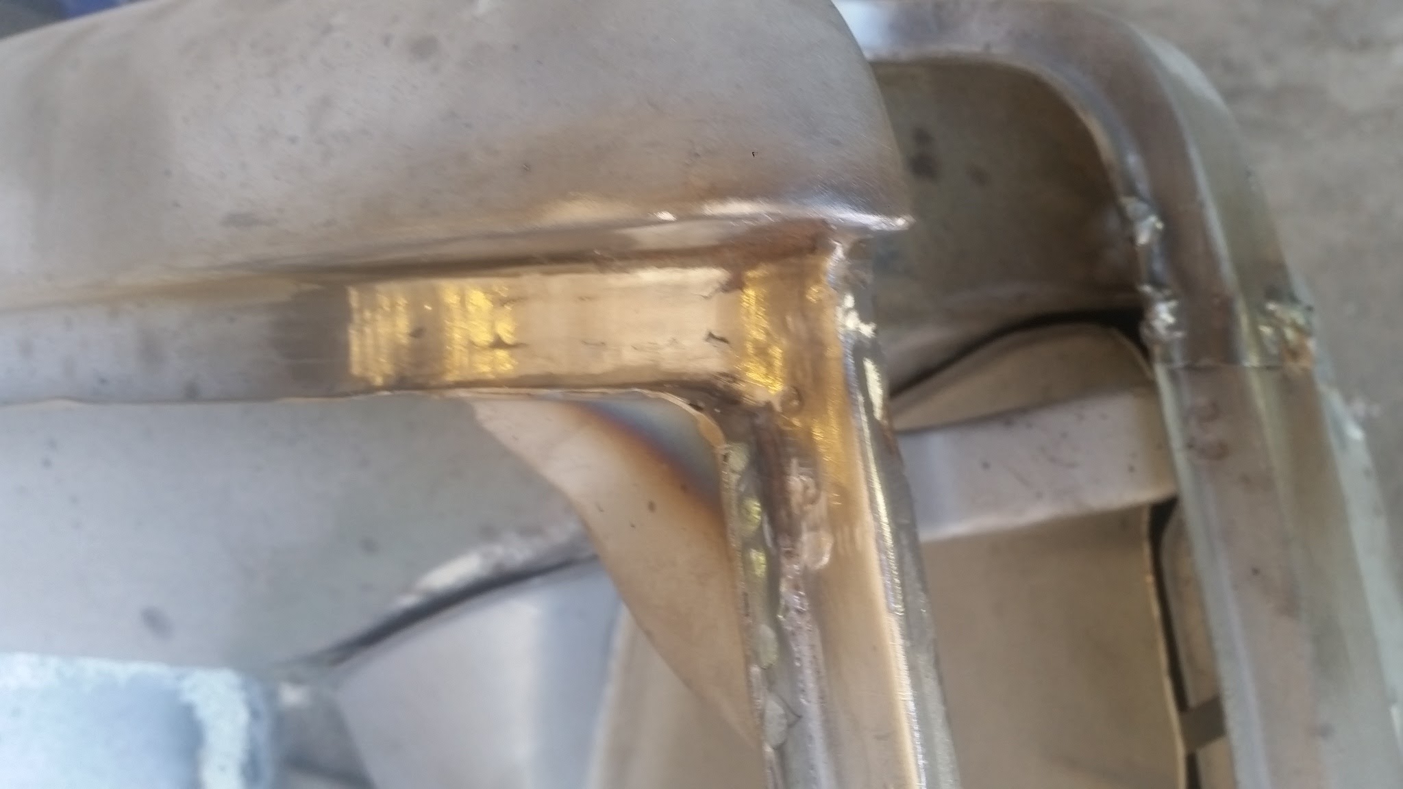

Trunk channels all ground down and ready for leading .........

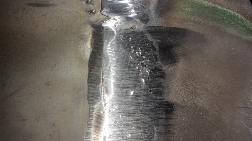

Here's a shot of one of the welds that has a little contamination from the seam sealer.
I'll come back and add a beauty shot. All finished ................
