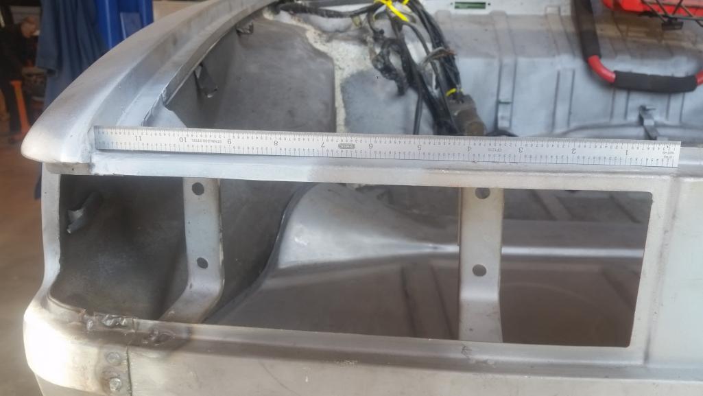

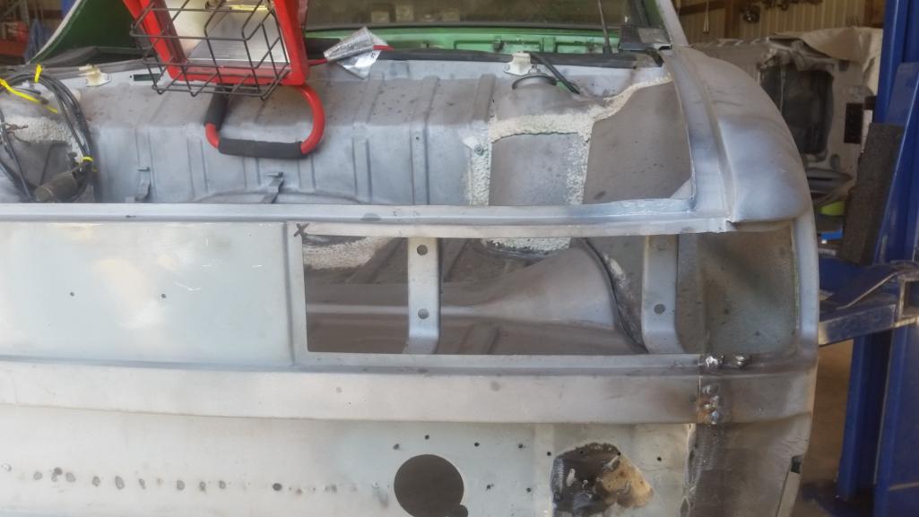

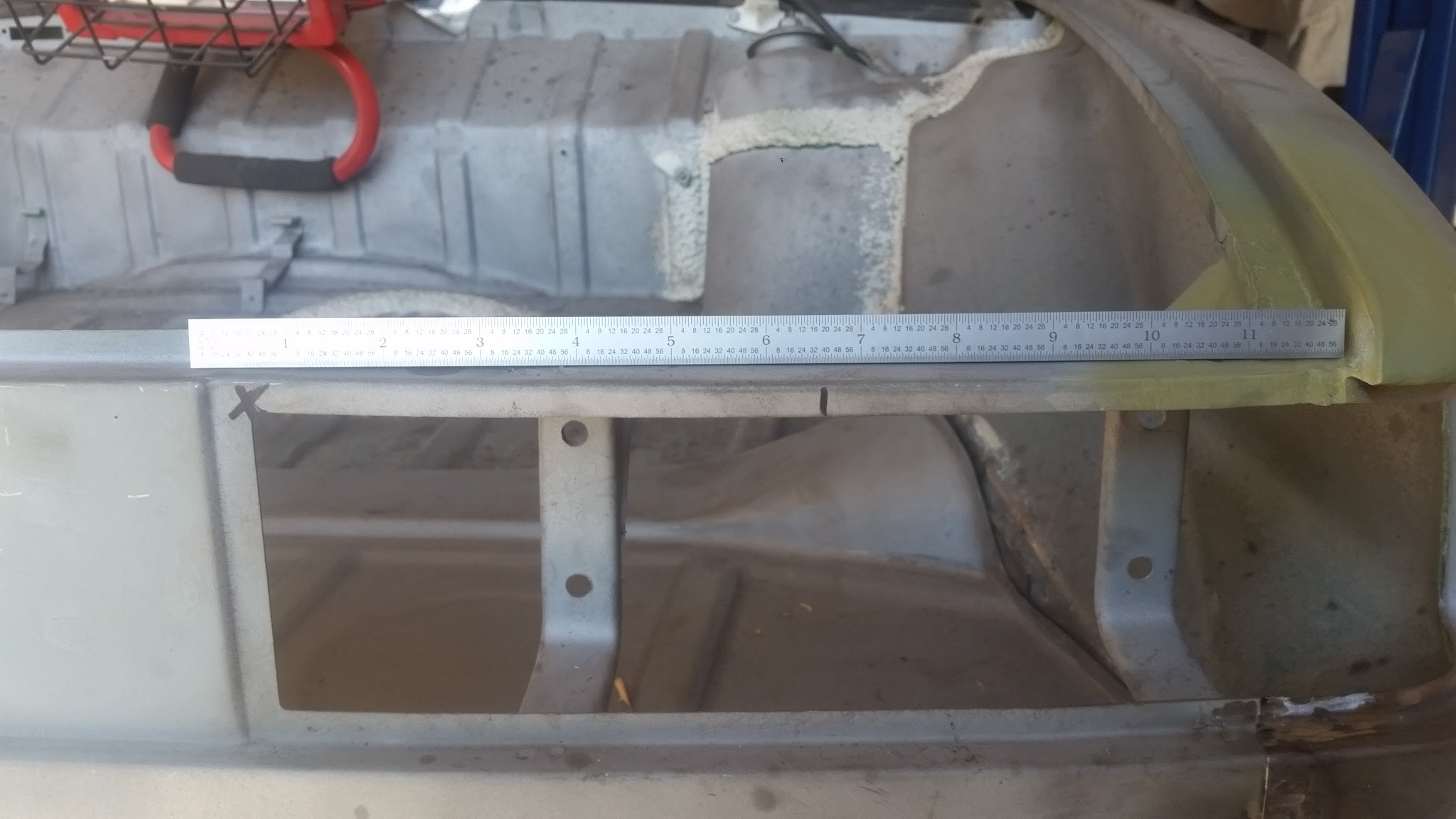

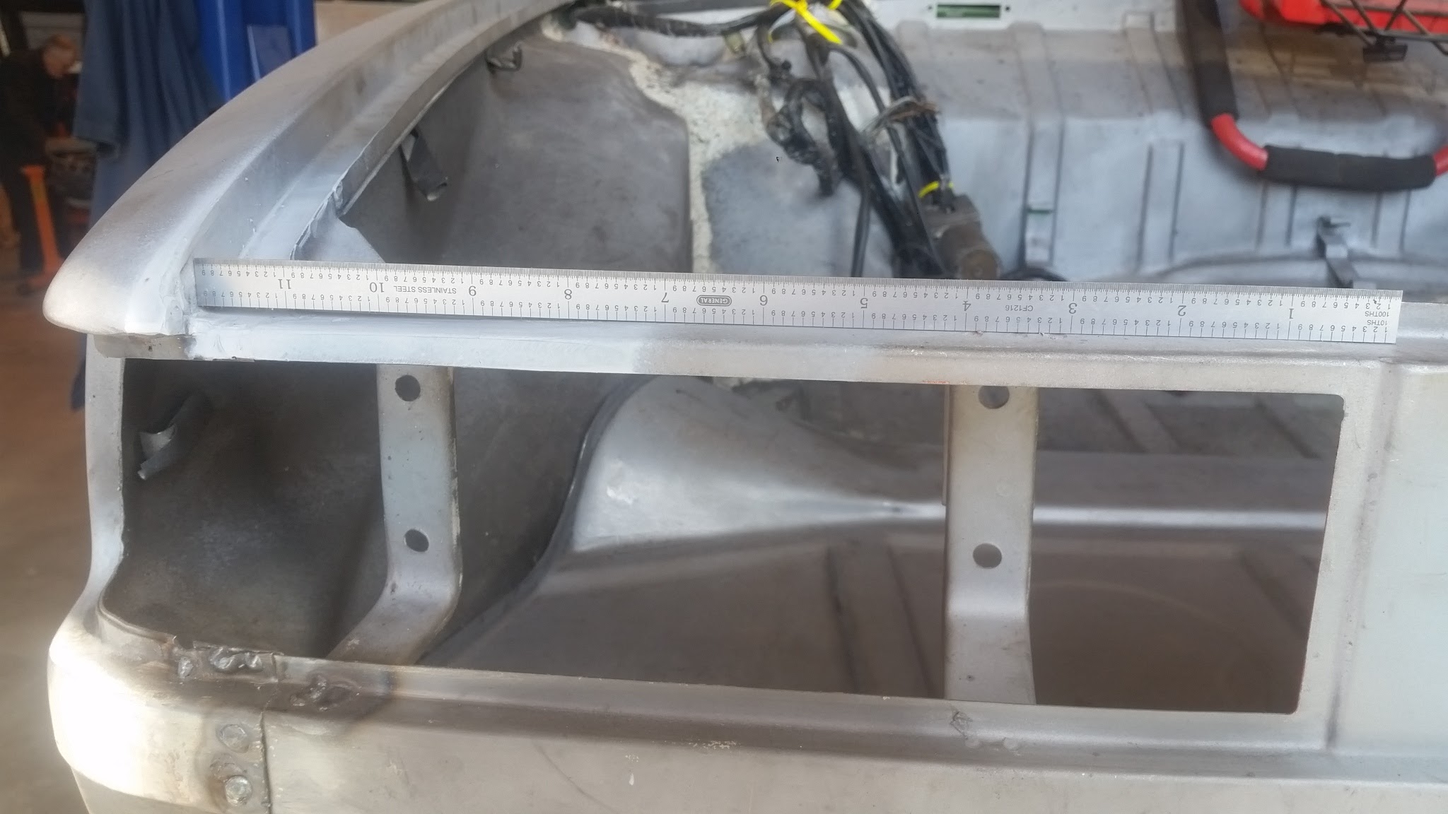

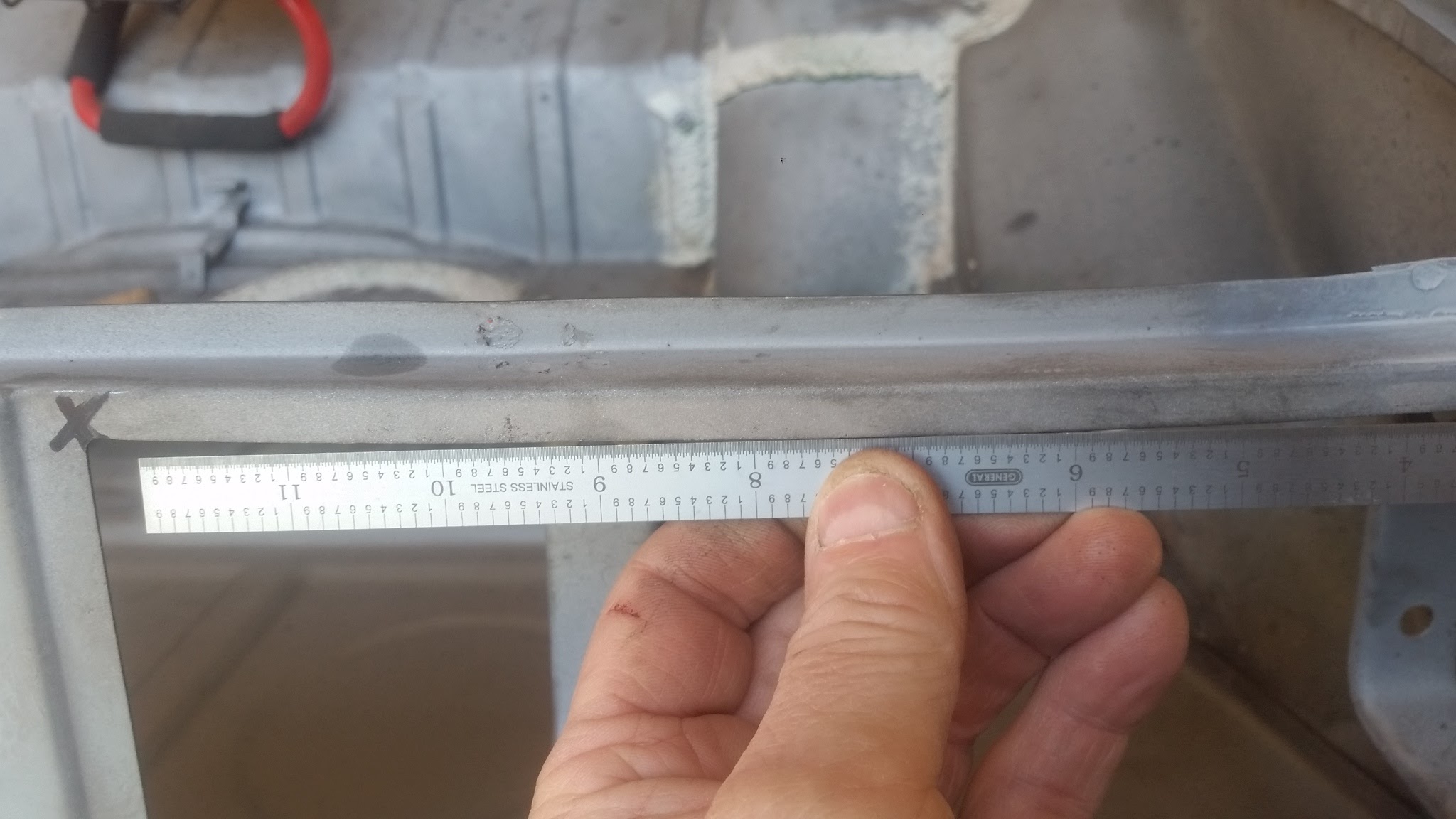

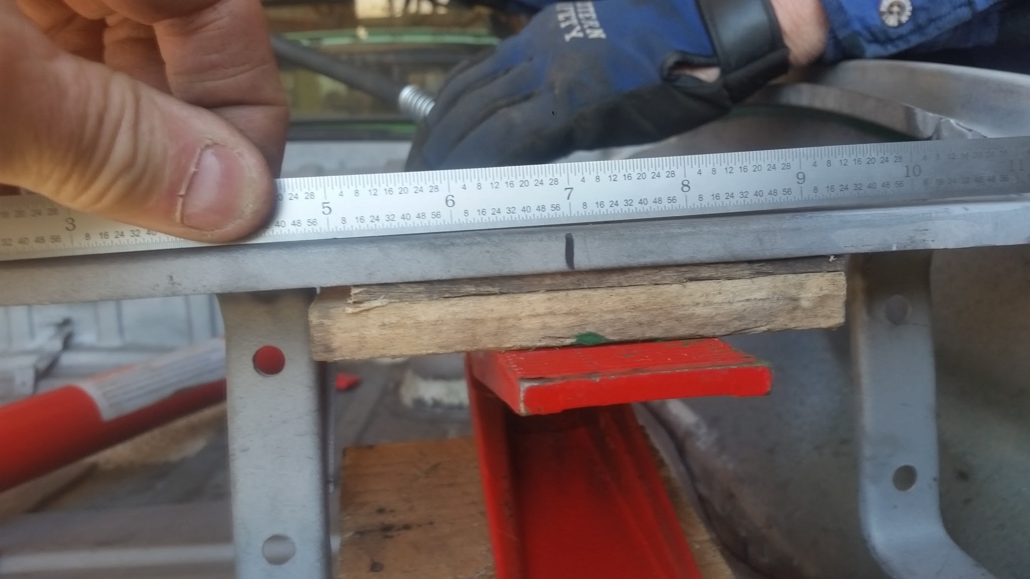

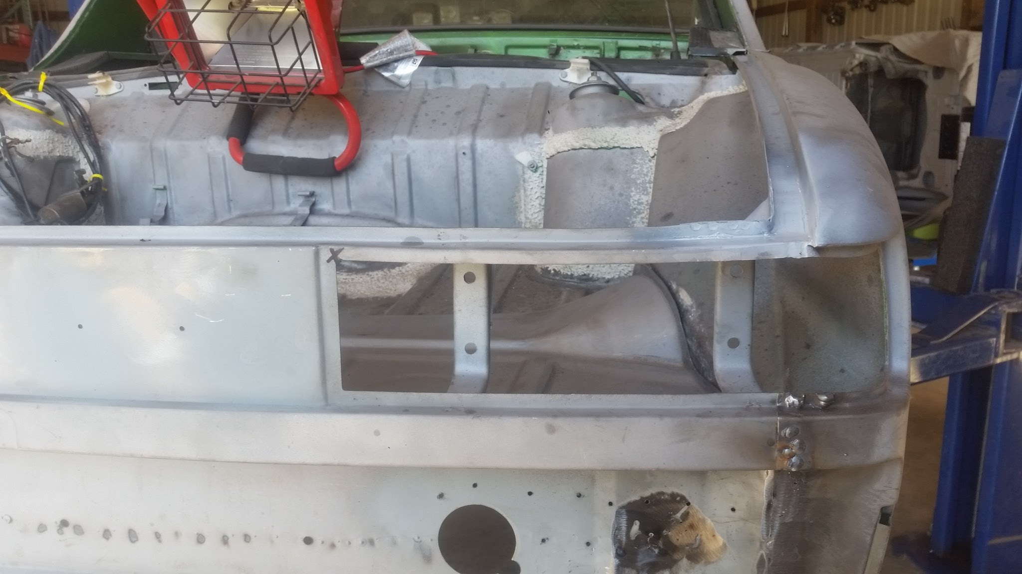

While welding I find another problem. The right side tail light frame is bent. (IMG:style_emoticons/default/sad.gif)
Left side ..............
After a little Tool Whore adjustment ............
