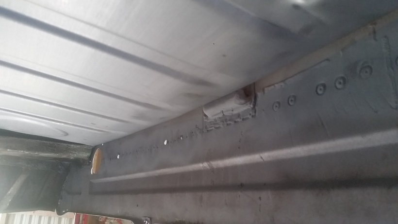

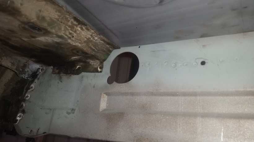

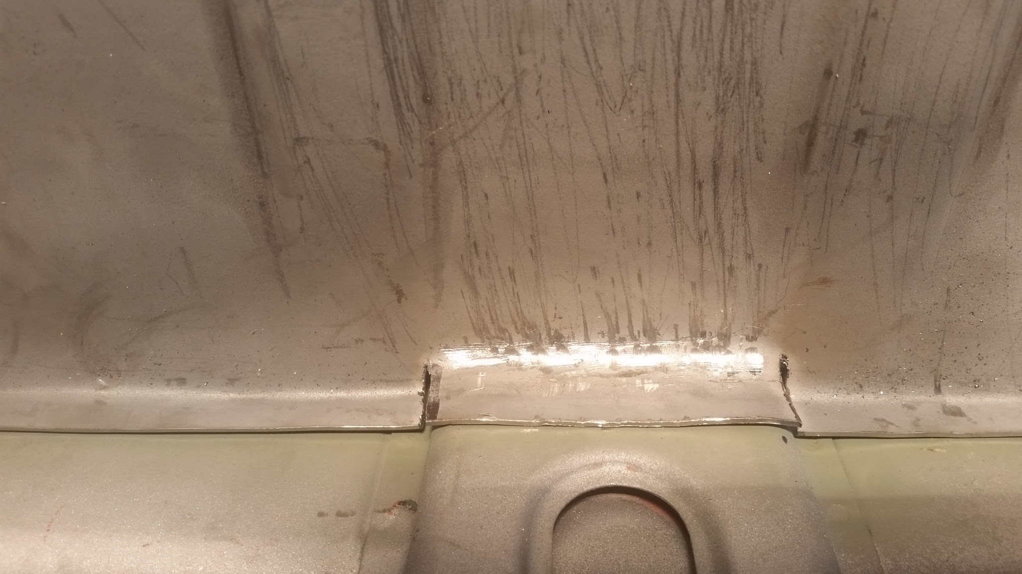

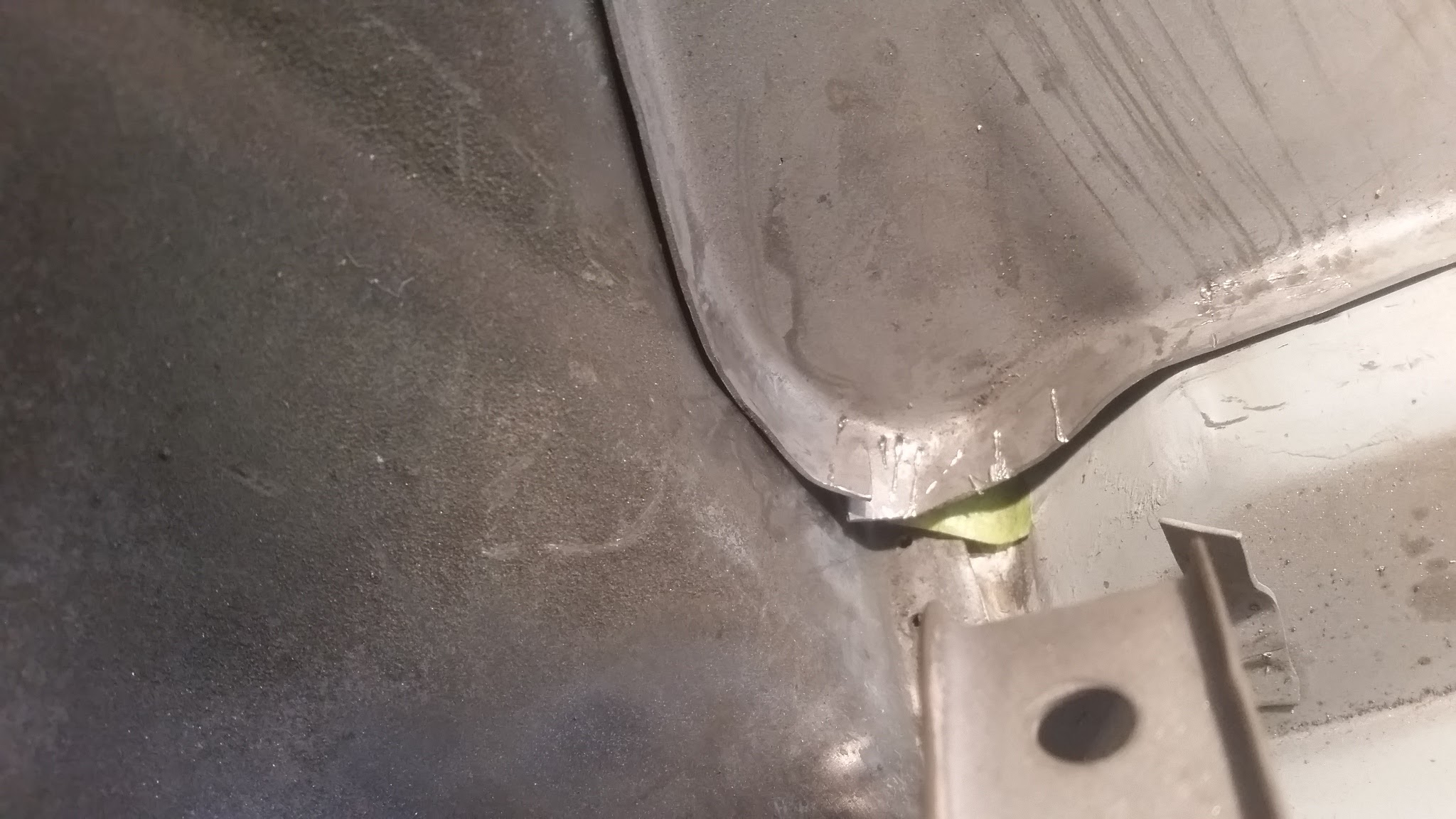

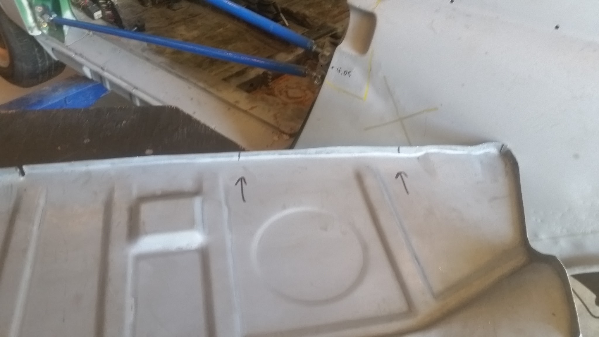

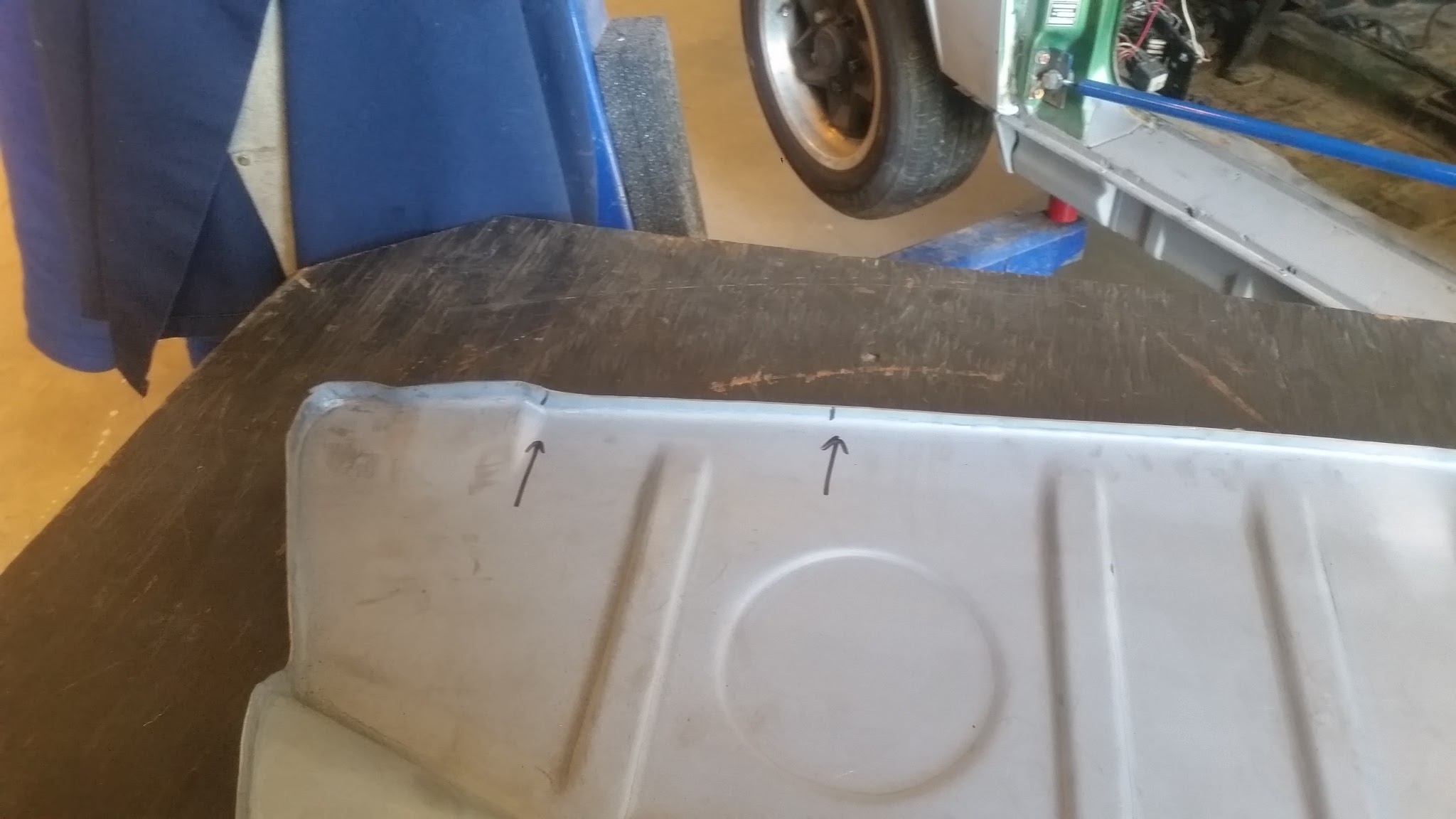

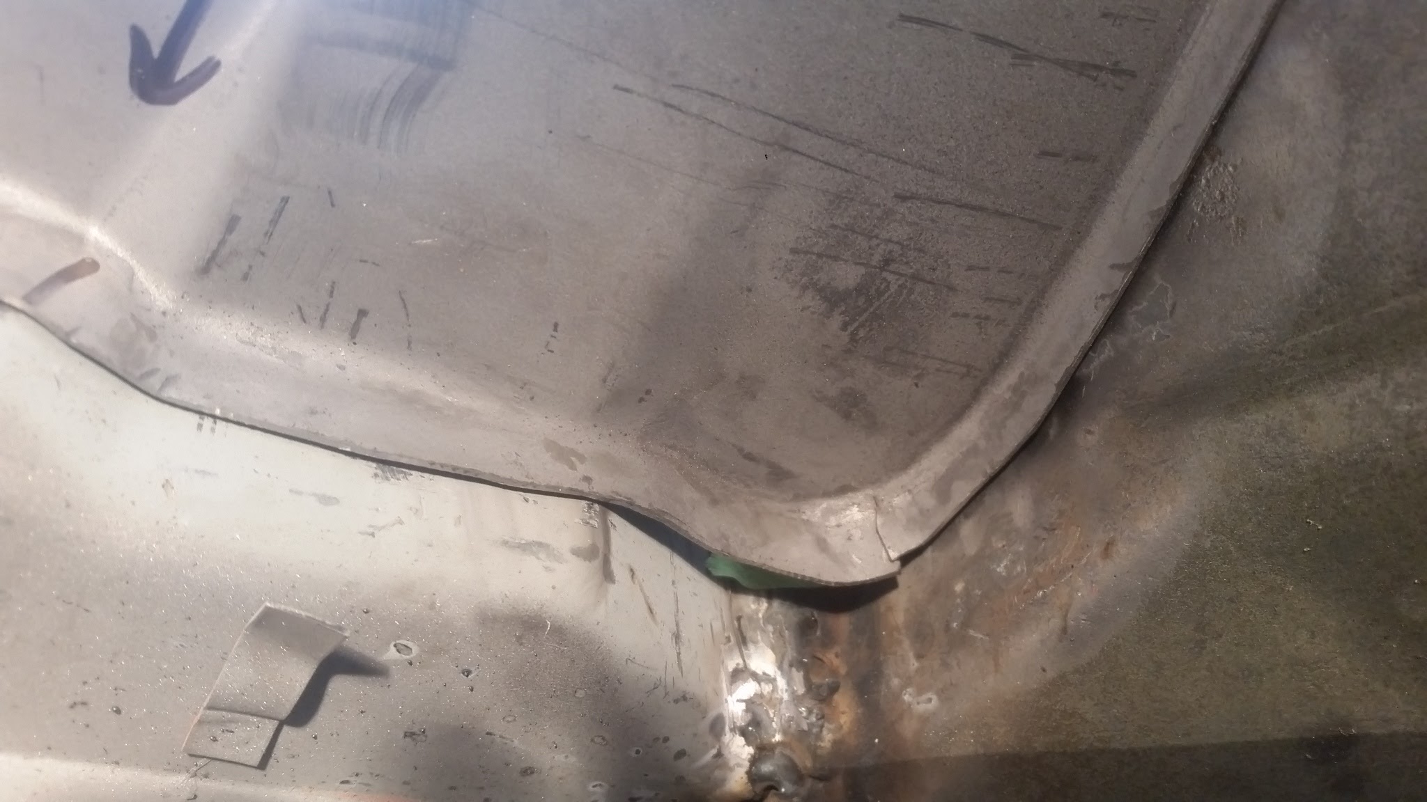

Now on to fitting the rear trunk panel. Looks like using the RD PP335 in a 75-76 will take some extensive fitting. I think that's how Adam from RD describes it.
First observation. With the impact bumper supports in play, the new trunk panel will be located quite a bit higher than either the pre 74 or the 75-76 position.
I'll needed to trim around the latch support and create a new flange.
Shot from above.
Back flange needs a little fitting.
This is what I would call extensive. The question is can I fold down the flanges to fill the void. Or will I need create a couple of new corners.
