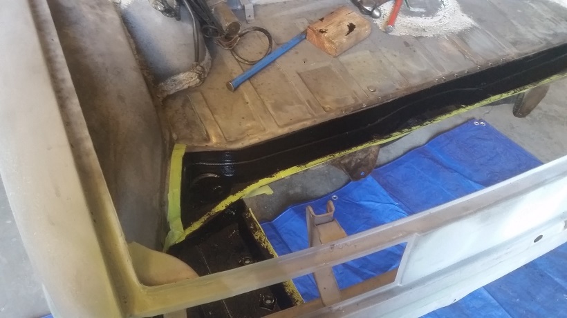

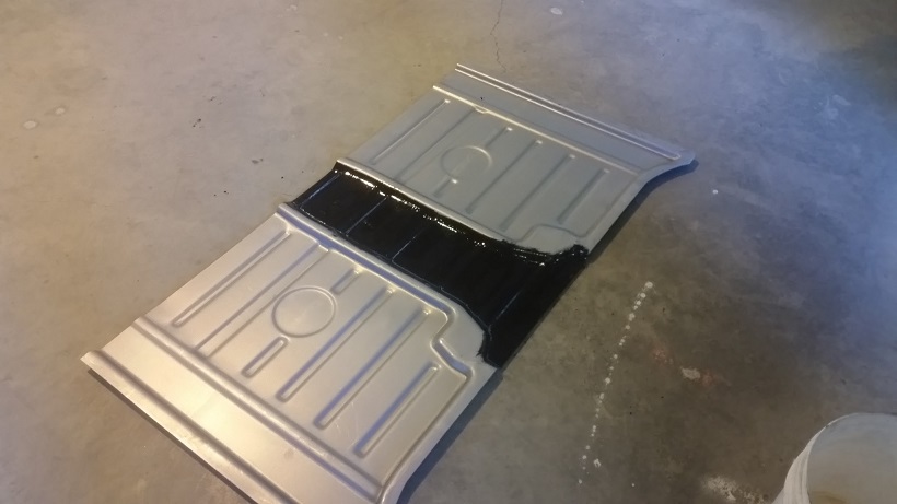

Before I head out the door I POR15 the transmission mount and impact bumper supports. As not to waste the POR15 I use the remaining POR15 to coat the inside of a few other pieces.
