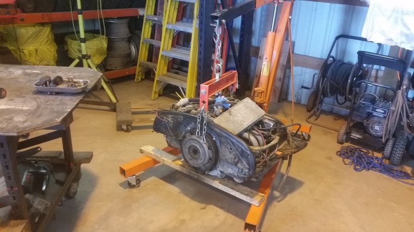

First task is to tidy things up after the paint stripping. Which included dropping the engine in order remove any residual media in the nooks and crannies. I was concerned with the rust prevention product that Dustless Blaster mixes with the glass media being left on and in the electrical connections. I'm a firm believer of an ounce of prevention is worth a pound of cure. I dribbled some OSPHO on a couple connectors in my white car. Not good. It ate the crap out the plating.
Here's Super In Law working on loosening up the media in order to blow it off. It will need to be steam cleaned.

As I was doing my thing, Super In Law broke down Mark's drive train.
It will get steam cleaned and new fuel and vacuum lines before it is mounted back into the car.
Mark I'll need a new pair of engine mounts. One was cooked, long stud spun inside the rubber mount. Other is looks original too.
