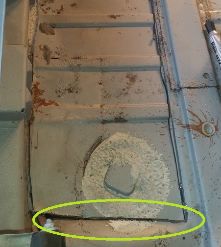

Cary, Great job , I think the rear trunk floor is gonna be an aesthetic regret...
check the photo of the OG floor it has a transition down to the proper trunk floor height... If you make a cut front to back ( like you previously did ) and push down the floor then fab some filler pieces it will be like it should for a BUB 914... Carry On
cary
post Mar 18 2016, 07:44 AM
Posts: 3,900
Joined: 26-January 04
From: Sherwood Oregon
Member No.: 1,608
QUOTE(sixnotfour @ Mar 18 2016, 04:36 AM) *
Hmmmmm ................
I'll pull up the pad in my 73 and take a look.

sixnotfour   Cary, Great job , I think the rear trunk floor is ...   Mar 18 2016, 05:36 AM
cary   Cary, Great job , I think the rear trunk floor is...   Mar 18 2016, 07:44 AM
914werke   BTDT on the R. trunk floor repair for the late BUB...   Mar 18 2016, 07:31 AM
sixnotfour   Cary,your 73 should look like the RD panel..75-76 ...   Mar 18 2016, 12:28 PM

cary   You guys are making more work for me ... LOL It ha...   Mar 18 2016, 02:09 PM
