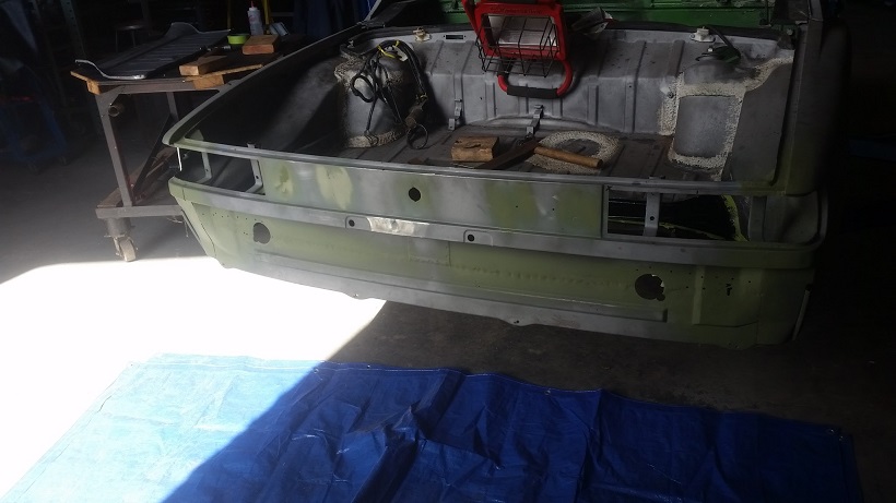

cary
post Mar 18 2016, 06:40 PM
Posts: 3,900
Joined: 26-January 04
From: Sherwood Oregon
Member No.: 1,608
Here's the shot I forgot last night.
