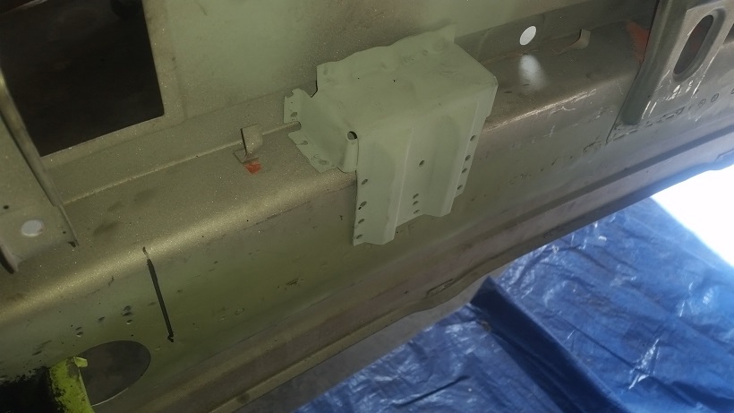

I've been asked by Mark to do some sheet metal/body work on his 75 2.0 Liter project car. The car arrived last Monday. But I needed to finish up a couple things on my project car and in my shop first. But I dove in this afternoon.
First task is to tidy things up after the paint stripping. Which included dropping the engine in order remove any residual media in the nooks and crannies. I was concerned with the rust prevention product that Dustless Blaster mixes with the glass media being left on and in the electrical connections. I'm a firm believer of an ounce of prevention is worth a pound of cure. I dribbled some OSPHO on a couple connectors in my white car. Not good. It ate the crap out the plating.
Here's Super In Law working on loosening up the media in order to blow it off. It will need to be steam cleaned.

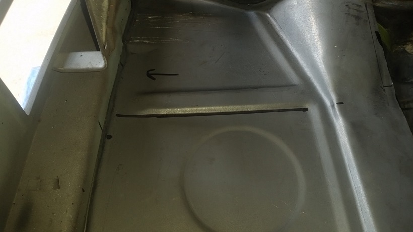

Modifying RD PP335 to replicate the 75-76 rear trunk :
After this mornings input we have a plan to replicate the 75-76 trunk the best we can. Thanks, sixnotfour.
I don't think it will be that tough.
First issue is locating and welding in the 75-76 tail light panel braces. I forgot about them until I was scrolling thru my picture file this am. They were in the back of one of the trays on my parts rack.

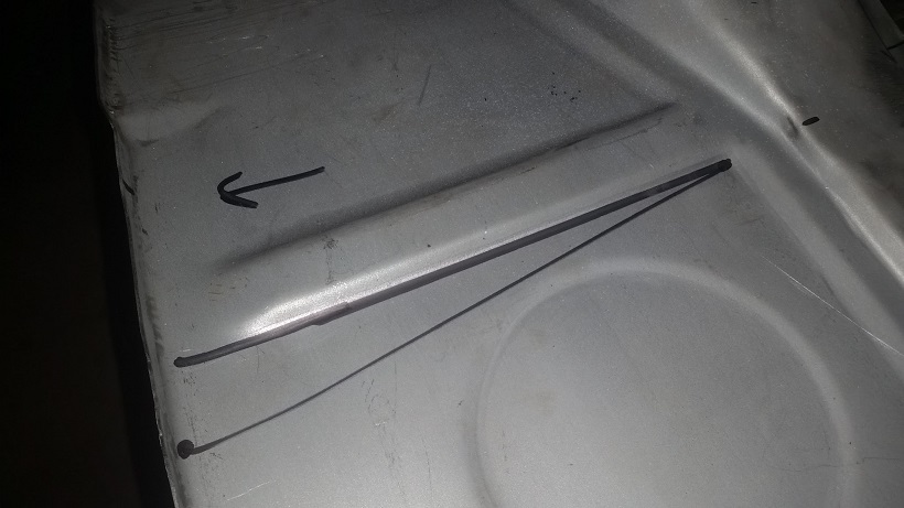

Now for creating the drop down portion of the trunk. I decided to clean up the 75-76 portions that I cut out during the cut out of the old trunk. I decided that anything I keep for patterns and fitting will be painted my signature Ford blue.
#1. I'll make a cut at the base of the rib. Not exactly the right location compared to the samples. But it will look real sanitary. Down the black line, plus thru the flange.
After making both these cuts I'll be able to bend the panel down into the correct location. There's about 100 (IMG:style_emoticons/default/biggrin.gif) spot welds to use as for alignment.
#2. Once I have the panel in position I think I'll end up with the area in the triangle to cut out. This piece will be fabricated to replicate the 75-76 sloped area.
Looking at sixnotfour's picture I may run the other long line right against the hole plug area.

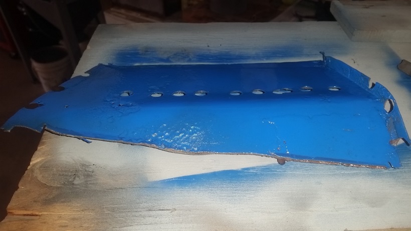

cary   Start the day with primering the refurbished piece...   Mar 3 2016, 11:54 PM
cary   Today's items sent to the refurbish workbench....   Mar 4 2016, 12:09 AM
