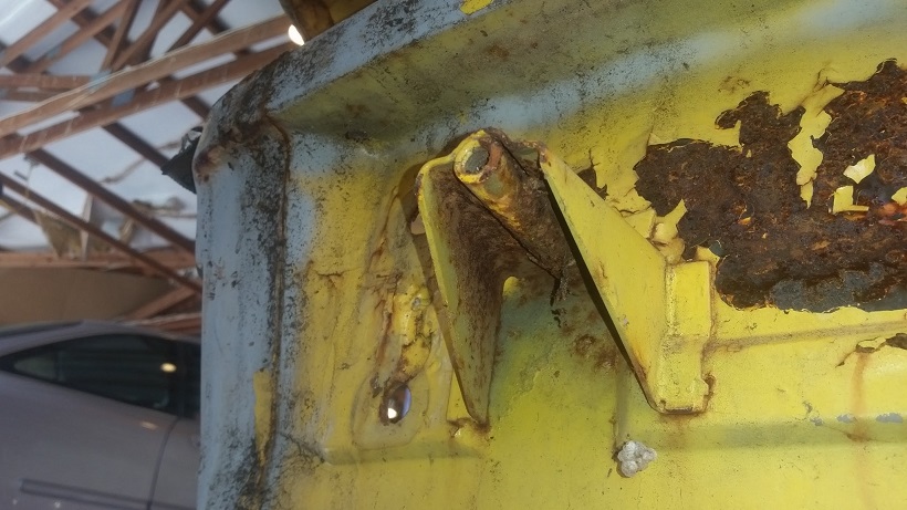

Needing more research :
A few rust pits on the upper right outer wheelhouse long
But we also a have fairly good sized rust spot a little further up the upper long. Right next to the suspension console.
These are both in the double walled section of the upper long.

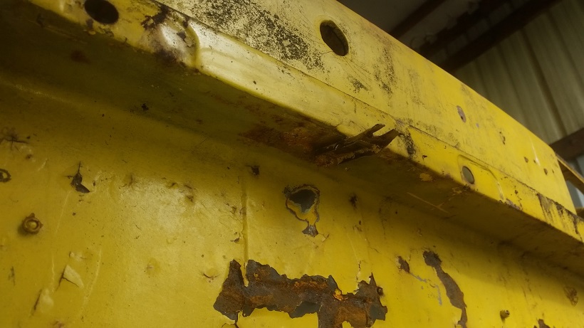

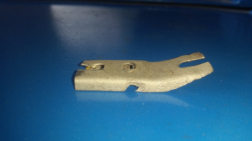

Ken looks like we can create you a tow hook by using the back (with tube
attached) from my parts car. And the front side from Mark's new tail light panel.
I used the plasma cutter to cut it out of the parts car.
It's your lucky day ............ the hanger tab was still under the 75-76 bumper that was hanging on the parts car.
