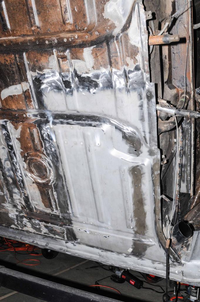

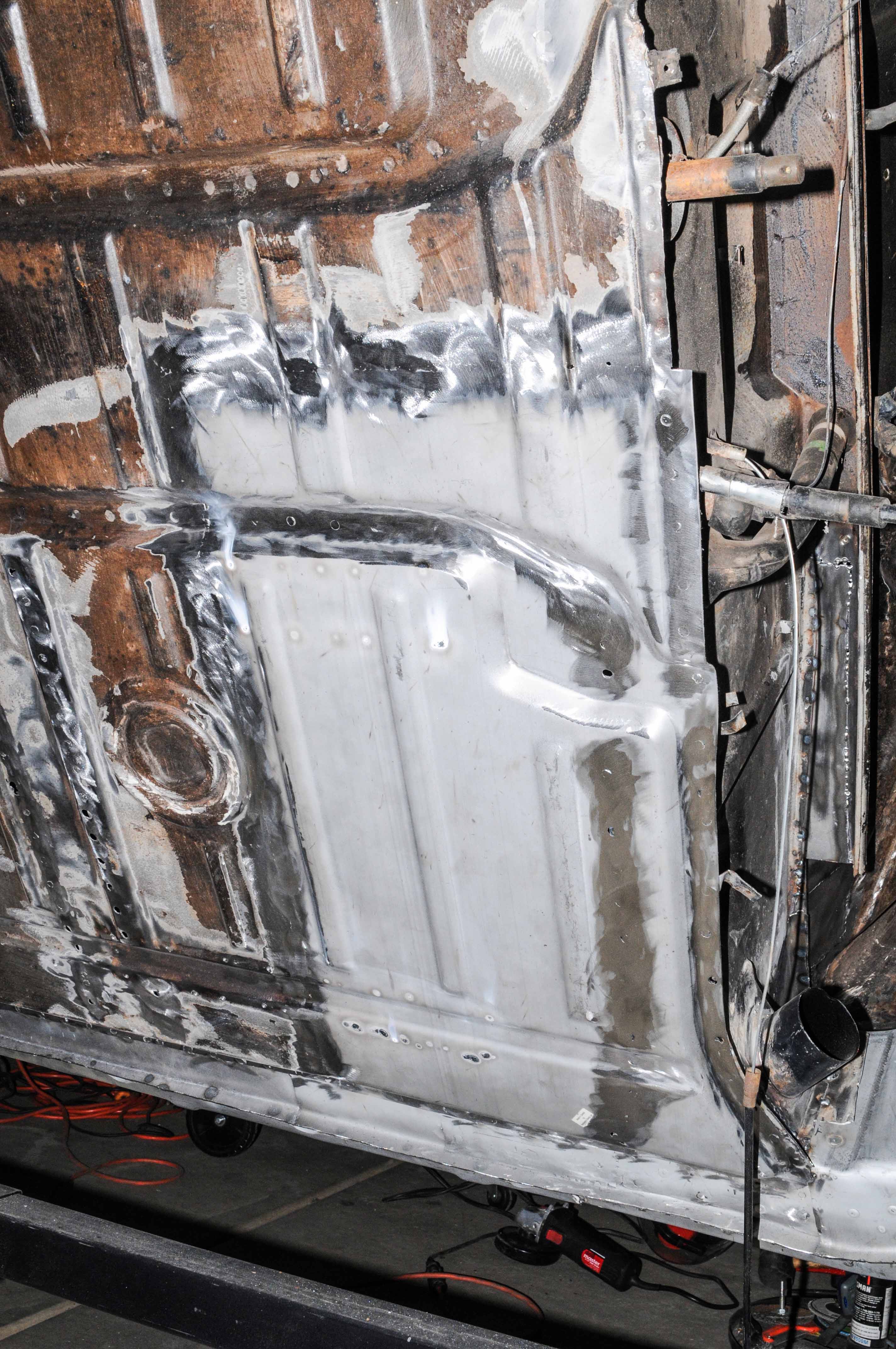

The story begins 2 weeks ago... I spent that Saturday grinding the welds that hold the new floor section in, and it went wonderfully. So I decided to weld the seat mounts in, which worked out well too. I then decided the next logical step was to weld in the little reinforcement plate underneath. It was now Sunday and I had been in the garage for about 20 minutes fitting the piece in place when I noticed a completely separate area could use some grinding... 2 seconds into grinding my bad shoulder gave out causing me to drop the grinder which caught my finger on the way down, taking an enormous chunk of it with it. Over an hour later I still couldn't get the bleeding to stop so we went to the ER where they had to cauterize the wound since there was no flesh to stitch.

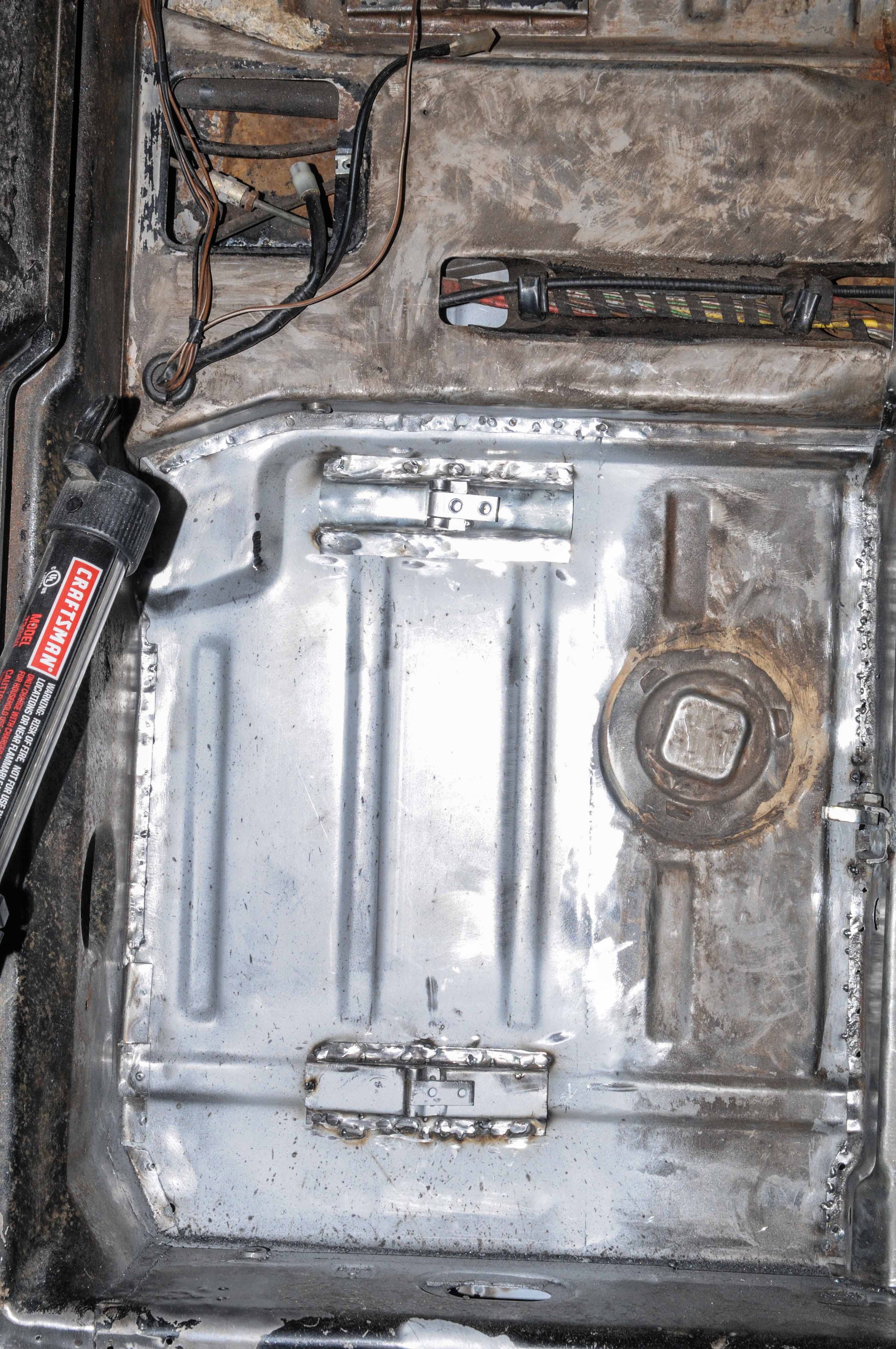

DirtyCossack   This weekend's goal was to tack the floor sect...   Feb 28 2016, 07:58 PM
DirtyCossack   But the big event of the weekend was getting the f...   Feb 28 2016, 08:02 PM
DirtyCossack   The story begins 2 weeks ago... I spent that Satur...   Mar 20 2016, 01:21 PM
