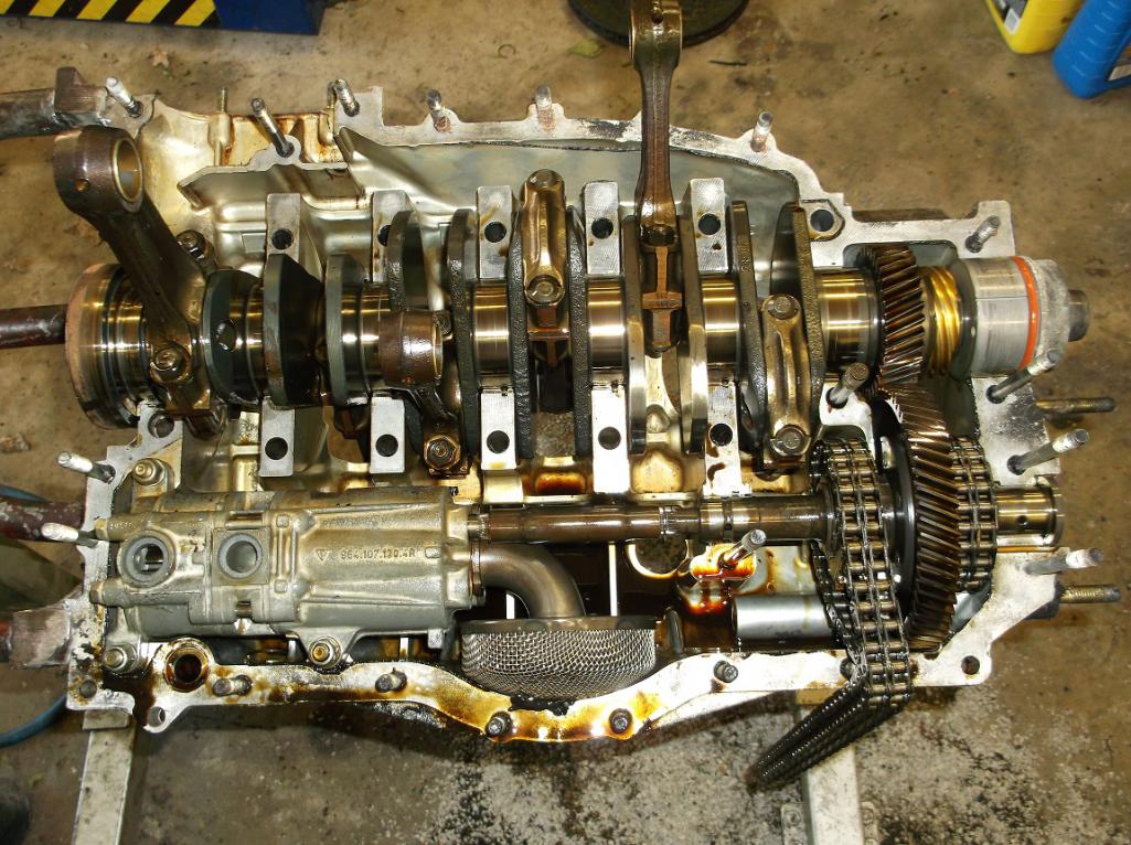

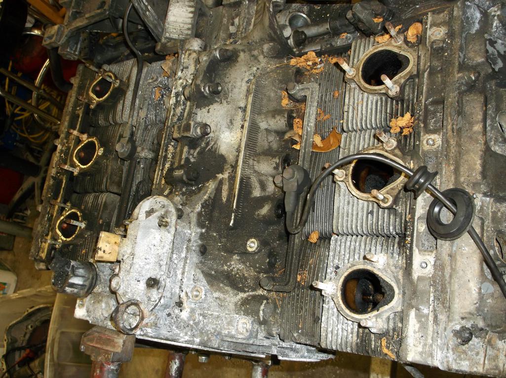

The weekend progress:

QUOTE(ClayPerrine @ Mar 20 2016, 08:40 PM) *
Ugly on the outside but beautiful inside! (IMG:style_emoticons/default/biggrin.gif)

QUOTE(billh1963 @ Mar 20 2016, 07:42 PM) *

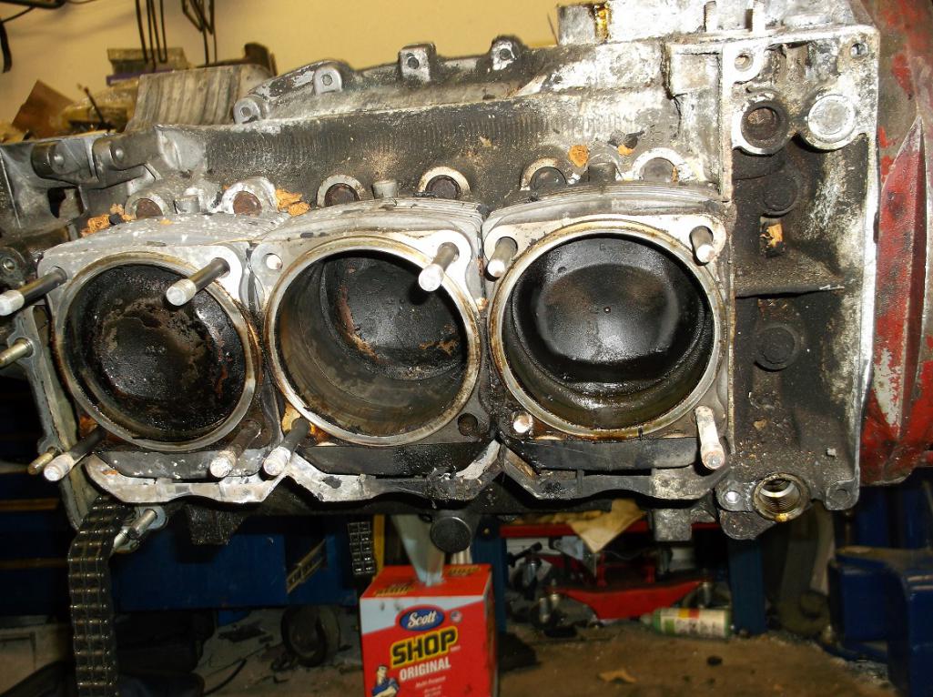

It was a tiptronic car. The owner drove it gently and did regular oil changes. So it makes for a great core motor.
Anyone need some stock 964 pistons, cylinders and rods? I have them cheap... (IMG:style_emoticons/default/biggrin.gif)
