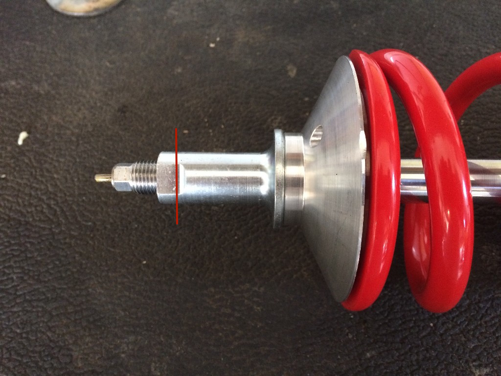

This is where the stupid question comes in: Are there different threaded collars (bushings) for Bilstein and Koni? Look at these pictures: First one is the threaded collar, screwed all the way down on the Bilstein as it's supposed to - and the rubber bushing goes over it. The second one is as far as the collar will go...which is not at all because the thread pitch on the Koni is different!! Do I need a special threaded collar for Konis? Did they not send me something I should have? Suspension is something I've honestly never messed with...

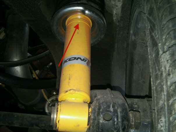

There should be a clip under the lower spring mount you can move down.
IIRC, on Andy's car we removed just a bit of the threaded collar so the nut would go on a little farther. Just enough for the nylock to engage. The line in the picture is arbitrary, measure how much thread you need showing and only remove that much. Also, you can use the weight of the car to make starting the nut easier. Bit of a PITA to put the wheel back on and lower everything, but it makes the job easier, so it's worth doing.
