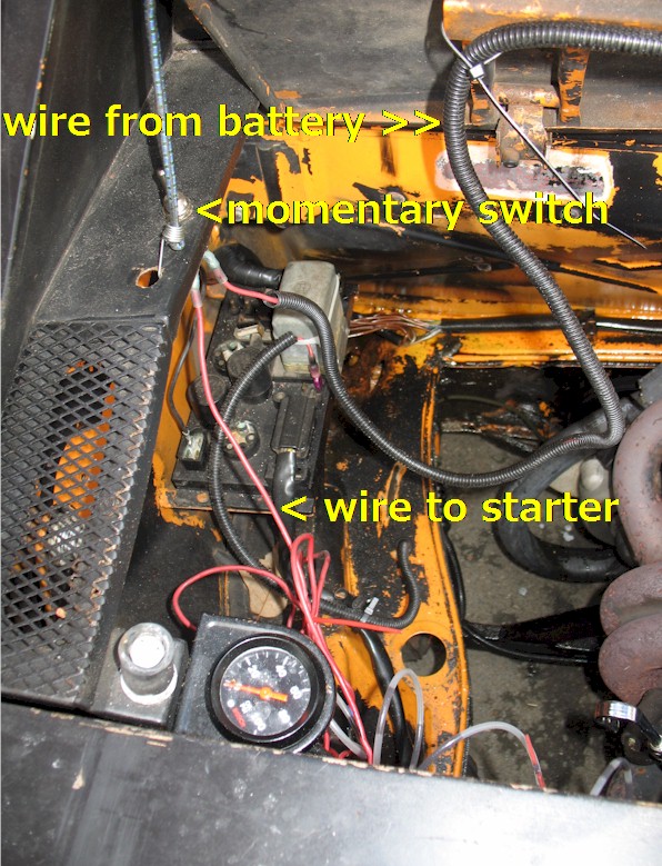

that aside, i put a bosch relay near my starter, one problem i have is from driving in bad weather, is corrosion on the terminals.
i've installed a wire from battery to a momentary switch and the end terminal is near starter, and when my car won't start, i pull the ignition wire to starter and install the wire from my half assed momentary switch and it starts fine. meaning the starter turned engine and car starts. i should wire this switch to my dash as an always available back up.
when my wires are wet and corroded, starter does not turn at all. i hate rainy salty days : (
