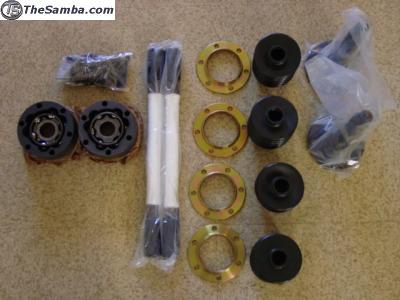

what do you make of this kit?
its made for a VW but I wonder if it could be modified or custom made to work with a 901?
http://thesamba.com/vw/classifieds/detail....l.php?id=106550
